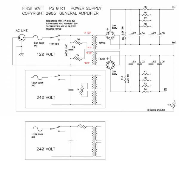

Ive attached a schematic of my proposed wiring for the PSU.
Attachment is the original posted in this thread, in the bottom third is the wiring I think is correct for a 240v single primary 2 secondary transformer. Ive looked through lots of threads but cant find a definitive answer to this exact arrangement.
So can I have peoples opinions on this proposed wiring? Thanks

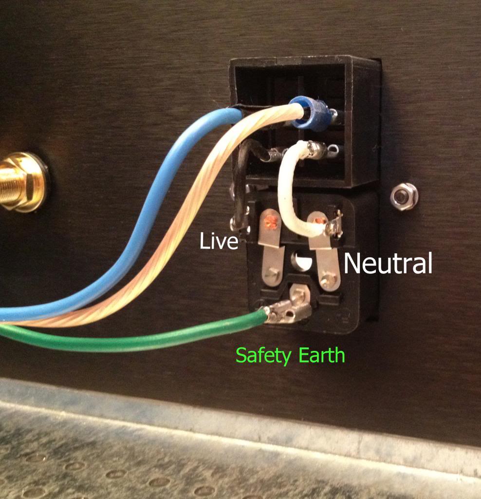

Hello All,
I'm still in the process of acquiring all the parts for my Aleph J build project, and just recently received my order of the 4U back panel kit. In the mean time I've been watching the build thread and reading and re-reading the build guide when I came across the wiring pic of the power switch/fuse holder unit. In the build pic the jumper wires show that the line and neutral are wired to fuse both leads (the fuse block has a space for a line & neutral fuse). This would require a fuse for the neutral wire as well, when normally it would only be fused on the line side. Am I missing something in the build notes? If it is to be wired this way what value of fuse is installed on the neutral wire?

Yes, wire it as shown. Those connections attach the IEC portion to the switch.
The fuse holder is integral to the IEC plug, so you can't defeat the fuse by sipping the switch on the neutral.
Jumper the neutral fuse if you want or make the fuse value double, to essentially make it a wire.
MAKE SURE you have only the hot fused if you use a single fuse.
