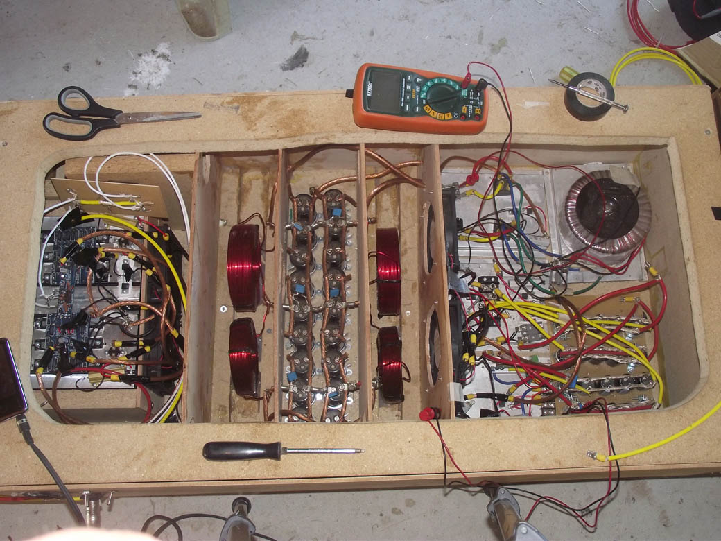

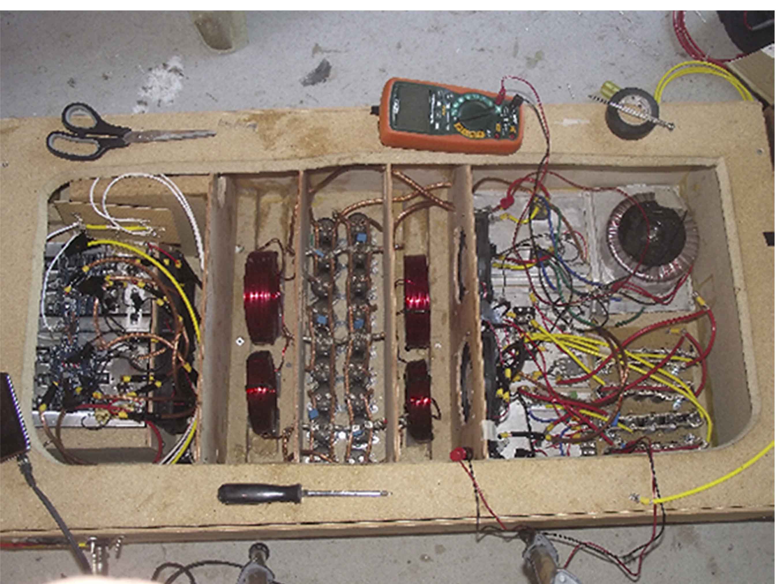

Picture of my 1of2 mono amp, not working yet
I understand that peple want to see what my amps look like, I am having trouble making a photo that I can load into this forum, I have Photoshop but have not been able to make a smaller data size image without loss of to much detail or size, I am open to any ideas of how to create a better image for you.

better pickture 1of2 mono Aleph J-X, not working yet
Hi everyone,
This is a clearer photo of my amp, I will try to creat many better photos, my amps have alot of AC processing before it gets to the transformer: 2 AC lines DC filter, soft start, thermal shutdown, 4 AC fan controlers, I ahve bypassed all of the AC line circuits untill I can get the amp working without them.

this photo is better of my current Aleph J-X, not working
I believe this should be a much better photo of 1of2 mono amps.
I will try to get some more close up photos so you can see what I am working with.

Aleph J-X amp layout options
I did not plan to assemble the amp like I did, the heat sinks I am using do not require any fans but I have used four of them just for the layout of the wood box, I will put the amp in a metal box when I have them working so I know prcisely what I am dealing with, then again I will probibly never build metal boxs once the amps are working properly because I have the 2 ballanced DA converters to build next, one for each channel to take advantage of the ballanced Aleph J-X .
Ian
Hi,quick look at that photo and my impression was that you does everything as it isn't supposed to be done
