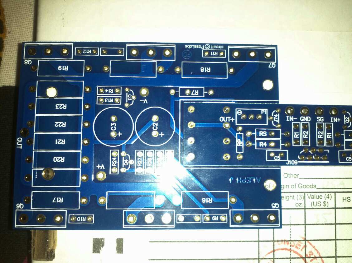

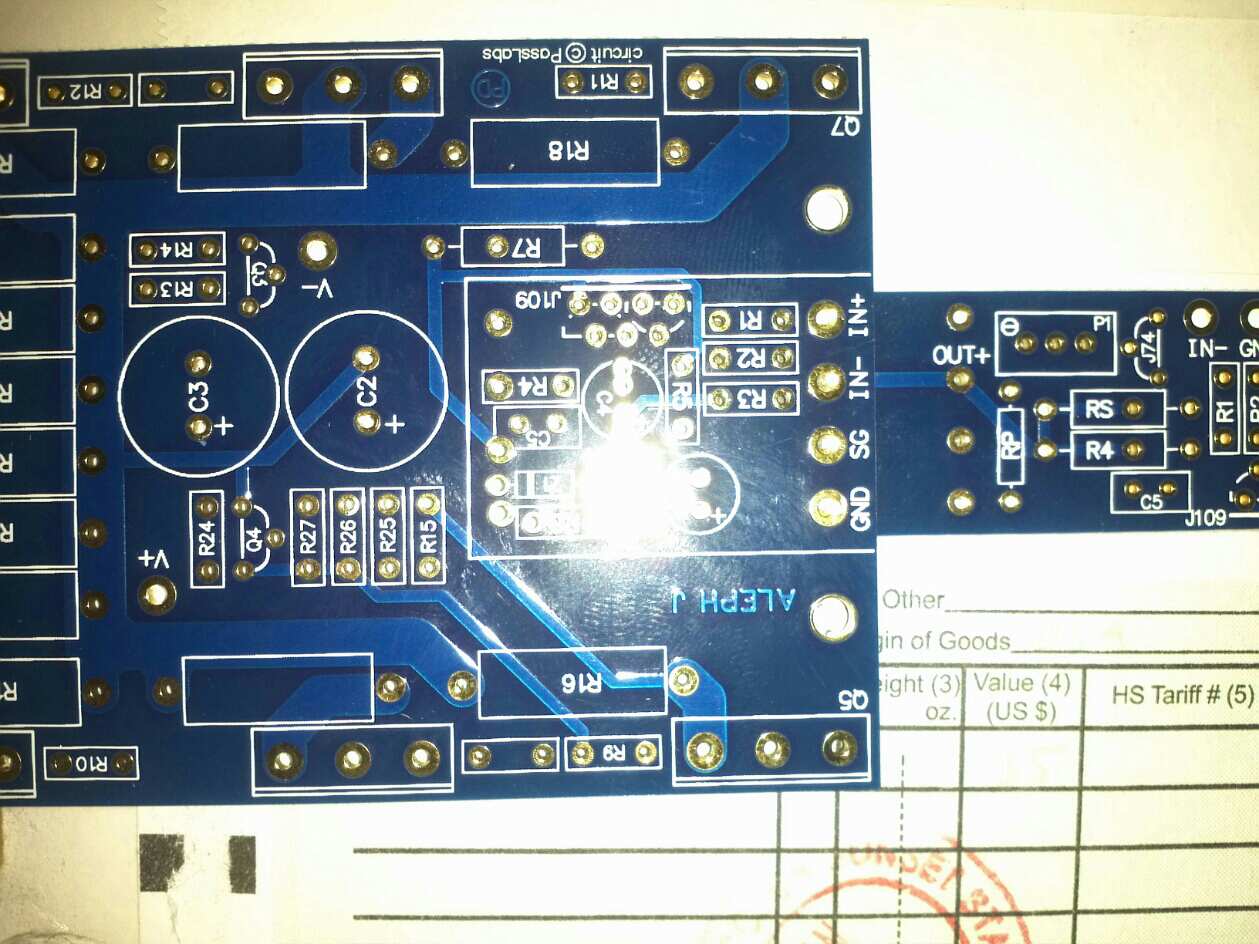

One thing that eludes me is how do I power JX.
The daughter board doesn't have any inputs from the PSU while the two output boards have their individual +-V supply.
So do I power both the output boards and wait for some magic 😀
both main boards need to be connected to PSU
daughter board will have power delivered by Divine Force itself
:rofl:
Divine indeed 😱..I was thinking about connecting as per pic2 (in+ in- holes on o/p boards to daughter boards) while it should be connected as as per pic 1
1 more JX for dummies question pls, two leads of RG, where does each end go 😀 (I was thinking spk terminal & star ground .. i know I'm a hazard 😀)
