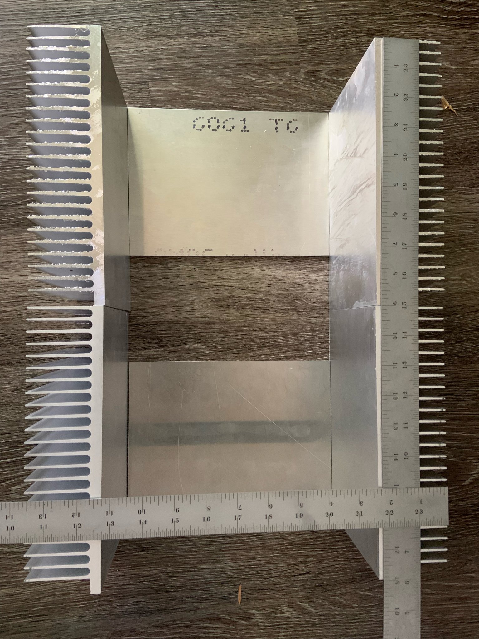

Can you stack them vertically?
always better to line them to "deep"
this is a bit to big,
with 6" high, now you're good for 80W of heat per side
Do not recall, possibly Thermalloy.Where are the heat sinks from?

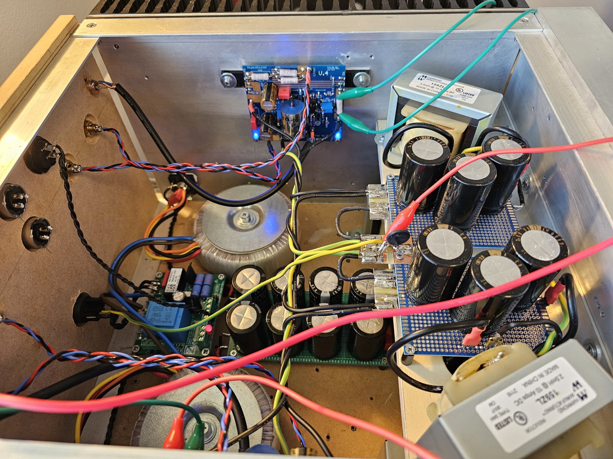

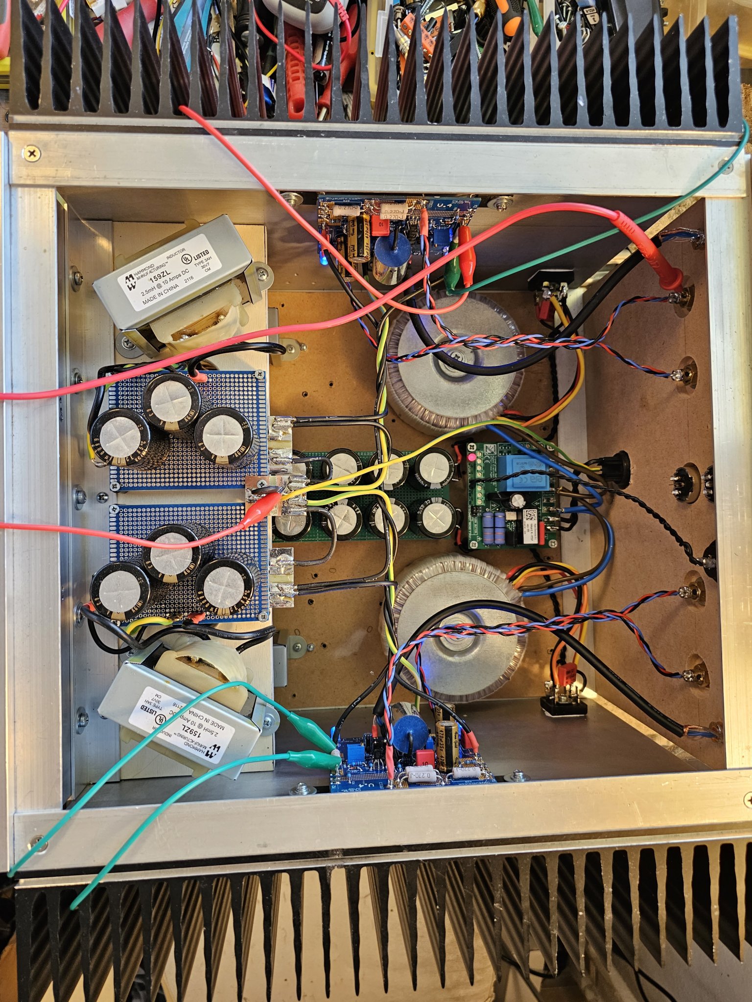

So,Jzm final setings.Everything looks OK.Iv build this in my test aleph enclosure with big heatsinks(36×26×6,5cm)and using my psu from my F6 amp in CLCLC configuration.I will try to make the final bias today and than over weekend I will put the amp in my main hifi system.Till now everything looks OK.😉
So guys,I have now about 50 hours of playing music thru the Jzm amp and let say just this ,that this amp sound amazing.I have at home F5 and F6 for comparision.So for me in my system is just better than F5 becouse it hase more meat in mid and bass frequency.Against F6 it have a little les warm mid tone but it hase better bass control and is more transparent.And like always by all Pass design this amp is so musical.I must say thank you again to papa but special thanks goes to Zen mod to offer his time and to designed this version,I must say Im pretty impresed and boys I think everybody that can do a little bit of electronic diy with soldering and so on,just take your time and put it in building this amp,is truly something special.It cost me about 450 usd becouse I have already the enclosure,but if we say that everyone of diy intusiast can build this for about 1000usd,is a bargain in this crazy hifi world where the prices go crazy in last 10 years for series products from hifi companys.
