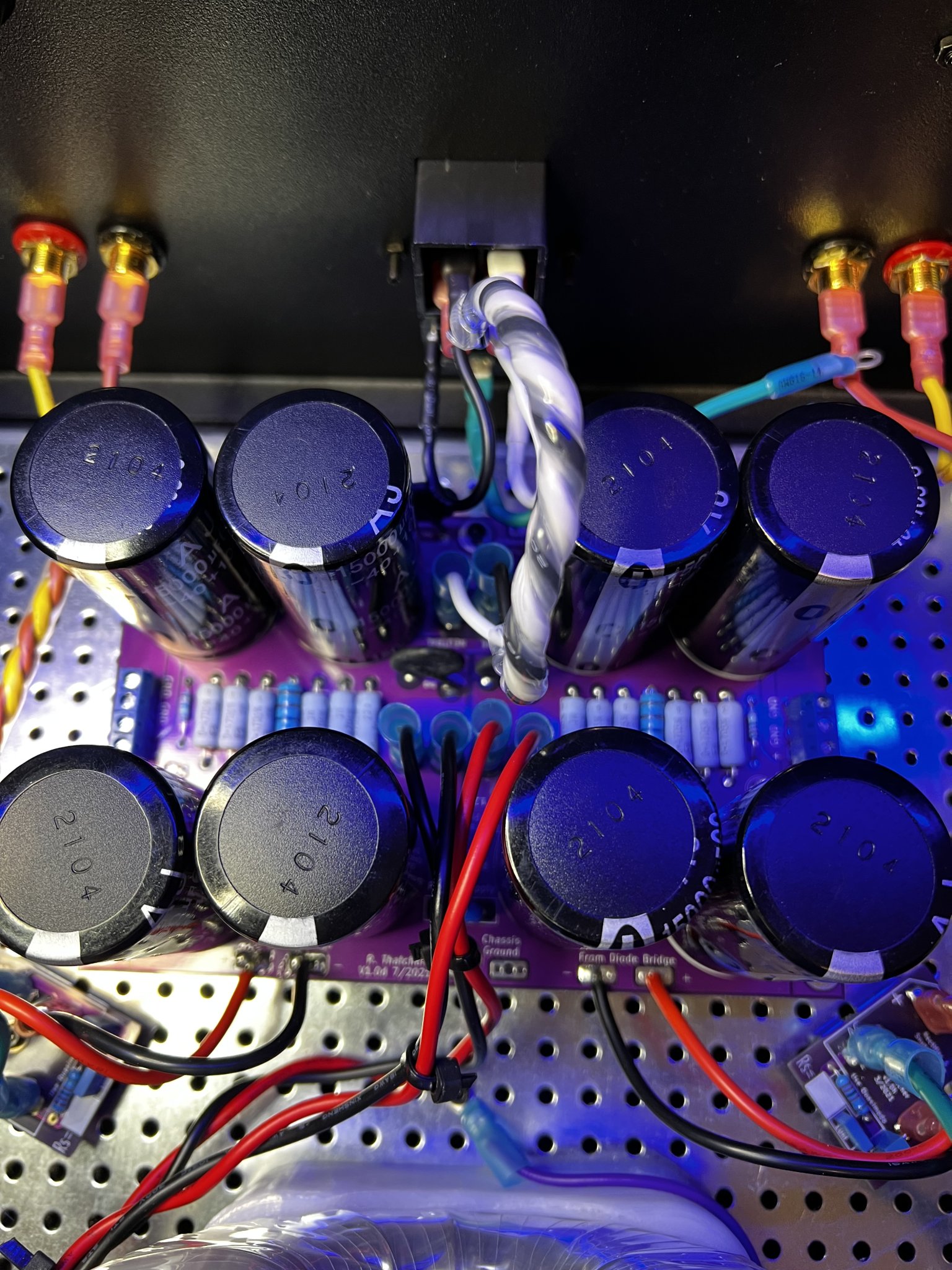

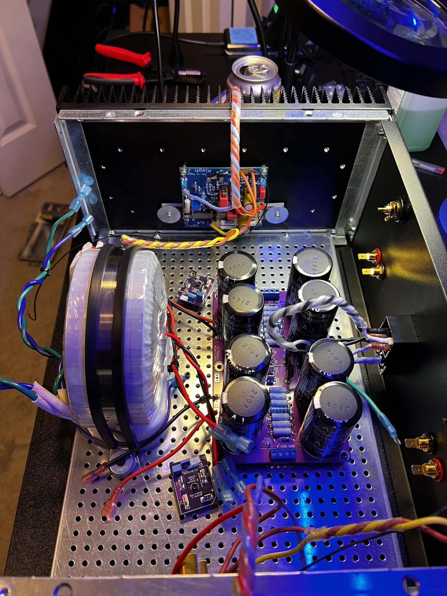

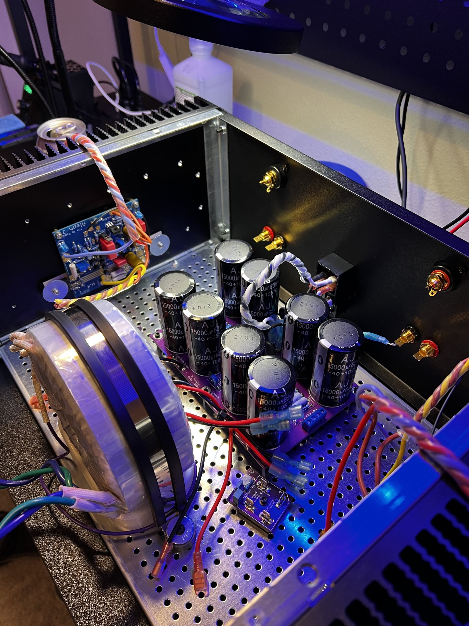

In my experience, since it was brought up a while ago. The 4U chassis from modushop is excellent. I got the iron covers, cheapest version so around $260-270 shipped to US. The thing is built like a tank. Looks super nice and its excellent to work with, so if anyone is considering it, I highly recommended it. Of course the new limited edition PASS DIY is even nicer and roomier. Could you make it for less? Probably. Depends on what your time is worth, and if you have the tools needed to complete it. YMMV
