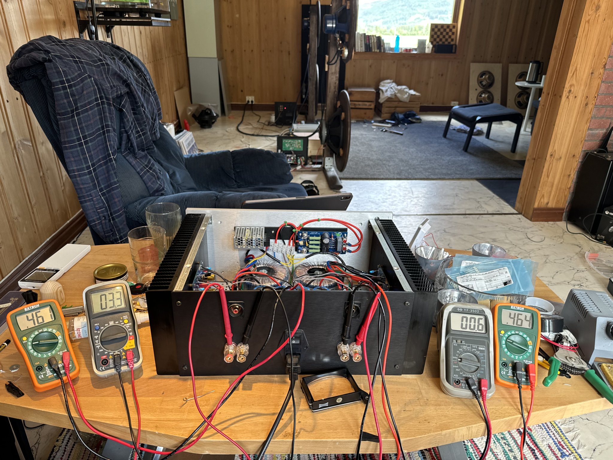

as that, no need for any resistor changes, except upping value of 3W resistors
say that 0R39 (in place of 0R27) will get you to desired lower Iq

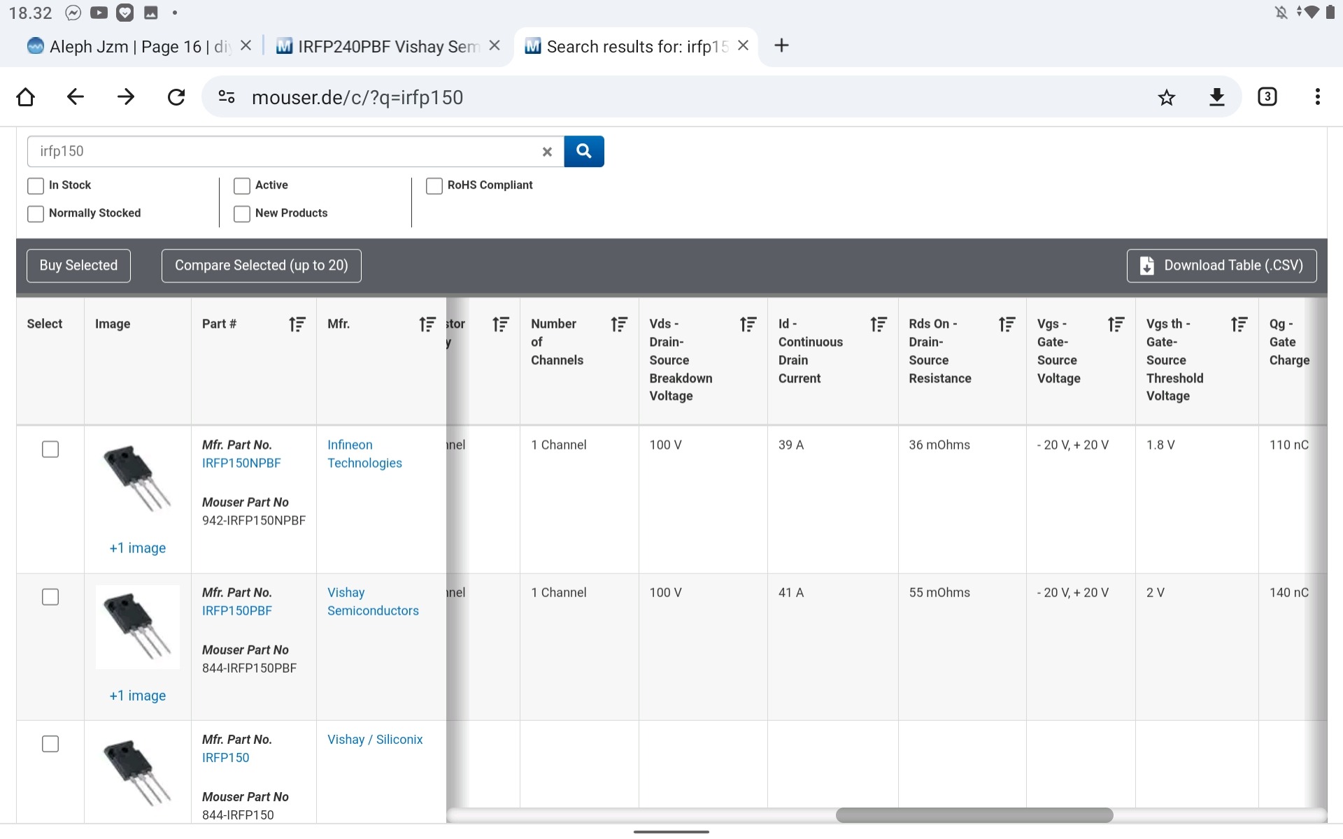

you can stay with IRFP240, considering lower dissipation, but double xconductance of IRF150 will bring lower THD
I see... Nice.you can stay with IRFP240, considering lower dissipation, but double xconductance of IRF150 will bring lower THD
(I only use two IRFP240'S and not 4 as pr. the original AlephJ schm. on the Mimi, you remember ZM?)
Thx. for the explanation
Jesper.

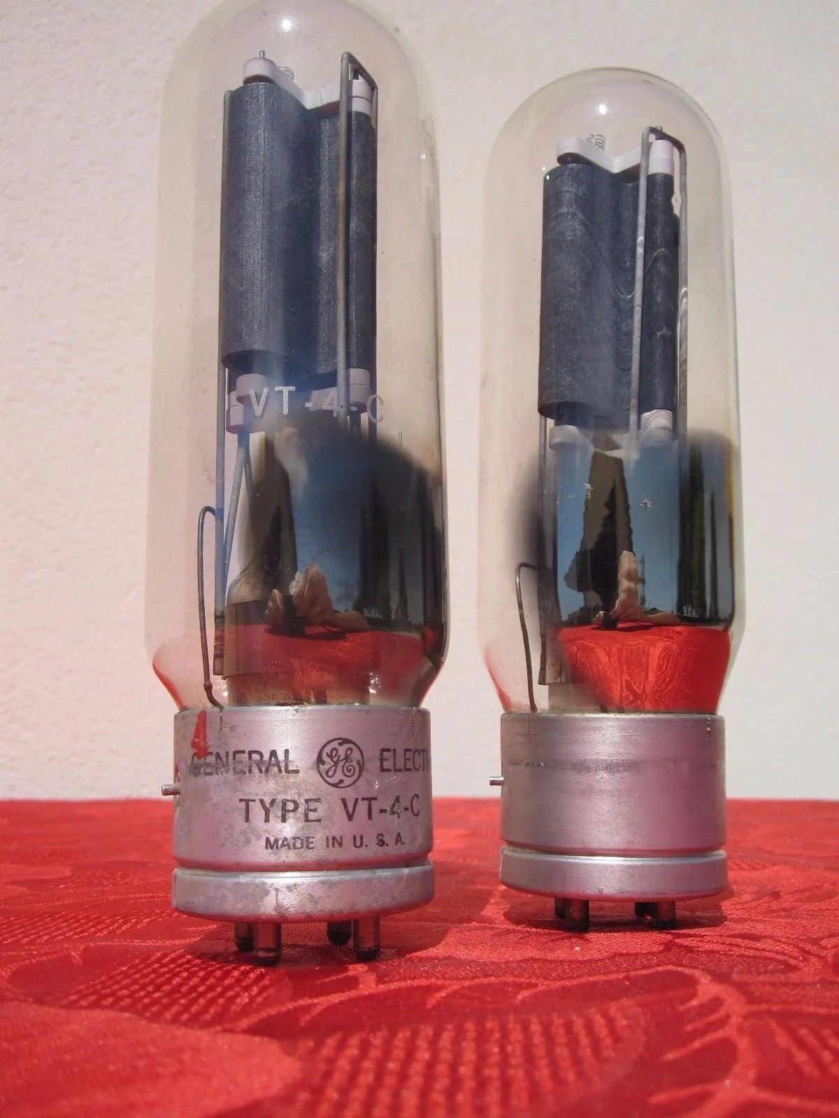

Tungsten filaments, nice glowI'm going to build my Aleph with VT4C in output, as soon I find original Aleph case
I'll put original top panel aside and make new one, with 4pcs of VT4C proudly on
