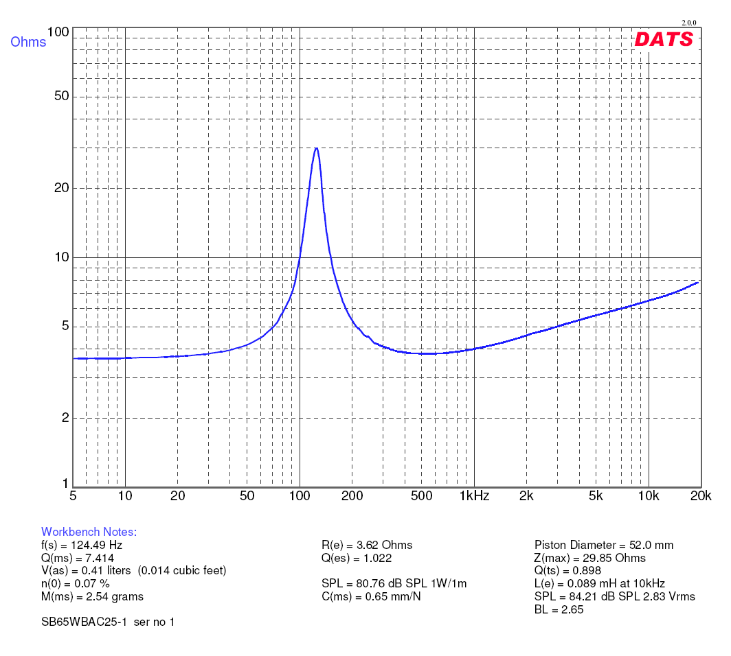

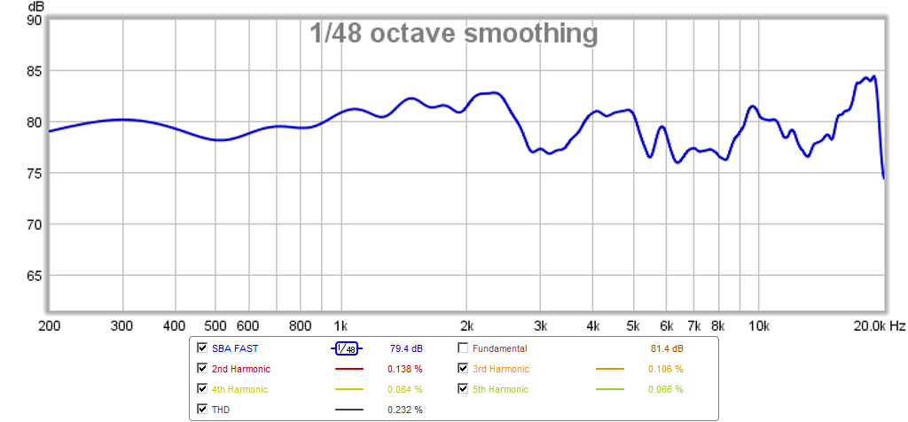

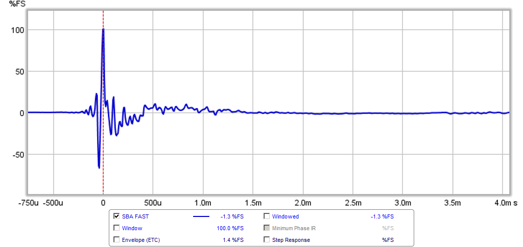

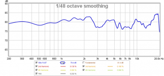

My measurements of this driver have quite a variance from the factory Qts. It measured higher like a TC9FD. The frequency response if fairly smooth, with some peaks but not too bad. This was done in a small Dagger:
Freq response with 4ms gate at 0.5m:
Impulse response:
TS parameters:
Thanks for taking time out to measure this X. I am surprised at the higher QTS myself, as the Voice Coil measurements came out lower then factory. I am wondering if there is an inconsistency with these drivers.
The Frequency Response is not bad, actually it is a little better then some of the full-rangers You measured. Same appears to be true with the impulse response also. Naturally, the 10F looks better, but it should for the $$.
What are your thoughts on that ridge in the CSD at 20 kHz? It is beyond what I can hear, but I do know some people that can hear that high and I am wondering if that would bother them.
Ideally, I prefer a lower overall Qts, as I want the control we were discussing earlier, esp in regards to EQing, but I still like the off-axis dispersion of this driver.
You have to be careful comparing T/S parameters since they are curves not scalars. To expect similar results the kit used to measure them & the weather (temp & pressure in particular) need to be the same of similar. I usually expect the parameters (Qt & Fs) i measure to be higher than factory.
