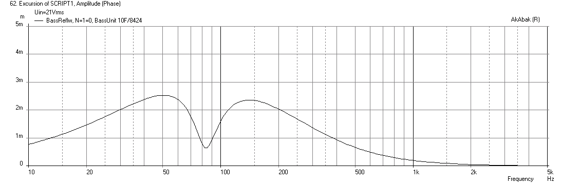

Here is the cone displacement of a single BR driver at xmax of 2.55mm - it takes 21 volts:

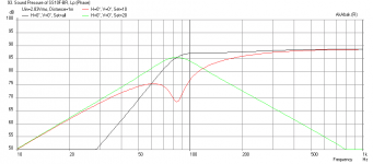

Here is the corresponding max SPL at 21 volts - about 105.7dB! Not bad - x 30 would be quite the loud semi PA like system:

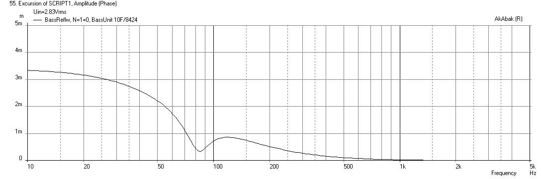

Displacement:
![485436d1432825119-all-aspiring-full-range-array-project-10f-8424-br-79hz-displ.png](https://www.diyaudio.com/forums/attachments/full-range/485436d1432825119-all-aspiring-full-range-array-project-10f-8424-br-79hz-displ.png)

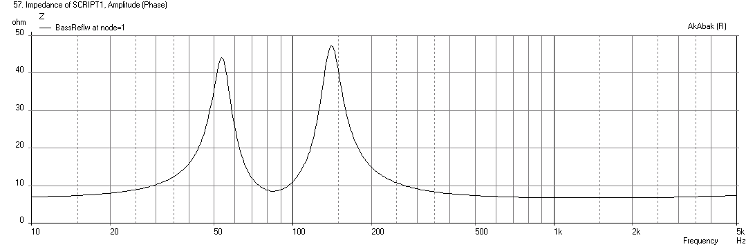

Impedance:
![485437d1432825119-all-aspiring-full-range-array-project-10f-8424-br-79hz-impedance.png](https://www.diyaudio.com/forums/attachments/full-range/485437d1432825119-all-aspiring-full-range-array-project-10f-8424-br-79hz-impedance.png)

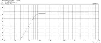

Here is what the frequency response would look like with a 320Hz 1st order Butterworth high pass filter applied (as the linear phase time aligned xo):
![485438d1432825689-all-aspiring-full-range-array-project-10f-8424-br-79hz-320hz-bw1-hpf.png](https://www.diyaudio.com/forums/attachments/full-range/485438d1432825689-all-aspiring-full-range-array-project-10f-8424-br-79hz-320hz-bw1-hpf.png)

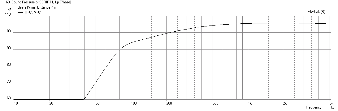

![485439d1432825689-all-aspiring-full-range-array-project-10f-8424-br-79hz-320hz-bw1-hpf-dsipl-21v.png](https://www.diyaudio.com/forums/attachments/full-range/485439d1432825689-all-aspiring-full-range-array-project-10f-8424-br-79hz-320hz-bw1-hpf-dsipl-21v.png)
![485440d1432825689-all-aspiring-full-range-array-project-10f-8424-br-79hz-320hz-bw1-hpf-spl-21v.png](https://www.diyaudio.com/forums/attachments/full-range/485440d1432825689-all-aspiring-full-range-array-project-10f-8424-br-79hz-320hz-bw1-hpf-spl-21v.png)

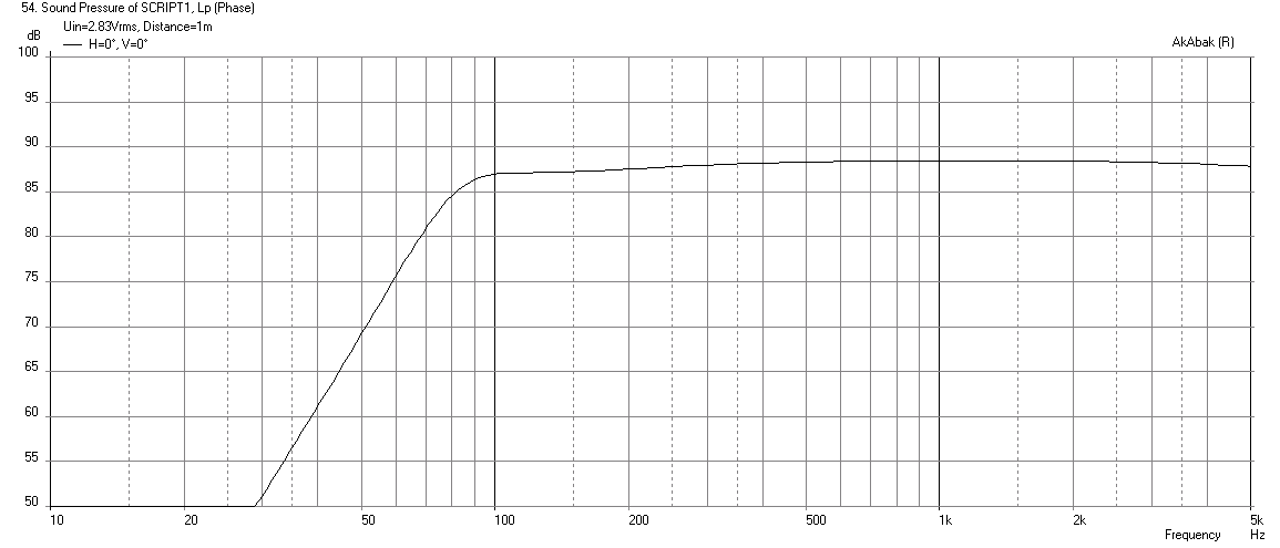

I would question that sim (unless it has EQ built-in): here is what i get. Pretty ugly.
dave
dave

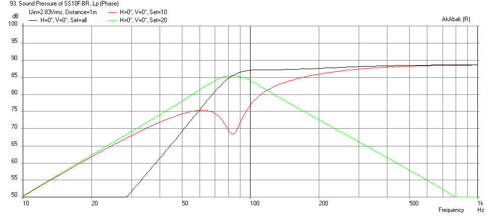

This is straight forward bass reflex element in Akabak - quite accurate from my experience. I have not accounted for baffle step loss because we don't know what the baffle is yet. There is no EQ in my sim.

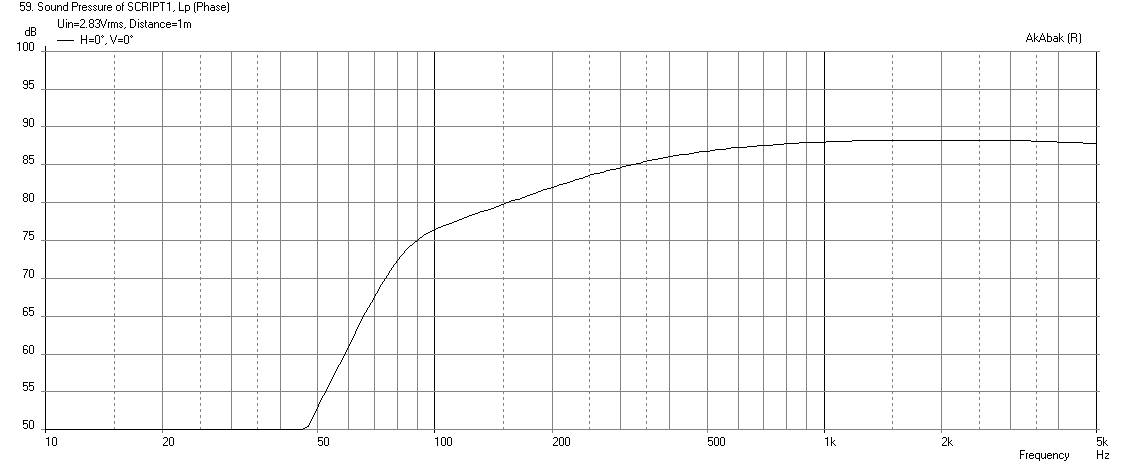

Mine a straight forward BR done in True Audio's MacSpeakerz…. can someone run a WinISD and see what comes out?
dave
Use TS params from here
http://www.scan-speak.dk/datasheet/pdf/10f-8424g00.pdf
In Akabak, there is an option to set effective Q/fb. I set that at 0.1 to correspond to having some damping internally. Makes a minor difference - won't fix a funky step ledge response like that.
I used the data right off the scanspeak data sheet.
dave

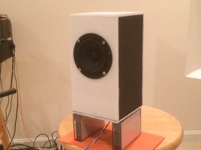

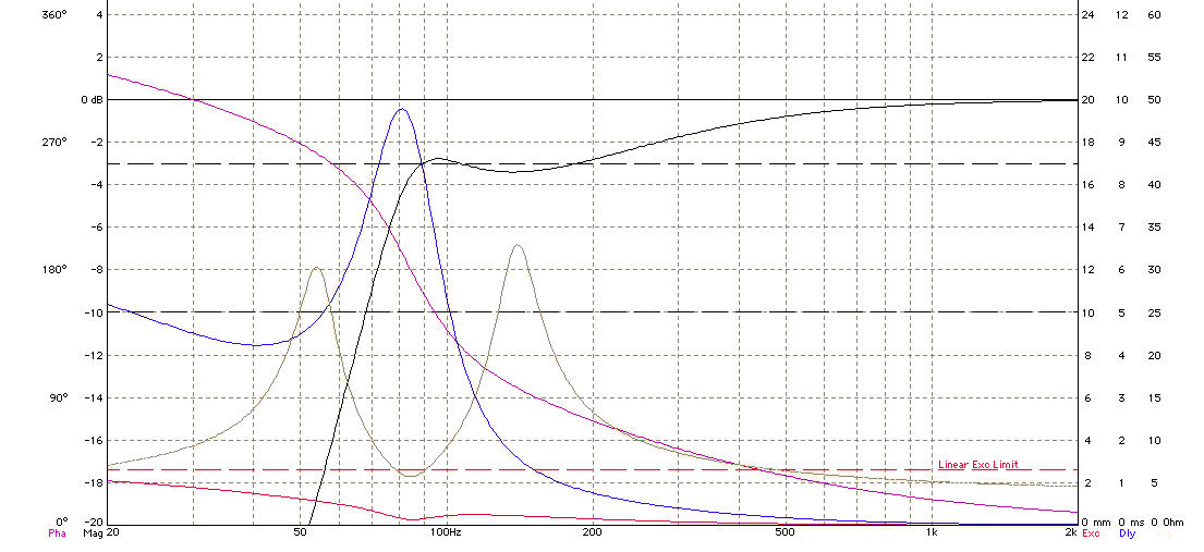

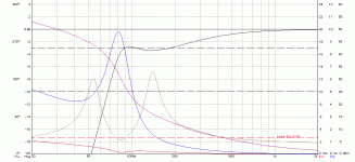

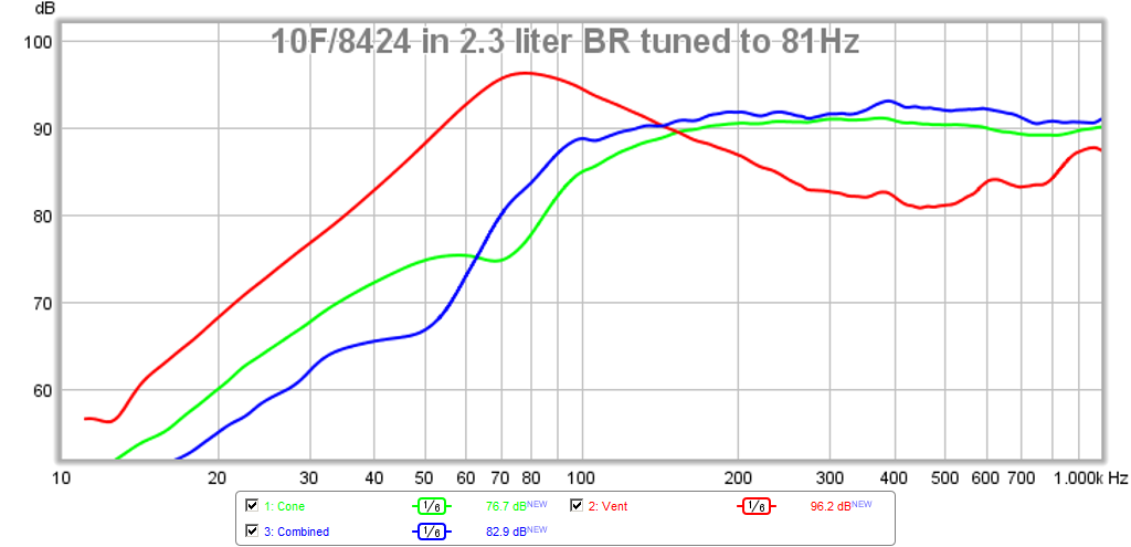

Rather than argue with whose model is right, I just whipped up a quick and dirty 2.3L bass reflex box and tested the 10F/8424 - 30mm dia x 75mm long port exits out of bottom, I put fiberglass damping on one end surrounding the internal port tube, and lined the wall opposite the driver with foam:
![485554d1432900103-all-aspiring-full-range-array-project-10f-8424-br-81hz-test.png](https://www.diyaudio.com/forums/attachments/full-range/485554d1432900103-all-aspiring-full-range-array-project-10f-8424-br-81hz-test.png)
Near field measurements of port (red) and cone (green - still some port contribution) and combined output (blue) about 0.3 meter away (levels are NOT to scale):
![485555d1432900103-all-aspiring-full-range-array-project-10f-8424-br-81hz-meas.png](https://www.diyaudio.com/forums/attachments/full-range/485555d1432900103-all-aspiring-full-range-array-project-10f-8424-br-81hz-meas.png)

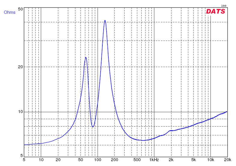

Impedance measurement using DATS v2.0 showing tuning freq of 81Hz:
![485556d1432900103-all-aspiring-full-range-array-project-10f-8424-br-81hz-impedance-meas.png](https://www.diyaudio.com/forums/attachments/full-range/485556d1432900103-all-aspiring-full-range-array-project-10f-8424-br-81hz-impedance-meas.png)
Simulation of cone, port, combined for 81Hz:
![485557d1432900103-all-aspiring-full-range-array-project-10f-8424-br-81hz.png](https://www.diyaudio.com/forums/attachments/full-range/485557d1432900103-all-aspiring-full-range-array-project-10f-8424-br-81hz.png)
Oh, and almost forgot to say, with a 1.0mH & 5R BSC in place, the response is flat and it sounds quite nice. 80Hz bass is not bad and sufficient for easy listening as a portable speaker or mp3 player dock. The lower Qts of this driver makes for a compact BR box.
