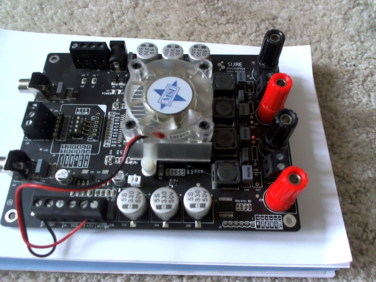

I'm wondering if the very low cost class D amp boards at Parts Express are any good. For example the Sure 2 X 25 watt TDA7492 stereo poweramp board at $20? I was thinking it could make a nice ghetto blaster for camping with a 19 volt laptop battery. The reviewers liked the sound of this one significantly better than the ncores they have.
Sure boards
Bob,
I have two of the older Sure Boards based off the Tripath TK2050. The tonality is very similar to my Peter Daniel's LM3875 Chip Amp Build. I prefer the Chip Amps because they have a more "open" and 3D mid range. The Sure Tripath creates a 2D soundstage that is a straight line between the speakers. The Bass control and Treble are pretty much identical. Bear in mind that I did not modify the Sure boards, so those that are willing to do some surface mount soldering can improve the stock sound.
You have a legitimate concern here. I had an accidental short on one of the speaker terminals and BOTH speakers howled at maximum output. It took me the longest time to figure it out, as it turned out to be a strand of tin (I am guessing 40 gauge) that had got between the terminals. Lord knows where it come from. I was lucky. The speakers and Amp survived. But it is for this reason I am selling these boards. I was going to use them for the open baffles I am building for my brother. But because the back of the speakers have removable speaker grills and my two nieces are 3 and 6 years old, I do not want to take a chance. The LM3875 Amps have better protection.
But for your application as a ghetto blaster, with everything enclosed and secure, I think something like this is a good option. Sure has improved their boards quite a bit since I bought mine.
Bob,
but worry about failure mode eating my speakers.
