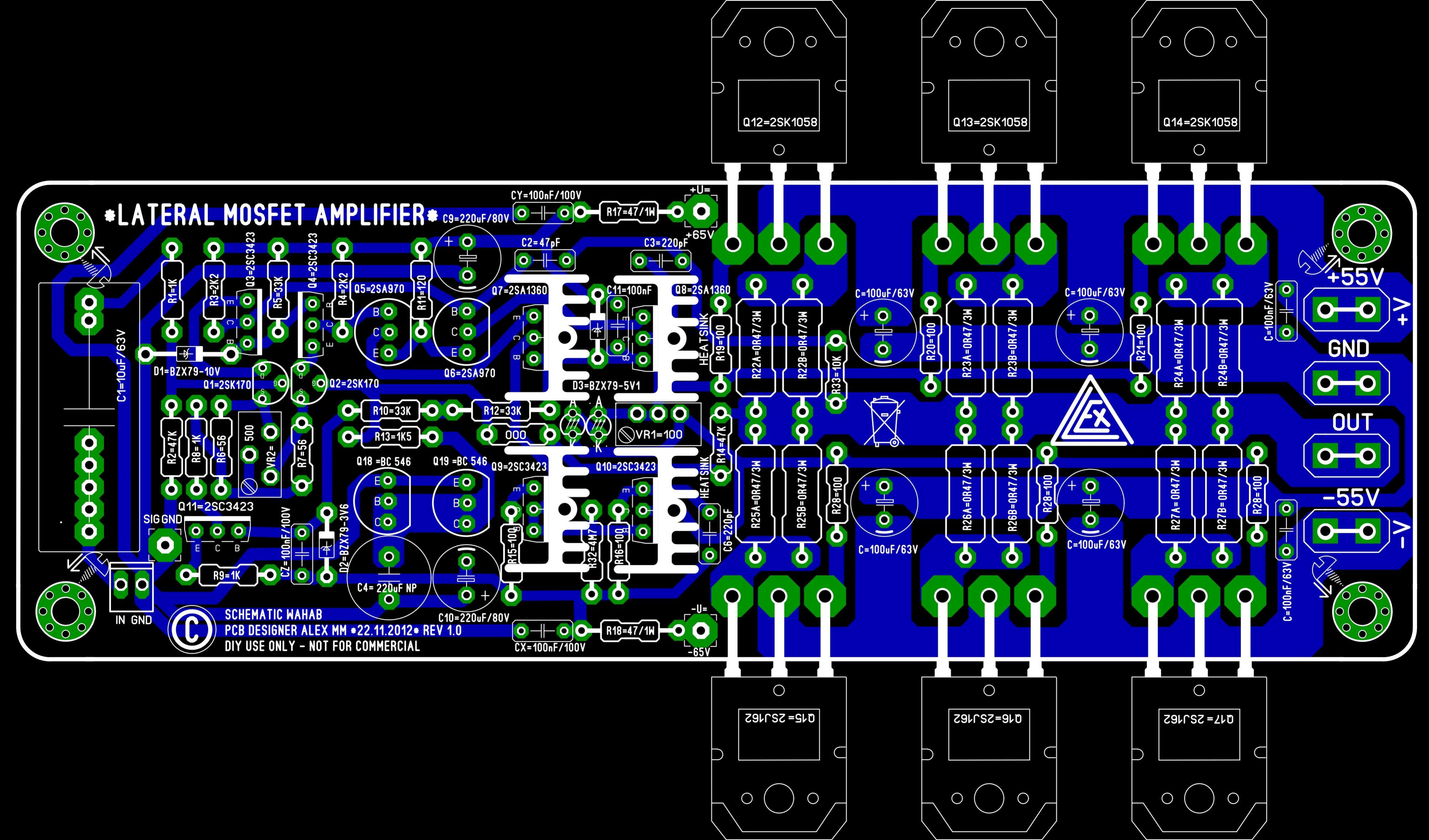

As for special resistors , just take regular non inductive ones ,
expensive parts are useless by the way , most of the perfs
are active components dependents.
..... another kind of PCBacording to schematic from post #194
Regards Alex.
Nice board , Alex.
Nice job, Mr. Alex.
Please.... SCHEMATIC WAHAB or SCHEMATIC GABOR?
Thanks!

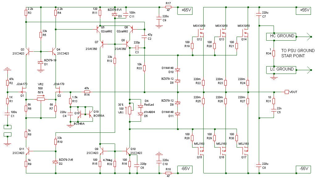

It is on post 194 but neverless here it is again.
![311185d1352565541-all-hitachi-lateral-fet-amplifier-diy-designed-paul-kemble-naim-hitachi-20ffet-20mod5-20sch.gif](https://www.diyaudio.com/forums/attachments/solid-state/311185d1352565541-all-hitachi-lateral-fet-amplifier-diy-designed-paul-kemble-naim-hitachi-20ffet-20mod5-20sch.gif)
Is C6 across R16 for stability ? Should introduce a zero in the OL gain?
Yes , it slightly extend the unity gain frequency from 15.5Mhz to 18Mhz
but the most valuable change is efficient reduction of the phase lag
at thoses frequencies.
And R33 (10K) does go to the output node and not to the + supply rail ?
You can see that R33 is an AC coupling only , from power output to the inverting input of the VAS to create a local feedback loop that act only at audio frequencies and wich is quite efficient in output stage THD reduction as extensively explained by Edmond Stuart in his insightfull threads about TMC , wich is exactly the role of the compensation capacitors arrangement C3/C2 and R33.
edit : If R33 is connected either to ground or + supply rail the compensation scheme
would be switched from TMC to TPC.
Sorry for not being clear.
I meant: Alex wrote on the PCB the words SCHEMATIC WAHAB. I am asking if this schematic comes from you or from Gabor.
Thank you!
.............. If R33 is connected either to ground or + supply rail the compensation scheme would be switched from TMC to TPC.....
Yes that was what I was getting to.
Im sure its electrically perfect, but I still cant help thinking how it would look if the lower fets were 'folded' up in line with their mates
hey, btw, I suppose it would be possible to just omit mounting one output pair if you only want it with two output pair, and maybe lower voltage a bit

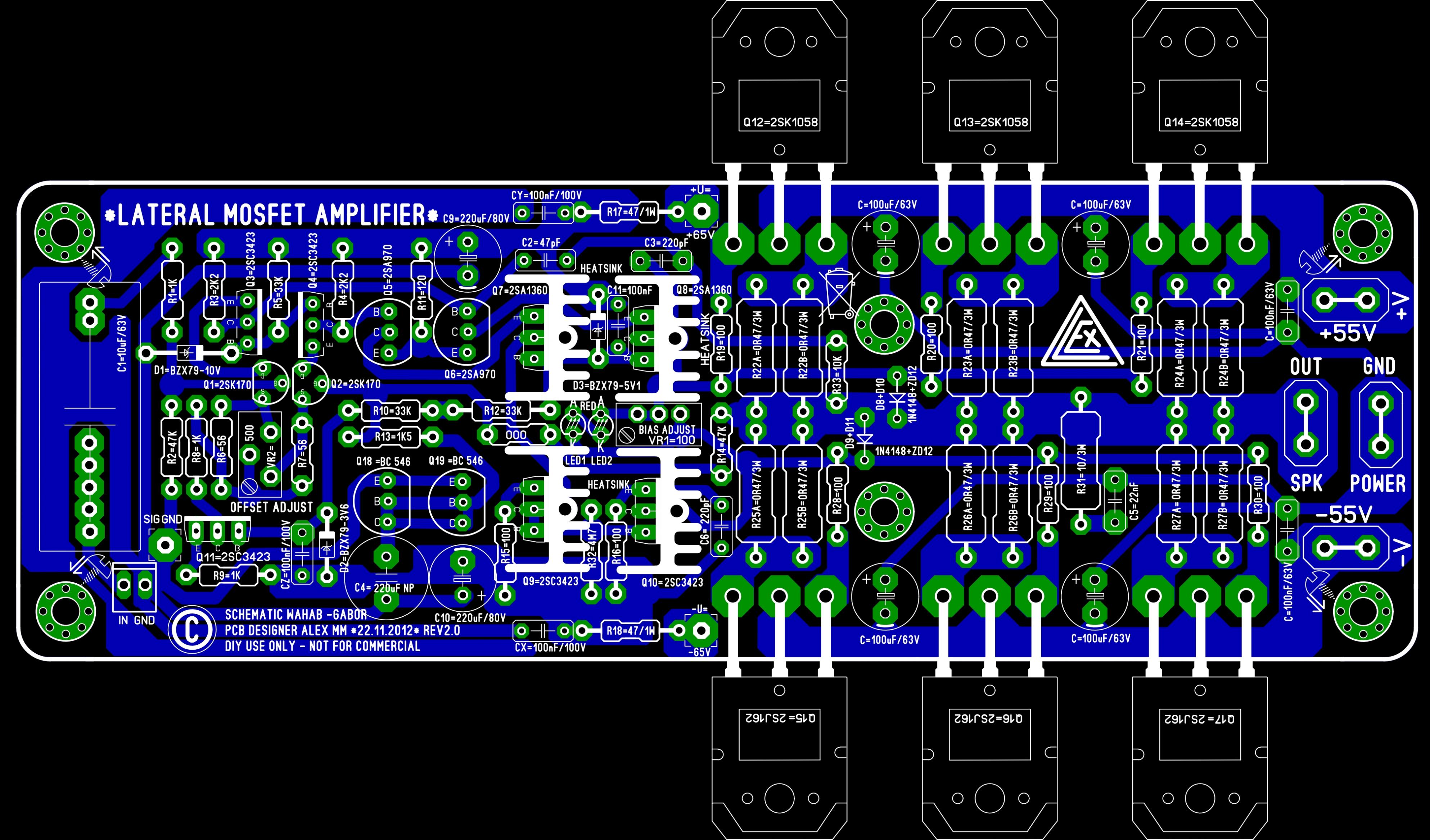

Nice design Alex as always, thank you.
Tinitus you right, at these aranjament you need to use some copper heat spreader under the mosfets that would help a lot.
Since all 6 mosfet biased min. 100mA/each and they are close to each other that would be the best solution.

@alex mm, which is the distance between the edge of the pads 2SK1058 / 2SJ162 power transistors ? I think that distance is too small. It's a mistake that is seen in many PCB's that you created. And not only there.
And GND route drawn circular is not a good choice.

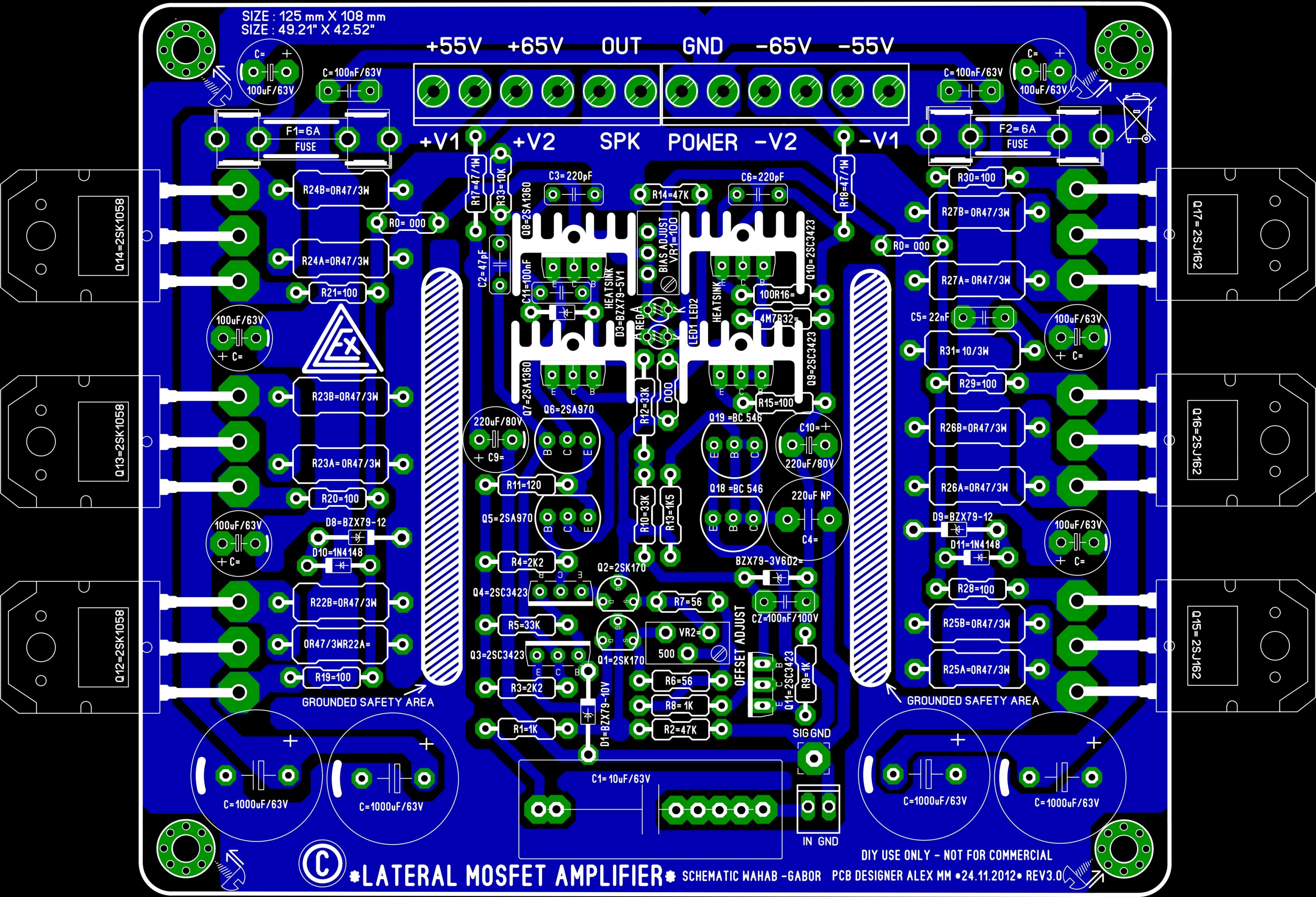

looks good, but still ineffective heatspread
heat goes upwards on heatsink
and lower outputs will put heat strain on the upper outputs
please please, put all outputs in one straight line
imagine a 300mm heatsink
board length of 150-200mm seems ideal
well, maybe only in theory

@donpetru distance it's 1 inch ,or 25.4 mm from center to center OT.....
I layout, in few hours, and have joint ground plains , left side with right side
yes I admit my mistake , corrected .
Regards Alex.
L.E. I will try tomorow to layout all in line , but for today it's enough .
Regards Alex.
try look at placing power rails and ground from the board middle(connectors at front edge)
and perfectly ok to use a wire jumper, when it makes sense to do that
Just an idea for Alex his PCB layout. I used the same position for the OPS in my last amp.
