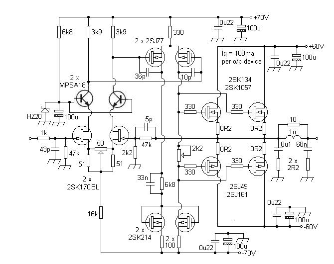

Hard to believe so little interest on these amp circuit![]()
That's because you cannot build an amp. If you can, you may also have little interest on the amp.
Some might have discarded the idea simply from looking at the VAS.
Some might have discarded the idea after doing some simulation.
Some might have discarded the amp after building and listening to it.

Why I like these circuit? Not very often see on the forum all (lateral) fet schematic!
One think I would like to ask, if you think these or that is wrong in the circuit please let us know why and how would you fix it!
It would be much more positive than just these no good or that
Some advise would be more constructive than criticism even if that sound positive...

Gabor, think about the truth or logic behind this:
Lateral fets are very expensive. You don't want to put it (two pairs per channel!?) in mediocre circuit.
The input cascode can use bipolars for the upper pair , cheaper and
performing as good if not better than the fets.
Keep the input fets , they can be replaced by recent ones.
There s no advantage on a all fet VAS , using bipolars would certainly
provide better perfs as well as getting rid of problematic availability.
The output stage , well , i wont say nothing about it , i m myself using
those very same laterals, although with a different topology.

Hello Jay
I would like to keep these as a high power amplifier, that is the reason for 2pair power mosfet.
Yes I did follow for a while the Fetzilla amplifier great design but how I stated I want higher power amplifier (I have 40-0-40VAC) transformer 700VA.
Yes lateral fets are expensive but sound great in a well designed circuit. It worth that extra cost.
We want to build great amps from cheap devices, I do not say not possible but to me worth that extra cost. I already have them. Renesans produce them $7/device I think that still affordable...

Cant answer for the whole schematic but for the bipolar part of the cascode
increase the 6.8K resistor to 33K at least as the original value send
way more current than necessary to the zener.
This latter should be reduced to 10V max as it is the value
at wich the excess current start to increase dramaticaly
in most jfets.
Also , the MPSA18 are perhaps undersized in respect of TDP ,
a good replacement would be 2SA1360/2SC3423.
I once simulated this circuit to check its behaviour ,
i ll look at the data that are on an old hard drive ASAP.
Very similar circuit was in The Audio Amateur over 20 years ago by Erno. The MOSFETs in the middle are unobtanium, although you sometimes see them on EBay.
Recently there was 3 sets of lateral FETs for the 1980's Maplin mosfet amp on ebay.

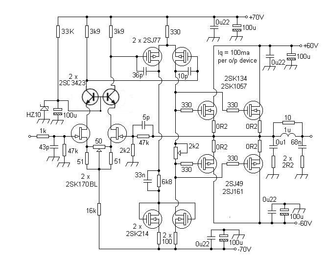

Hello
Thank you wahab!
I made all the mod you advised.
I having second thoughts about the 2SC3423, do we really need that beefy bipolar for cascoding.
But I did changed because want to keep going forward so I can do some real life test.
I changed the resistor and the zener diode to.

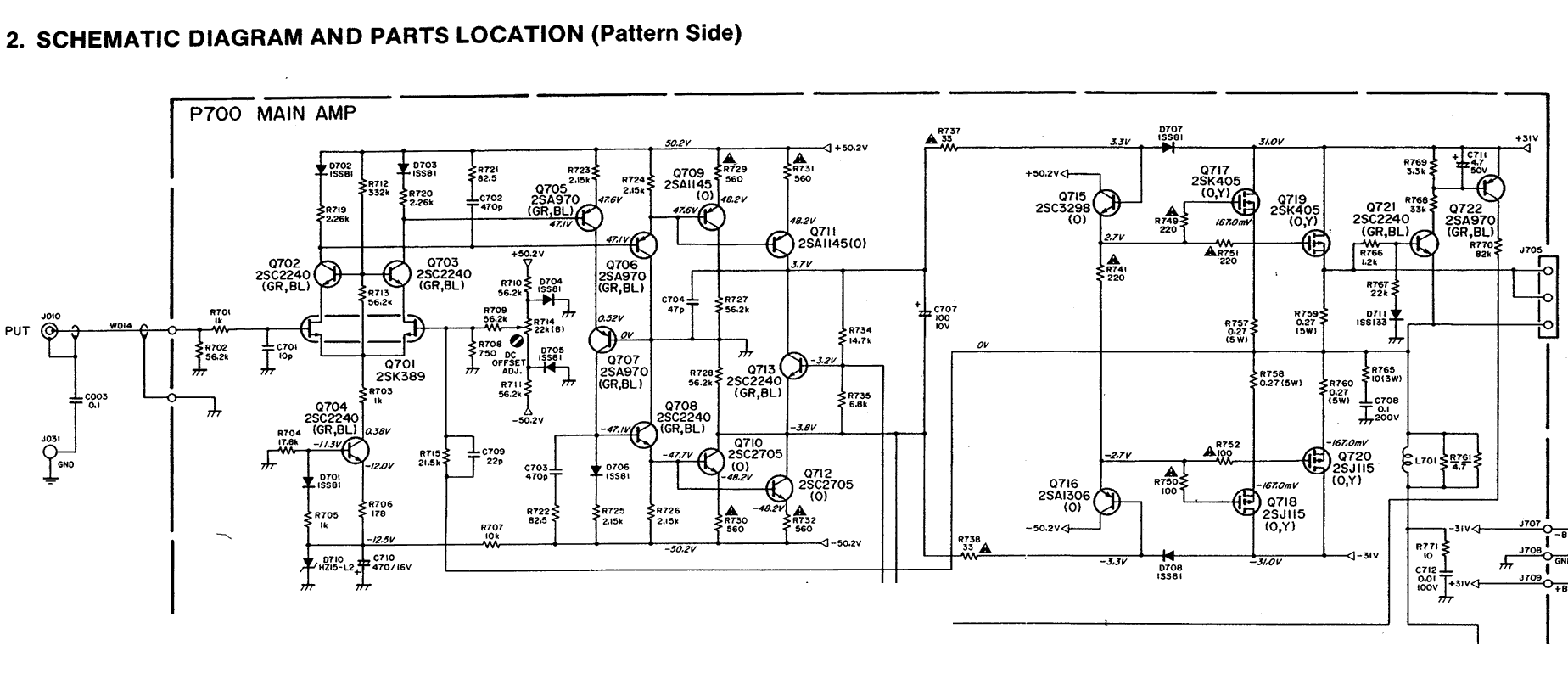

Zen Mod I did look up the Marantz MA24 schematic I think that to complex.
I like as simple as possible until do not degrade the sound.

I try to give you a few point that will help you understand
some of this amps requirements.
- The LTP total current is defined by the 16K resistor and will amount
to about 4.5mA so this resistor dissipation will be 0.315W , wich
is a lot , surely that it can be reduced without entailing the perfs
but if such a change is made the 3.3K resistors that load the cascode
should be increased in an inverse ratio.
The 16K could eventualy be replaced by a current source using
a 2SC3423 with a little heatsink.
- Each side of the cascode will have 2.25mA , hence the bipolar parts
will dissipate about 0.14W each , that s why i proposed the 2SA/2SC parts
wich can be replaced by their plastic case version 2SA1145/2SC2705
(used in the MA24 !!) although for reliability i would stick with the first ones.
- It is likely that the 2.2K trimmer has too high value for a VAS current
that is in the vicinity of a few mA to 10ma , a 470R would be more cautious ,
at least for the test board.
- If your output transistors are matched enough you can get
rid of the source 0.22R and expand the domain in wich the
output stage has a square law behaviour.
Hope this will be useful to your project.

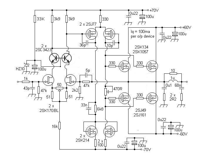

Hello
Yes it help a lot!
I'm so grateful to you and some other guys who came to help not just write these or that bad, or please look for another amp.
About the Source resistors Juma once wrote those does not hurt if they used.
You 100% right if the power mosfet well matched better if the Source resistors left out.
Those are right before the speakers..
So reduce the 2.2K trimmer to 470R.
I'll stick with the transistor you told for cascode. For cascode I need only NPN device, or not???
Do I leave the WAS how it is now? Or let it test how is it and we will see.
If the sound to soft I think it will be better to use BJT..

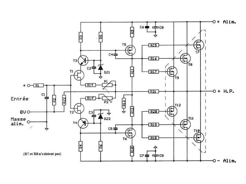

I do have a amplifier to build (I have the stuffed PC boards) use almost the same devices but that is a symmetrical circuit.
Called Grand Mos
I post the basic circuit because that a commercial amp of Jean Marc.
Same lateral power mosfets , same mosfet as a driver and Toshiba J Fet cascoded with BC550/560
Symetrical circuit has a lot of disadvantage to. Can't be matched the P channel to the N channel not even close to 80%

Yes it help a lot!

Skip the so-called current mirror with MOS-FET from VAS because is not useful. Or does not have the same benefits as one with BJT's. If you do not believe me, then try and convince you.Hello
Upgraded circuit.![]()
Then, why use MPSA42? Try my solution where you can use instead of 2N6800 any equivalent Hitachi part or IRF610 from Samsung. And includes some constant current source in the circuit input and VAS as we have done it.
It's much better this way if you want to get some performance, because otherwise, as you drew you amplifier diagram, the results are in performance of BJT's classic. I guess the solution with MOSFET you want to achieve much higher performance variant BJT. Right? If yes, then follow my advice.
