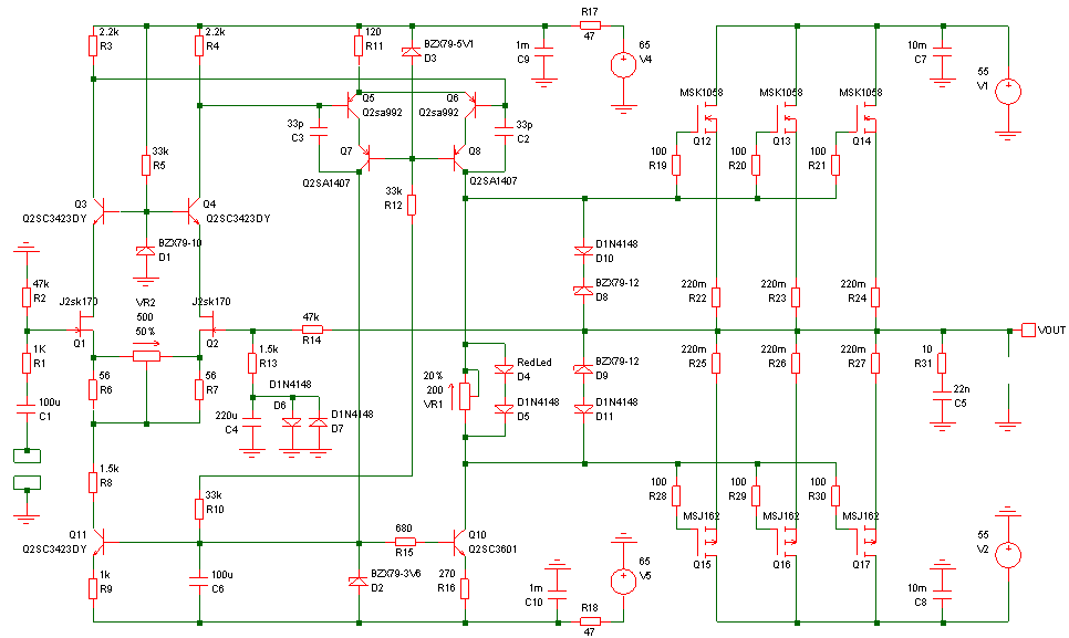

Yes I'll go with 3 pair power mosfet, I have a transformer 40-0-40VAC 750VA or I share the transformer with my Aleph2 2PC 39-0-39VAC 600VA/each.
The transformer I'll use will depend on the bias req. of the amplifier.
I'm not sure what would be the right bias (VA rating of the transformer) I do not want another Class A only the first couple Watt
Generaly the recommended bias for 2SJ162/2SK1058 is 100mA
to 120mA/device as there s nothing substancial that is gained from
increasing the quiescent current.
Moreover , suppressing the source resistor extend the power range
at wich the devices have a square law behaviour so with 3 pairs
and a total current of 300mA this allow to have pure class A up
to a few watts.
If thermal dissipation/power comsumption seems to you too high
you can reduce the supply voltage to half the value since the circuit
has wide power supply variation ability.

The Grand Mos amplifier has not good perfs as lateral fets do not
suit low negative feedback designs , i wouldnt recommend this amplifier
unless one is not troubled by high THD levels at medium power.....
How did you arrive at this conclusion?................. with 3 pairs
to a few watts..............
300mA output bias will give <600mApk of ClassA output in a push/pull amplifier, i.e. <1.44W of ClassA into 8r0.

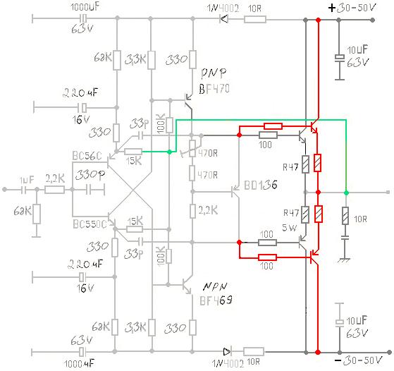

Are you talking about my Darlington amplifier?? I posted about 2 years a go, I'll post the basic circuit here.
If that is what you are talking I have to let you know sound wise I still didn't find a amplifier even come close to that!
These is a humble statement.
Built and tested over 100-120 amplifier (from N Pass, Symasym, Gainclone P Daniel, Hiraga both,so on)!
I owned (prepared or sold) over 450 commercial amplifier, nothing can be mentioned in the same category.
I do rebuild that amplifier soon.
Only think it has a thermal stability problem.
Examp. I set up the bias 100mA, when the heatsink warm up the bias goes higher and it get warmer the bias goes higher until it self destruct herself.
To avoid these problem req. over sized heatsink..Whit that remain stable.
I don't know if I would remove the BD136 from the main heatsink what would happen. I never tested that way..
The amp last time used TIP142/147 power Darlington (one pair)
MJE243/253 driver and 2SK170/2SJ74 input.
I used 4.7uF BG non polar on the input, the power resistors must be 0R22.
Last time I built 1 par darlington, now I'll use 2 par and over sized heatsink.
If the amp get the right size heasink it has no problem with thermal stability.
My friend used these amp over 10 years with 400mA bias but huge with huge heatsink.
He also didn't find better amplifier than these (sound wise)

Why I'm interested these mosfet amplifier? I have all those Hitachi mosfets I did purchased for the GrandMos and other similar amp.
The GrandMos very popular in France (cost over 2000Euros), that is why I have the stuffed PC boards.
But I read the ProFet is better amplifier, same designer but the Profet 25W in Class A .
Guess what I built the Profet with high quality parts Caddock and Takman resistors, Russian PIO capacitor etc.
I tested and tested with different quality parts and the mentioned gave the best performance.
The sound quality remain well behind to my Darlington.

Hello Jay
Yes, that one. Basically it is an SSA without the input cascode.
Yes, the issue with the topology is bias stability. The absence of input cascode makes it worse. Also the use of darlington output, requires high bias (at least 1A) for medium output. And at least 2 pairs. The 100K feedback resistors in your circuit help a lot.
Have you tried darlington compensation circuit? May be not necessary. I think BD140 will do.
Your darlington amp is similar (apart from input cascode and feedback to VAS) with the SSA, not Megalith, LeMonstre, etc. Remember, it doesn't have to be class-A with SSA. That's a plus especially with latfet.
