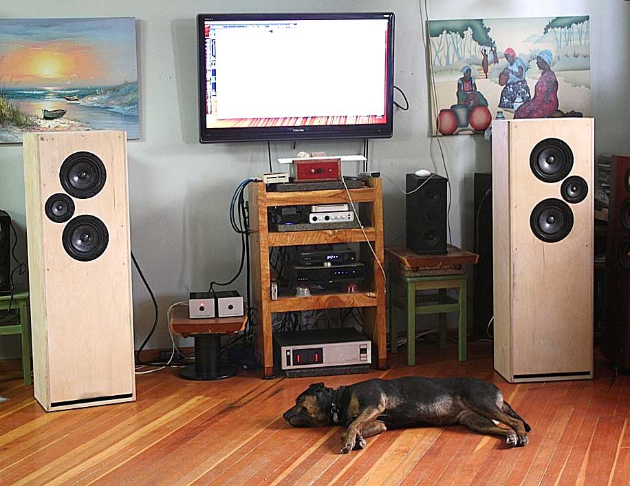

I think that the importance of the treatment exceeds the importance of the break-in for taming the A7P. In this respect IMO it is a bit of a pity that the A12PW was marketed specifically as a companion to a driver that doesn't appeal to as many people as the metal cone Alpair 7's. The A12PW is a fine woofer, once I got the cabinet tuning right, it worked very well without having undergone any break-in procedure. Indeed, ample bass output and quality for a woofer of its size. An equivalent woofer with a cone that is color-compatible to the metal Alpairs would probably sell well. Of course there is no technical reason why the A12PW can't be combined with a metal Alpair, but, that color... Mark himself knows that as well, just see the "Sota Markaudio" video on Youtube.(and treatment)
I had no trouble making the A12PW sing with my "frankenpair" (a wideband driver with an adapter ring made to fit the A7P's driver cutout) in place of the A7P, but visually it remains a bit of a botch, and for that reason the project will not make it into the living room. So my personal conclusion of the endeavor is: the A12PW gets the thumbs up, but unfortunately its success is held back by the small audience of its intended companion driver.
