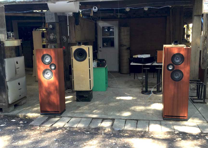

They do need an XO. A passive XO is quite a bit harder than a passive one but can be done.
The relative sensitivities of the drivers make for a much easier job if you use A7.3 instead of A7p (which would need some padding).
We started these with A7PeN but switched to A7.3eN which turned out to be better sounding and enabled us to start working on a passive XO.
We have so far done a 4th order parallel XO, and a 1st order series. The 1st turns out to be best overall (good enuff to publish) but not everywhere so we will continue our work.
The cost of decent parts for this XO is considerable (a pr of the cheapest Solen FastCaps for the large cap is over $140 CAD FOB Solen, and there are a lot more parts than that) because of the ~250 Hz XO. Certainly enuff to make a 2nd power amp and the PLLXO (ignoring RCA jacks and case typically $1-10 if you don’t use exotic caps) this MTM was designed to use.
The plans for this MTM TL are part of either the A7x or A12x paid plansets. http://www.diyaudio.com/forums/plan...10-hifi-minionken-plan-set-subscriptions.html We had help from Dr Scott @ Woden for the ML-TL.

I built the two passive XO's that Dave mentioned above (design by others) - as he says, the total parts cost for the large film caps and air core inductors was well over $150 for either version - luckily we had some on hand, so "we" didn't have to fork out the full amount for both.
I personally preferred the parallel myself, but would also suggest that a dedicated PLLXO could be put together for far less than the cost of either passive - and my guess is that a large number of serious DIY idiots, oops, fanatical builders, would have enough spare amps to chose from.
Just for a lark, I also built a 4-channel digital amp (SURE TK2050) with buffered selectable LLXO to compare. Thanks to recycling an old Bogen amp chassis, the total parts cost of this little beast was approx $200.
I could live with any of them, but the simplicity of a dedicated one box solution has a lot of appeal - hell, if I knew what I was doing, it could incorporate something like a streaming receiver, or even minidsp for an upstairs background music system. That's pretty much what Tom Christiansen described in a post of his on the Modulus86 build thread.
