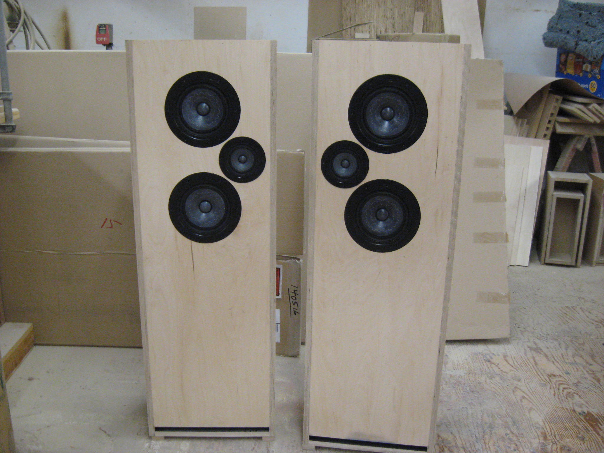

wish I was allowed to build something that simple
ours will be a dual TL MTM - pretty damned tight squeeze - some of the joinery has given me renewed respect for dental surgeons. I almost never slow down enough to take build pictures, but maybe Dave wants to release the preliminary concept sketch phantom model - just make sure to include the brace in the drawing.
finally ready for initial listening session this weekend
Nice job Chris I look forward to hearing them, maybe this weekend if I can make it down there to pick up the FF165's.
Bernie
which I've not had a chance to plug in yet
Too many choices Chris? I really feel for you, you've got it so hard.
Actually, been working in both the shop weekends and some bookkeeping for the past few evenings - haven't even turned the TV on since last weekend - and I watch a lot more than listen these days.
Chris, Dave,
The Dual TL MTM looks like it means business...
Besides the usual refined fare can you hit them with something heavier also?
need a hand cart to move these puppies - yup, they'll be very interesting.
