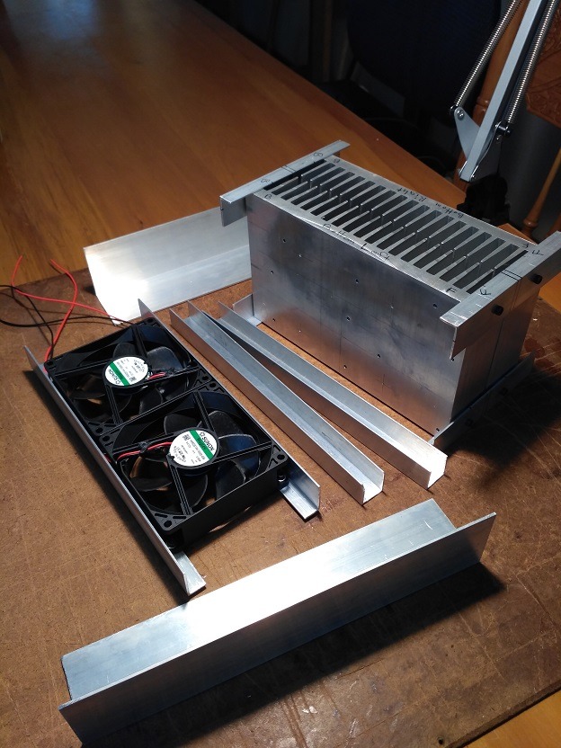

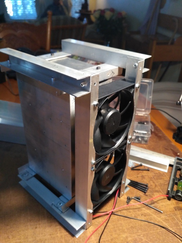

I will be using active cooling with two Sunon fans (with Vapo bearings for what it is worth). They are fed with a 12V 1A wall wart and are running at full speed currently. Question - If I want to slow them down a bit - what value resistor(s) can I try? I have no idea where to begin, except maybe somewhere between 1 ohm or 100k ohm.

You can use resistors to slow down fixed speed fans. You need power resistors though like 5W cement filled types. Try 47ohms or 100ohms. You can also string diodes in series and each is 0.6v drop. Be careful of fan stall. Having a high temp sensor tied to the PSU shutdown is a nice feature to have.
I would recommend using Noctua 4-pin PWM fans and $5 Chinese variable speed PWM fan controller. At low speed it is inaudible. It has sensor to kick speed up if temps are too hot.

They come in all sizes, larger ones are quieter. There is also a “speed reducer” which is probably some diodes in series to give voltage drop.
Thank you X - I will experiment this weekend with some resistors, now that I have an idea what to aim for. Yes, I know about Noctua fans and fan controllers (from discussions in the ABBB thread), but I am a cheap and frugal amp builder. First want to try with the Sunon fans. Got them cheap locally.

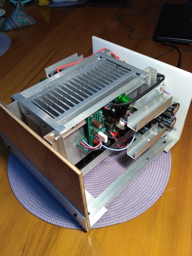

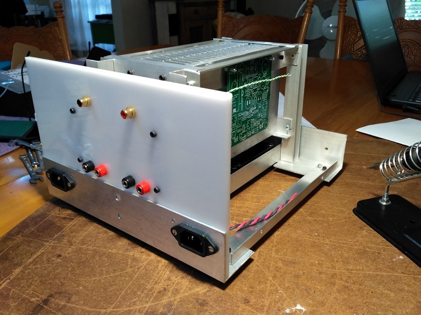

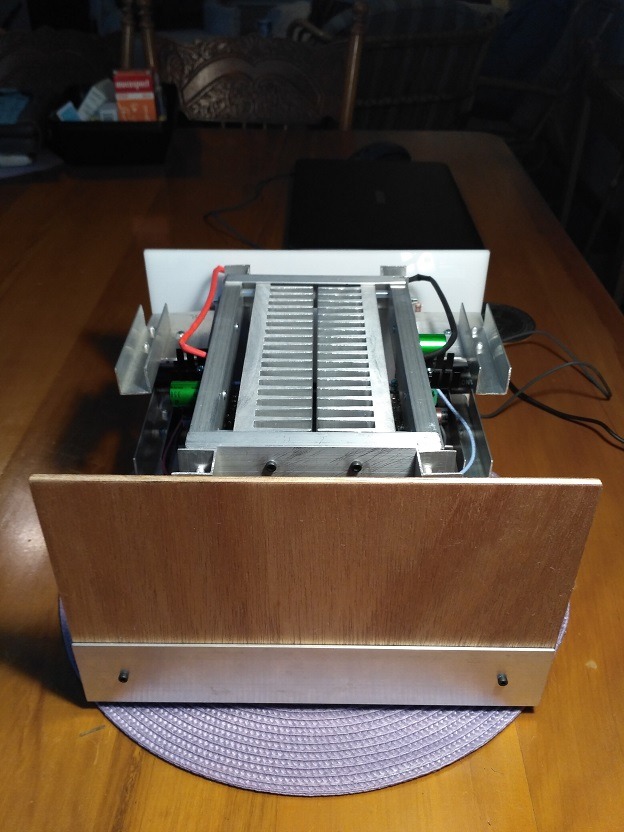

Another AN up and running. It’s been running for a few days now with no signs of self-destruction, which is a great achievement for an amateur like me. Not the greatest looking build, and I am hesitant to post pictures here – but boy oh boy, I am sooo happy with the sound. The enclosure is put together from scrap aluminum and repurposed heatsinks from my ACA amp. The footprint is small, and I could hardly fit the Cap Multipliers inside. Active cooling using two SUNON 92mm fans powered from a separate wall wart. Main PSU is 4 x cheap smps (24V 6A) supplies with 4 x DC DC boosters in series to give dual +/- rails feeding into Gtose/M Johnson Cap Multipliers, one for each channel. All this delivers exactly +/-27V rails to the AN boards. Despite the two fans the amp is running quite hot to the touch. The heatsinks are maybe bit too small, but it is not overheating.

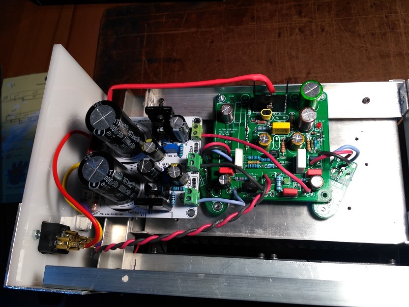

Built using the values and mostly the same components as X's “Proto Schematic As Built Dec 3 2019”, except for V131 and C125/126. For V131 I used BD140, based on further discussions and recommendations from Hugh. For C125/126 (11pF NPO) I used two 5.6pF COG SMD caps stacked (parallel) to give close to 11pF. Between the 4 suppliers (two local and two in the USA) I used, I could not get 11pF NPO or Silver Mica at the time. Currently with Elna Silmic II input caps.
Absolutely no tweaking or adjustments were necessary. Voltages across R111 measures 8.53V and 8.50V respectfully, which sets the LTP bias to 2.57mA. DC Offset measures -5mV and -4mV respectfully. With inputs shorted the DC offset drops to -3mV. I am an extatically happy AN owner!
How does it sound? All I can say is - it just sounds so so musical. Great detail. Great soundstage and imaging. Great control over mid and low bass. I love this amp’s sound.

I really like your innovative build and use of existing components and materials. I think amp chassis made with aluminum L extrusions are super. Two L extrusions and a plywood plank provide a front and rear panel. Add the heatsinks and fans and you are set. Since you are using SMPS and cap multipliers, I would venture to say your amp is absolutely hum/noise free with ears pressed to the cone when no music is playing. In many ways, a hand made chassis from commonly available parts is much more rewarding than a prebuilt chassis that anyone can buy. I’m glad you stuck with it and now enjoying the fruit of your efforts.
