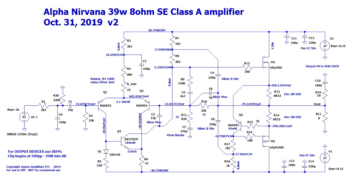

Here is the Alpha Nirvana v2 schematic with Hugh's latest tweaks:

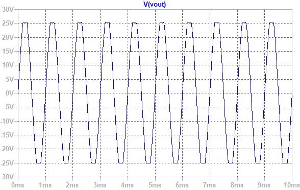

Here is the behavior at clipping - notice how symmetric it is:

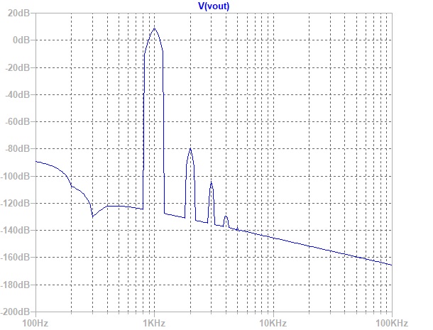

Here is the FFT for 8Vpp into 8ohms:
Here are the distortion components with 0.0039% THD:

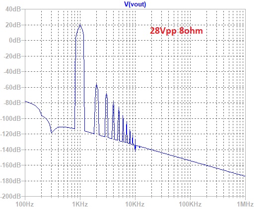

And here is FFT for 28Vpp into 8ohms (12.5w):
And here are the distortion components for 0.016% THD:

Looks like fun!
Question - what about using JFETs for LTP?
Also - is there a way to get more power? Say 100W?
Maybe you could run a pair in balanced configuration for 80 watts, but would be kind of a waste. I ran a pair of F4 stereo amps that way, great way to heat a room but you just don’t listen to 80 watts continuously. The extra watts are good for headroom and a class d or ab is far more practical.

Besides the points that wirewiggler brought up, also bear in mind that doing a balanced bridged configuration will cancel 2nd harmonic distortion, and this amplifier design was specifically tuned for a certain harmonic structure profile (see 1st page of this thread); at which point, it’s not an Alpha Nirvana anymore. Hugh Dean has written about his philosophy with regards to the harmonic profile.
