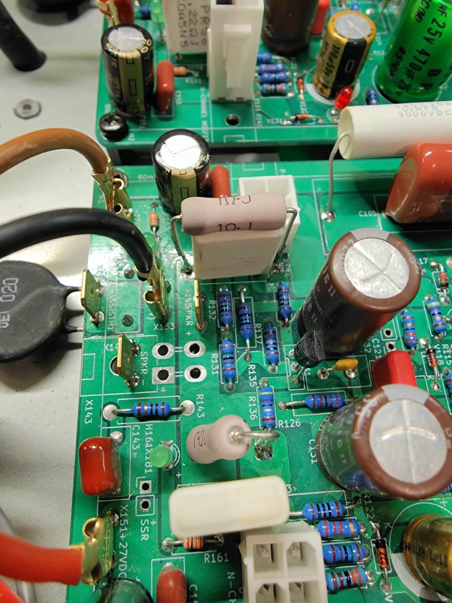

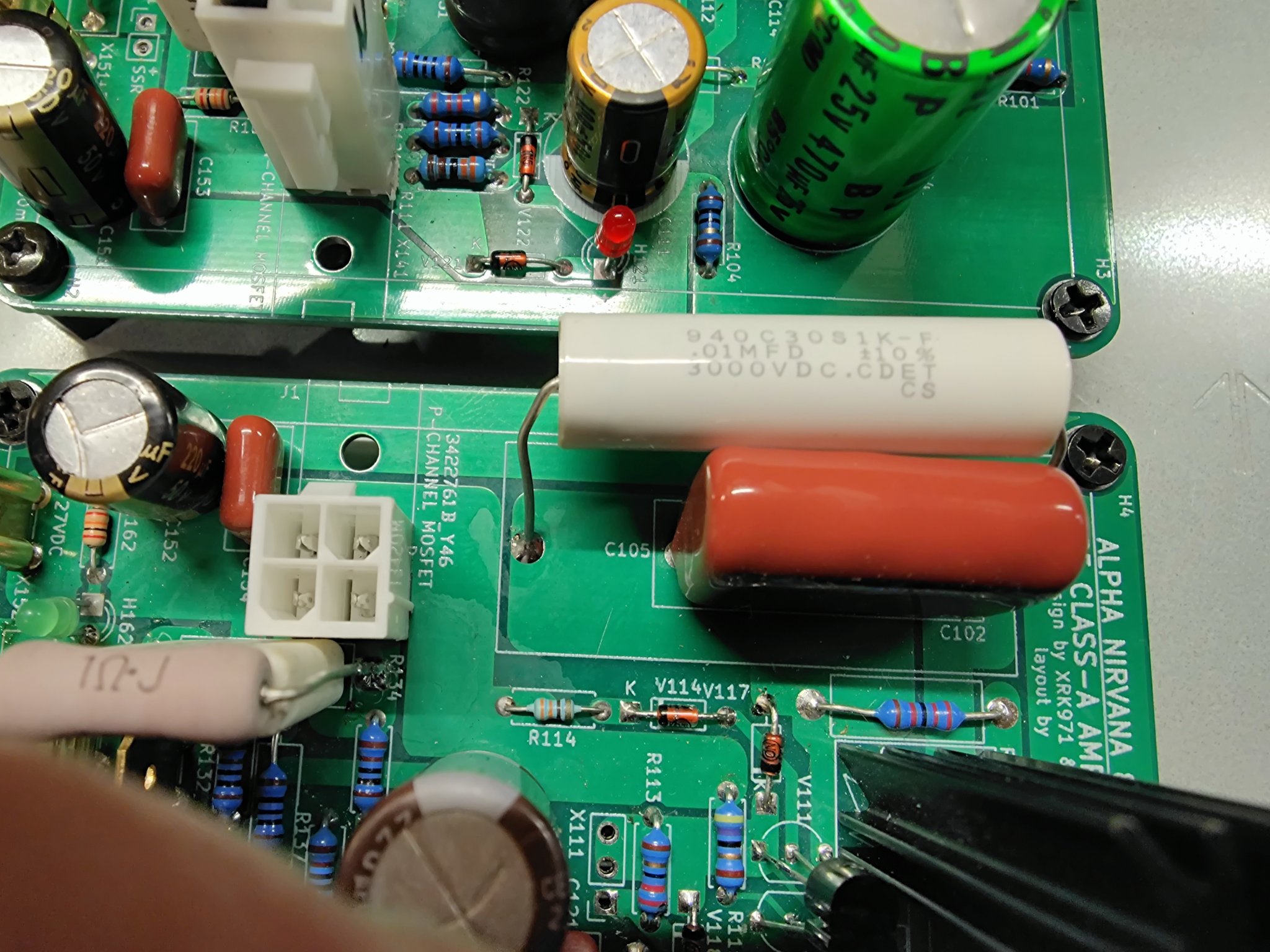

I've upped the ante with my build. Paralleled a 1r over the 0r22 to yield the 0r18 advised by HD for the extra current. Not sure if I'm measuring right but the voltage over the parallel pair seems to have dropped a bit so I don't get the forecast 2.2A. I'm now at about 0.35/0.36V giving 2A.
Thinking on whilst writing this and just been to measure the rails. They are now 27v so have sagged a little more. Maybe this is the reason.
Anyway....playing music nicely again and shall listen. Heat is still very manageable. I added a bypass cap over the input 10uf whilst I had it in bits!.

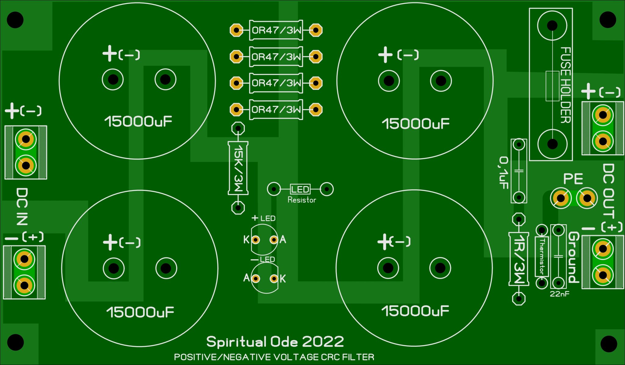

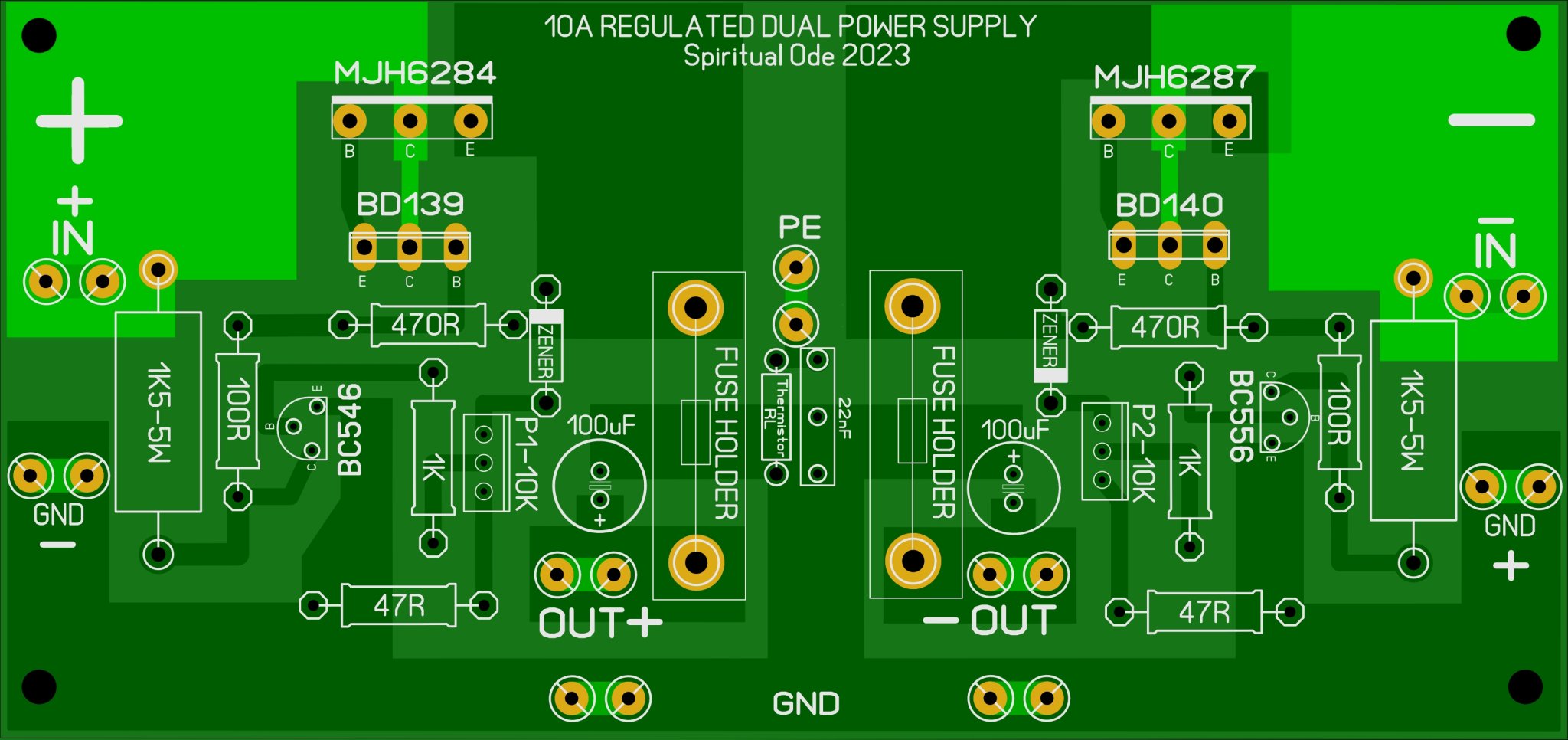

Another critical question is the transformer choice. As I always build in dual mono configuration, I will use 2 transformers with 2 secondaries each. So, two 24V/6A per winding transformers will be OK for my 4R build ( I don't use SLB - I use my own adjustable PS with MJH6284 and MJH6287 for each channel, plus four +-+- CRC boards of diyaudio/firstwatt.

C111 is not critical. It’s just to smooth the voltage above the input stage LTP current source. 33uF to 100uF both work. Just make sure it is rated to at least rail voltage.
Regarding trafos, calculate the quiescent current and power requirement in VA. I like to size my trafos at least 2x to 3x that VA rating so that it operates without getting too hot and voltage does not sag too much.
Usually, under Class A load the nominal no load voltage that is on the rated spec will drop a few volts.
So consider the drop through the CRC supply. Usually a few volts. So I would spec my trafo no load voltage to be the amp rail operating voltage (desired) plus 3-4v.
For example, supposing you want 27vdc at say 3.5A. Thats 95W or 95VA. I would choose a 300VA trafo. Since you need 27vdc at the rail, add 2v sag from Class A operation, add 2v drop through CRC PSU. Thats 27v + 4v = 31v. Divide by 1.4 to get 22vac secondaries under no load.
Or 300VA 22vac trafo (two secondaries). This is per channel monoblock.
If getting a single quad secondary trafo it needs to be 600VA.
Reactions: 1 users

AN 4R edition must operate with +-20VDC/3A QC. So my Darlington PS will drop 3V plus CRC another 2V...........20V+3V+2V=25V / 1.4=17,8V let's say 18. I will order a 24V/8A per winding because I can adjust it to the proper value with the trimpot.
In my previous construction of Lang class A 20W amplifier ( QC=2A), I ordered 2 X 20V/6A trafos and the maximum I could get with my CRC + PS configuration was just 18V with a load. So I had to order new trafos 2 X 25V/6A for an extra 150 euros. AN will be driven by the famous Marantz 7E MkII tube preamplifier. My CRC caps are rated at 10000uF X 4 / 35VDC.
Do you think that 2 X 24V/8A would be OK for AN 4R configuration?

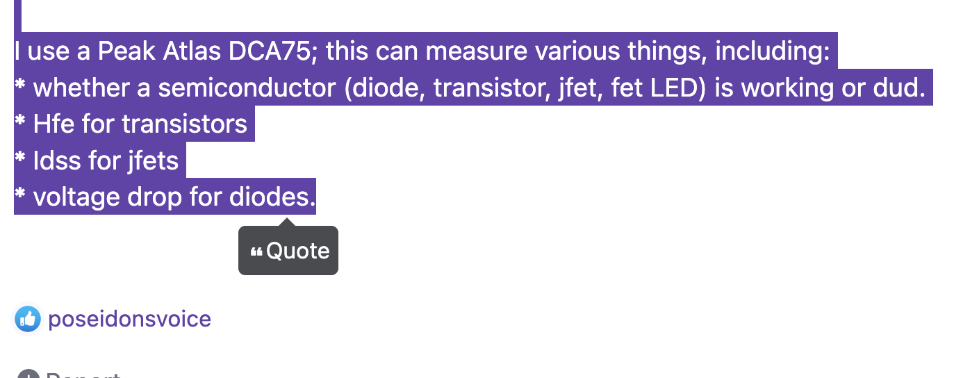

Joined 2019
Null reply. (so I can quote the previously last post).
No need for a "Null reply". Highlight the language you want to quote from the previous post. A "quote bubbler" should appear.
Then, you can do this...
I use a Peak Atlas DCA75; this can measure various things, including:
* whether a semiconductor (diode, transistor, jfet, fet LED) is working or dud.
* Hfe for transistors
* Idss for jfets
* voltage drop for diodes.
