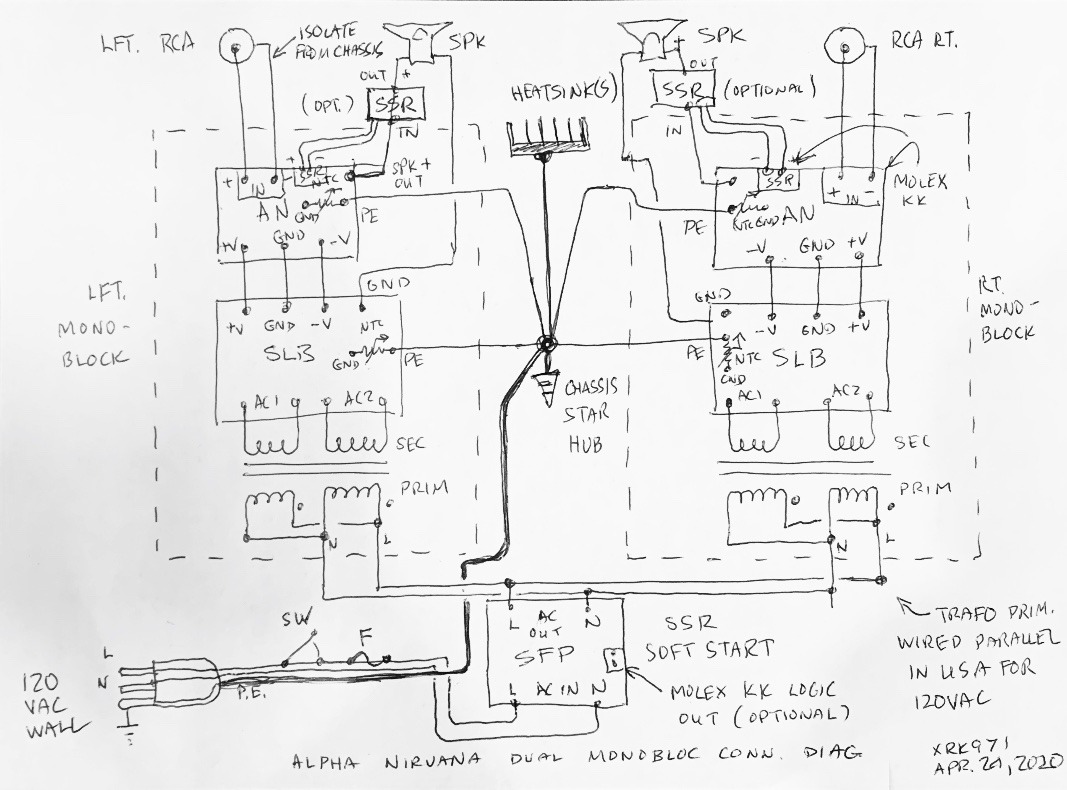

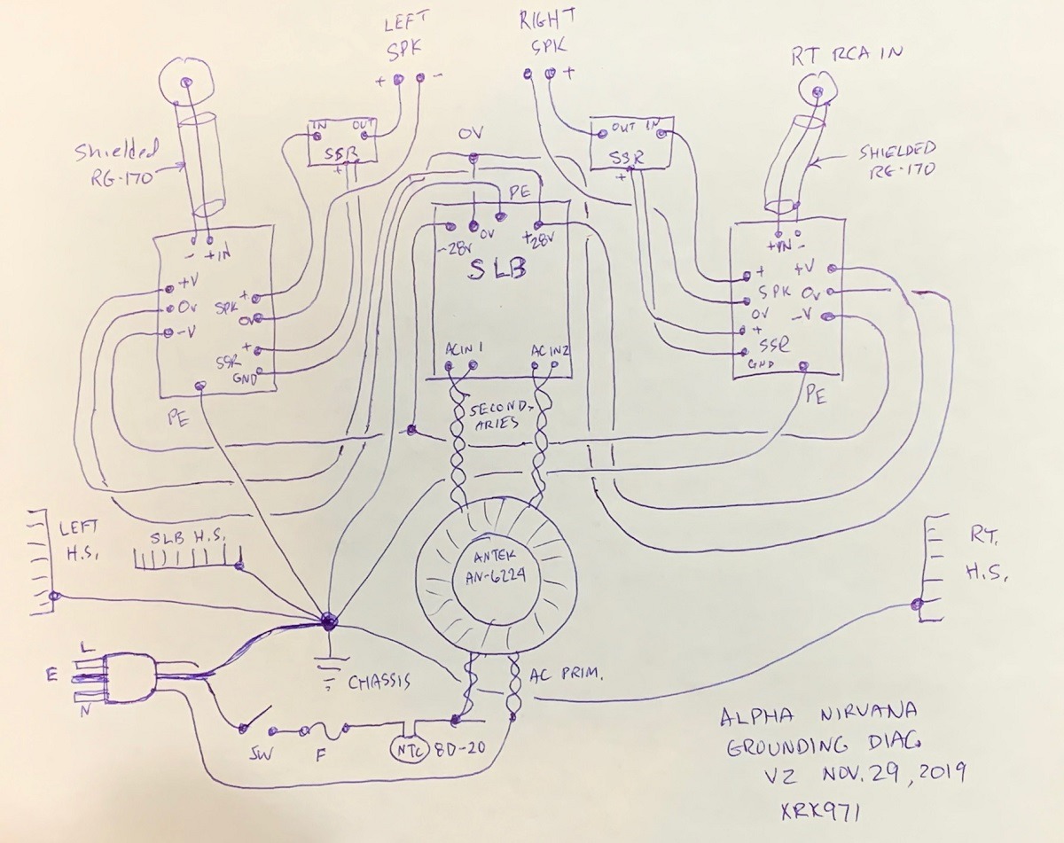

it seems there are two difference connections
Edit Nov 29, 2019 - Grounding scheme schematic (post 279)
and
Edit Apr 24, 2020 - Dual Monobloc Connection Diagram is using SLB and SFP boards:
and
Well found, Nikos! 👍
Your 2nd diagram (the earlier one) is what I saw on the thread ... and that's the way I first connected up my system.
But I now have it connected, basically, like your 1st diagram ... although I'm not using an SFP board. (I use a thyristor, instead.)
In other words, the spkr -ve now goes back to the SLB ground. However, I don't - unlike that 1st diagram - have the AN4R PCB connected to mains earth (via the 'safety earth bolt on the case).
