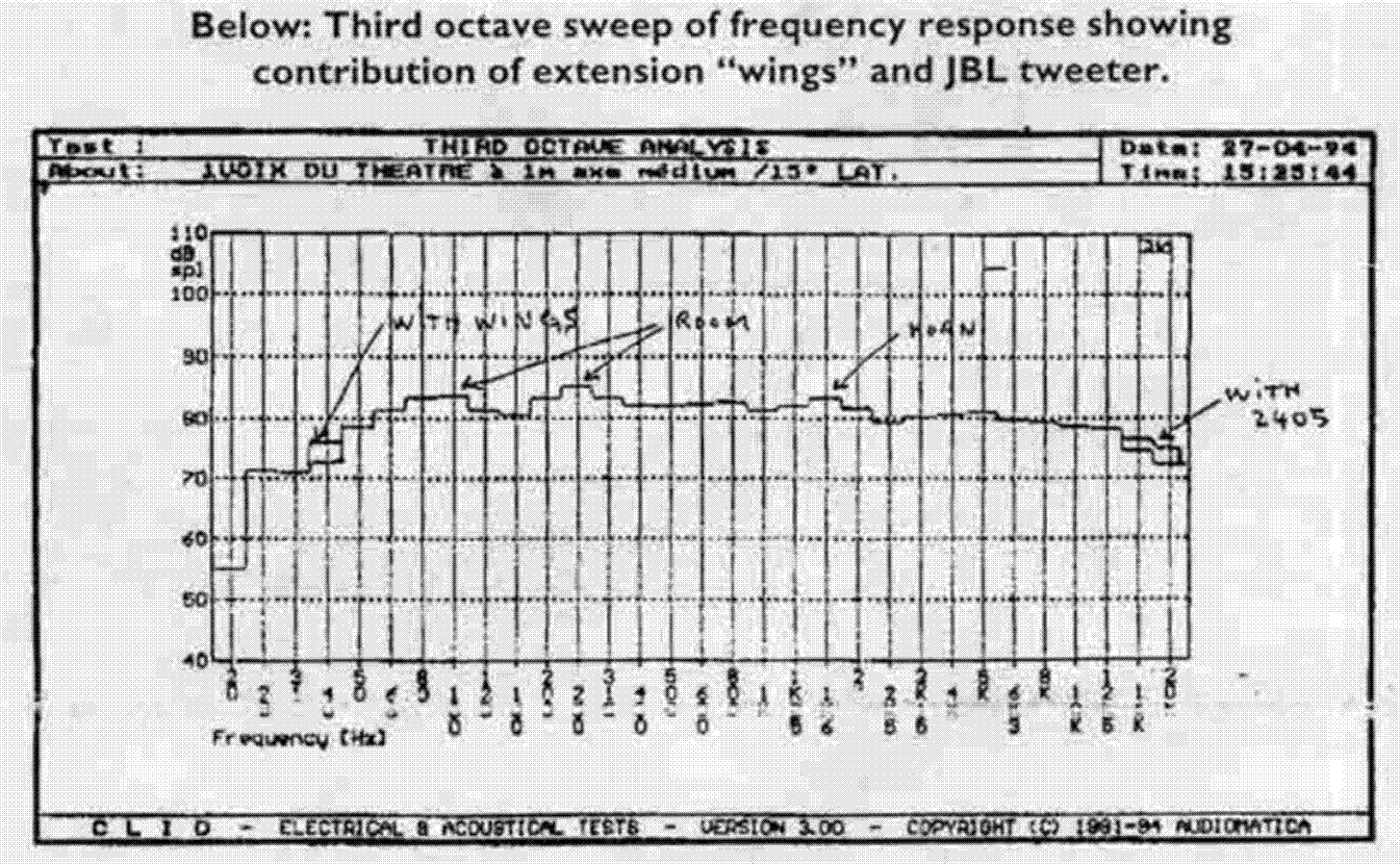

Jean Hiraga's A5 XO, wings, super tweeter horn response
Jean Hiraga's A5 XO, wings, super tweeter horn response:
GM
edit: Hmm, shrinking its size a bit works, but its 186 KB original size is below the 195.3 KB limit and its width/length is only a small fraction of the limits, so don't understand all I know about this........

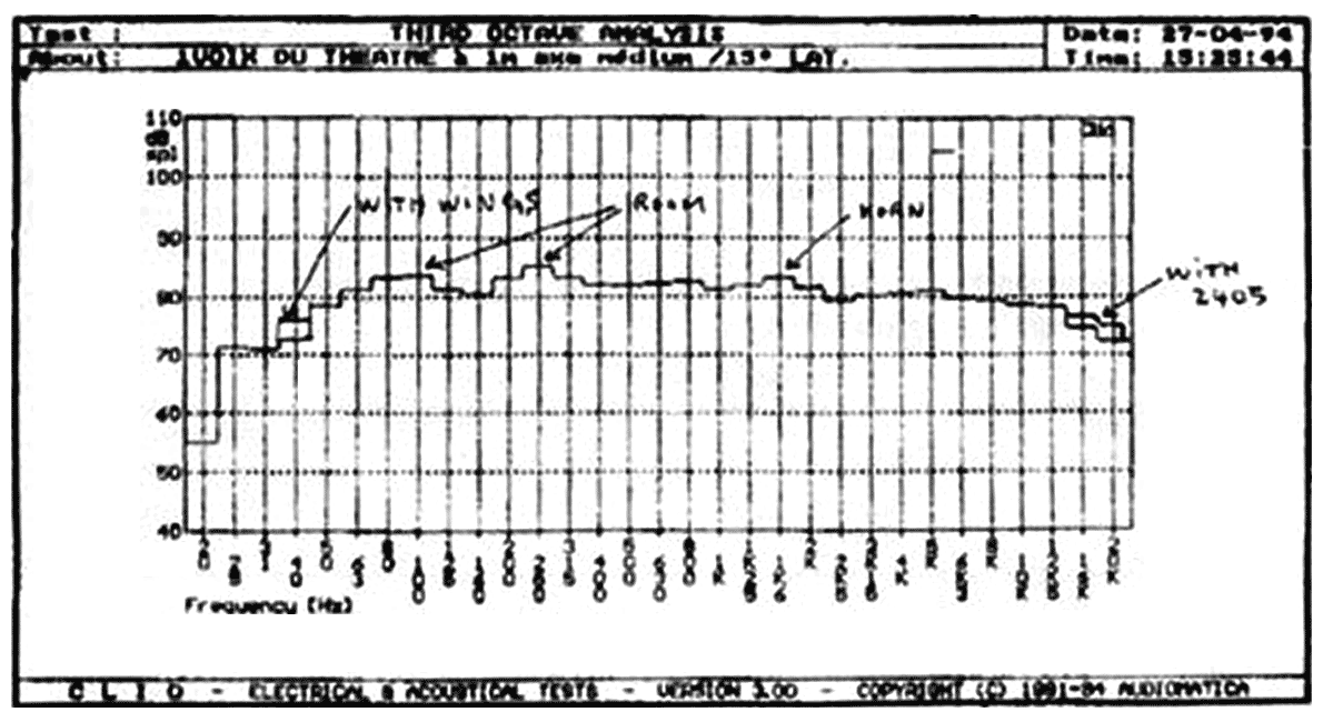

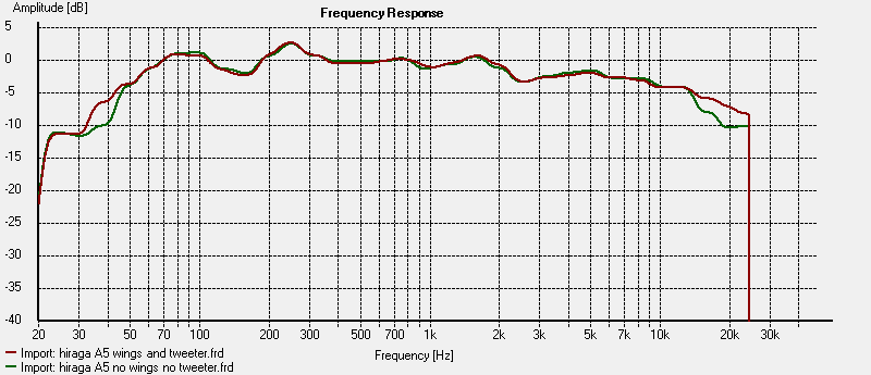

The graph didn't clean up much, so I traced it and smoothed it a bit.
2 versions below.
Not clear which system this is a measurement of, Hiraga's or Stronczer's.

This is very similar to what I get with the same system, despite the crossover is a bit different. Concerning time alignment, I cannot go to 9 inches. On my system, the CSD mesured with Arta (confirmed by listening) is showing that 4 inches back is the best. I am using a 291-16A and not a Westrex...

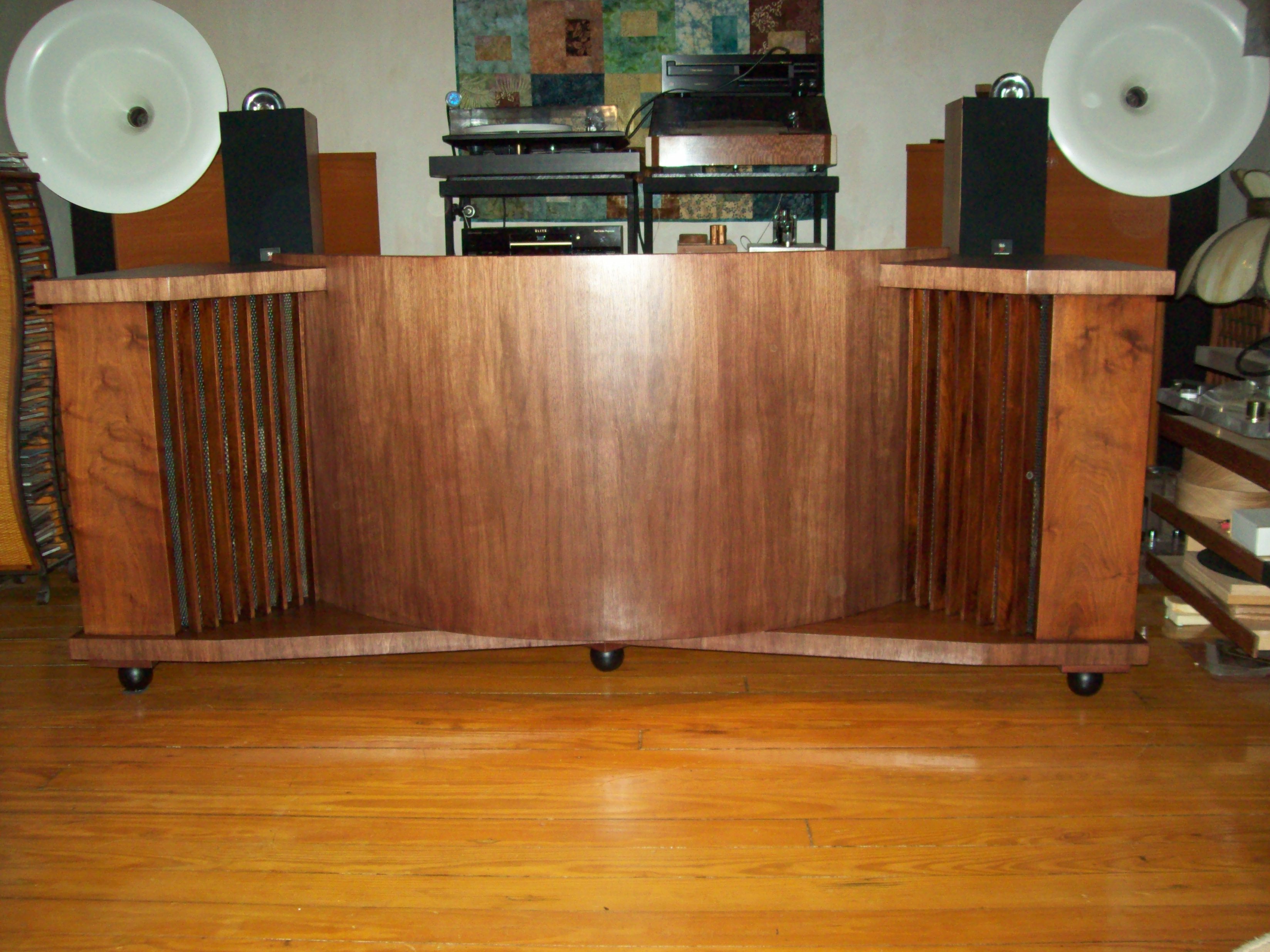

@ Limono, That is a Metregon isn't it ? The Paragon's baby brother. Nice !
I always wondered what drivers were in those.Are they 12" or 15" woofer's in there?
