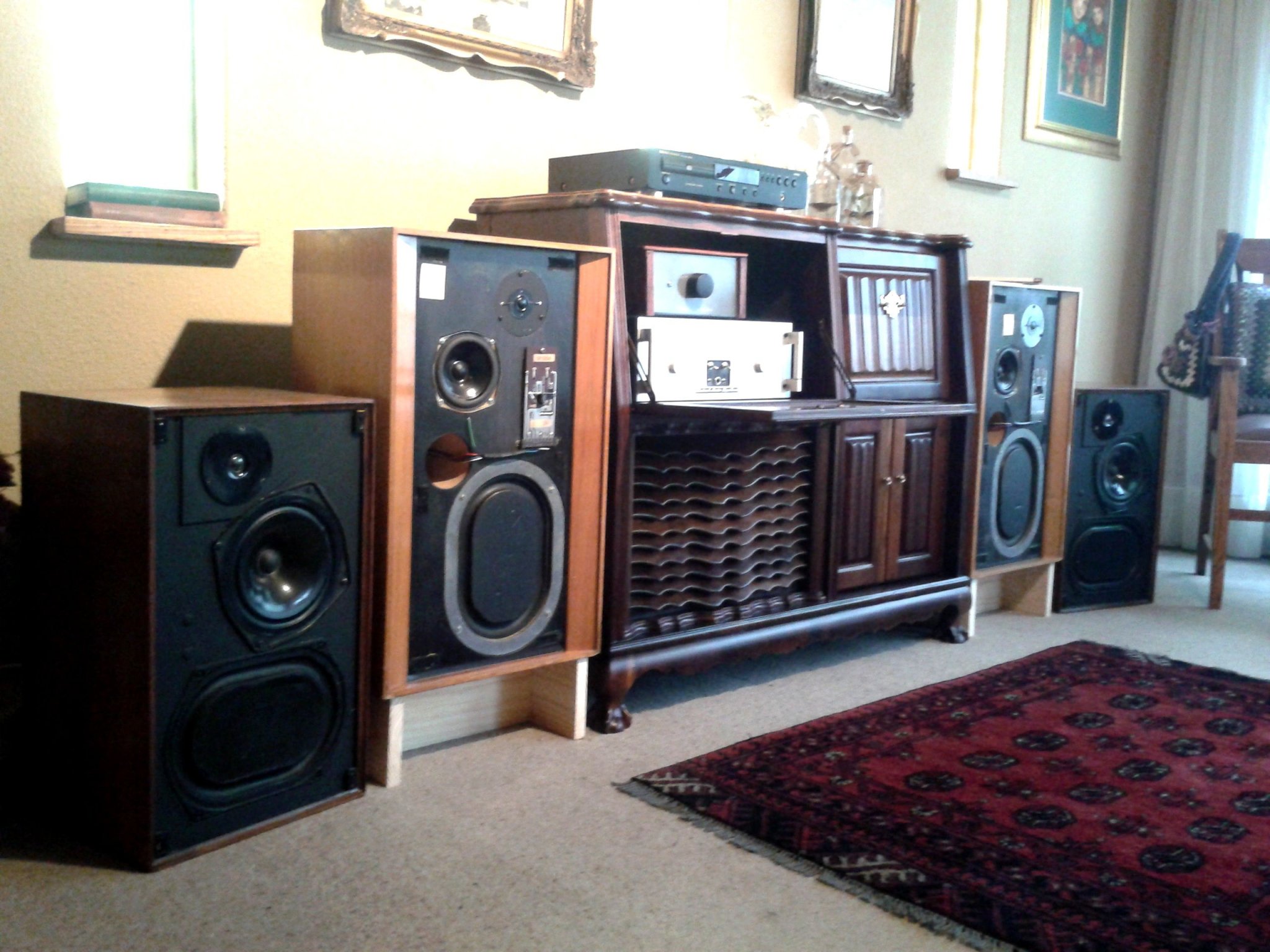

I like the Celeste for applying aluminium to the bass mid driver. In the sixties already.
https://www.diyaudio.com/community/...loudspeaker-sandwich-cone.402917/post-7762244
