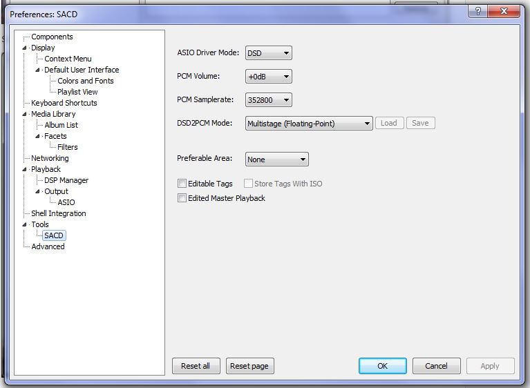

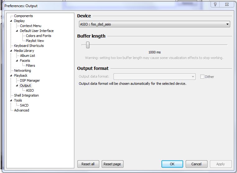

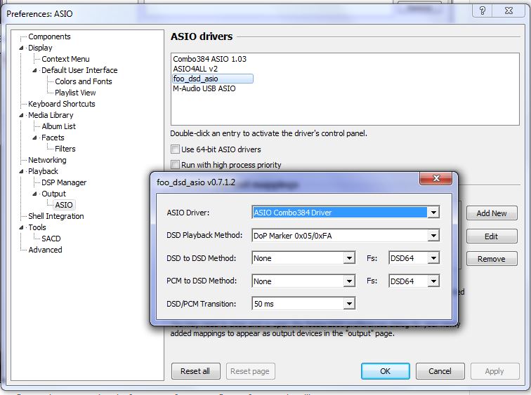

I hope you don't mind me asking this question its sort of relevant:)
I have just rebuilt my BIIISE DAC & added the Acko Isolator to the Amanero output & update the Amanero firmware and driver, but for the life of me I cannot get Foobar to play music using any of the ASIO Output Devices.
I can play music using the WASAPI Output Devices.
I have attached some screen shots in the hope somebody can spot a problem with what I'm doing.
PS: The Amanero work in the past using ASIO Output Devices before I did the updating.
I used the factory standard install 1080 it's the top of the list in the firmware install program, I'm not re clocking, not yet anyway, just using the board as an isolator
Fixed :)

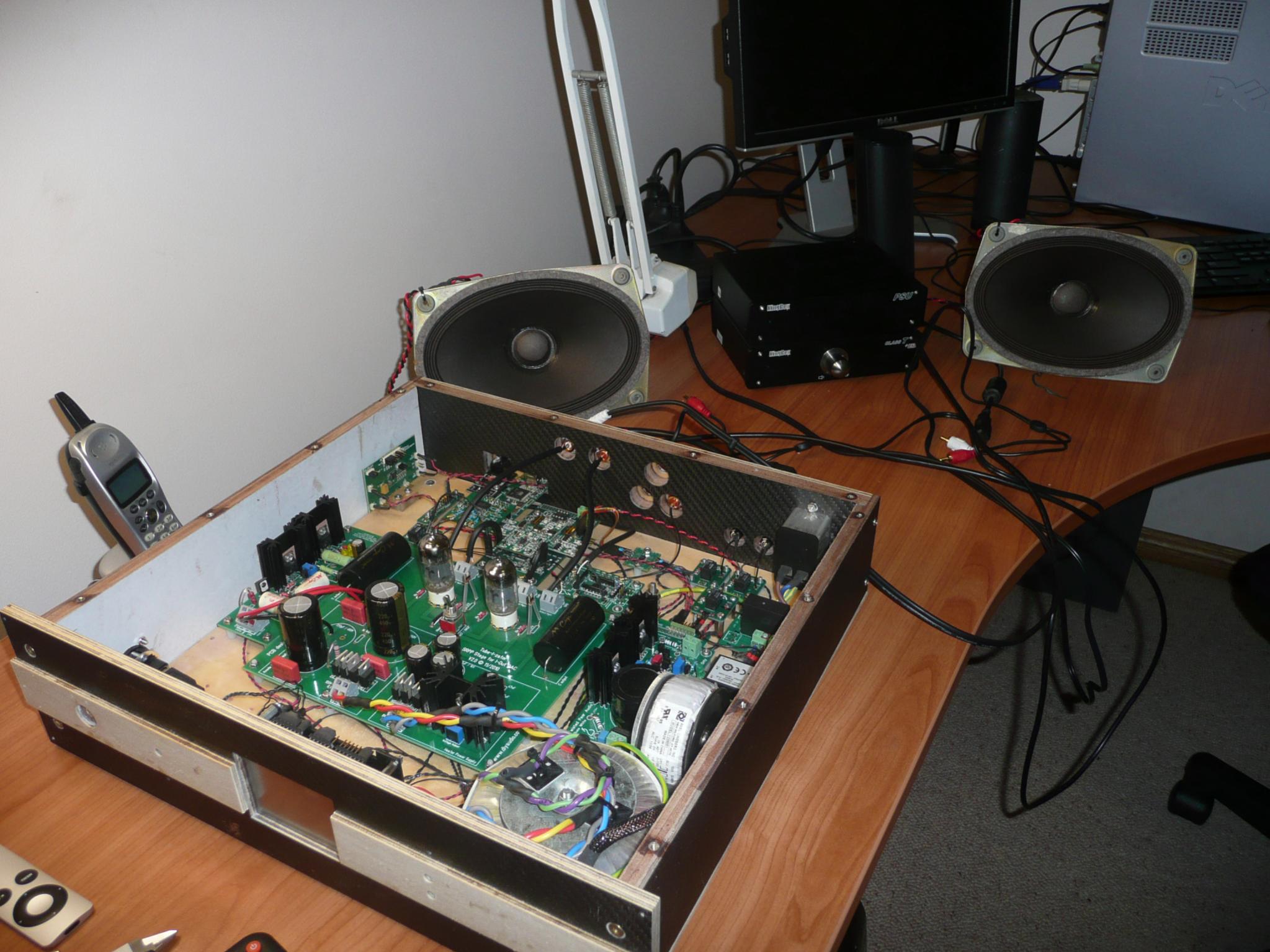

Unfortunately sound I cant really comment on as I've only every played the real Hi Res via my test setup you see in the photo :)
To play the Hi Res I need to play it directly from my computer & my main system is rooms away from the computer.
The signal has been rock solid once I worked out which Driver-Device to use etc
The whole software-driver side seems a bit flaky as I could only get Foorbar to play the music when I used the Foo_dsd_asio device, the Amanero & ASIO4ALL devices wouldn't work.
