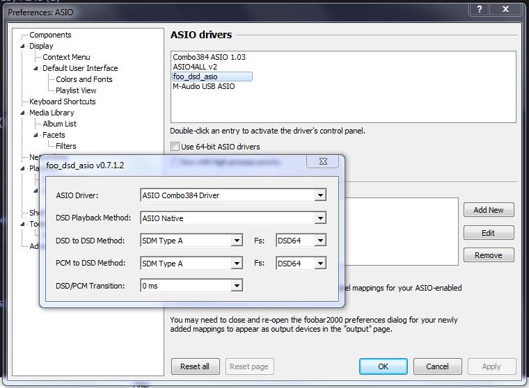

for what it is worth these are the settings I am using in Foobar;
Thanks, I see that it is DSD and yes this needs ASIO.
What about the DxD music that appeared on your display? I would think this could go direct with KS or WSAPI
TIA
TIA
You could quickly end up bald doing this!!
DS, only seems to play 44 & 96 but the BIII doesn't display the right sample rate, it displays 192 PCM
KS, plays 44 & 96 and the BIII displays the correct sample rate,
KS, also plays DSD64 & 128 but Foobar is putting it out at 44/5645kbps & 44/11290kbps, the BIII just displays the 44
KS, also plays DXD PCM 352/16934kbps and the BIII displays PCM 352
WASAPI (event), plays 44 & 96 and the BIII displays the correct sample rate,
WASAPI (event), also plays DSD64 & 128 but the but Foobar is putting it out at 44/5645kbps & 44/11290kbps, the BIII just display the 44
WASAPI (event), also plays DXD PCM 352/16934kbps and the BIII displays PCM 352
WASAPI (push), does the same as WASAPI (event)
ASIO: Combo384 ASIO 1.03, works just like KS & WASAPI when set as PCM in the SACD tools section
ASIO: Combo384 ASIO 1.03, wont play DSD when DSD is selected in the SACD tools section, it will play the DXD as PCM 352 and will play the lower sample rates.
ASIO: Foo_dsd_asio, will play bloody everything when set as I shown before and all displays are correct
Stop Press:
ASIO: Foo_dsd_asio, will play ASIO Native when setup as per the image, it will play with FS set from DSD64 To DSD512,
PS: you may need to open and close Foobar & possibly even turn the DAC on and off if you strike trouble, I only turned the DAC on & off once during the testing & the tests where short.
Stop Press:
