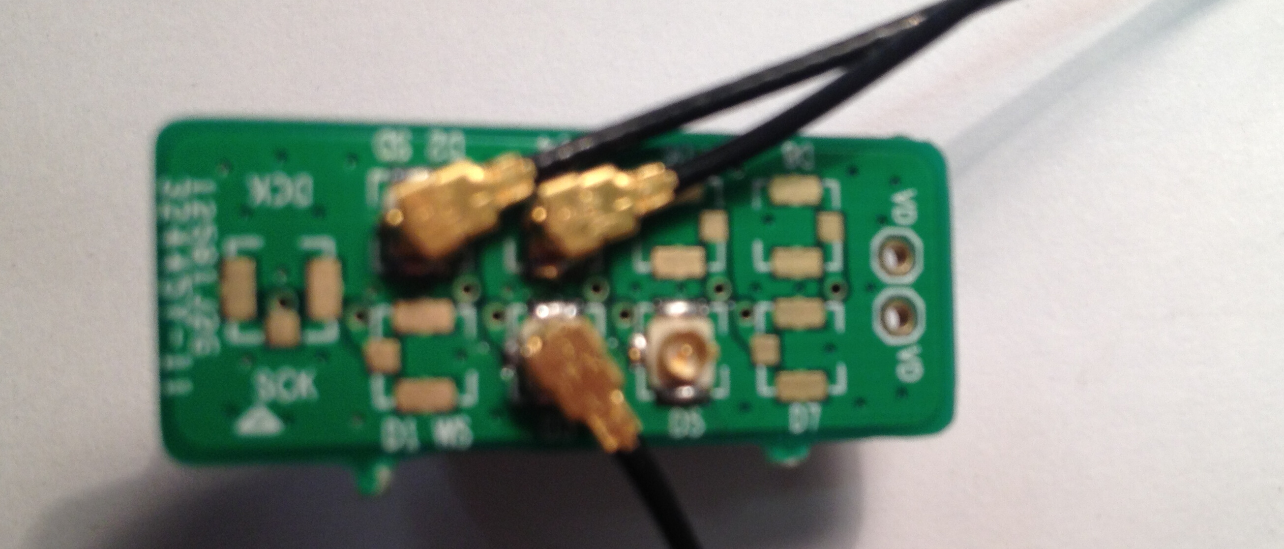

View attachment 365484 This is what makes it work, or at least a longer cable from the Si570 to the BuffaloIIIse.
The route for Si570 MCK through the acko AKL-AMN-S03 is longer than the route for Si570 MCK->BuffaloIIIse.
So a longer cable Si570->BuffaloIIIse compensates for the delay.
Worked.

Is the little board pictured from Ian?

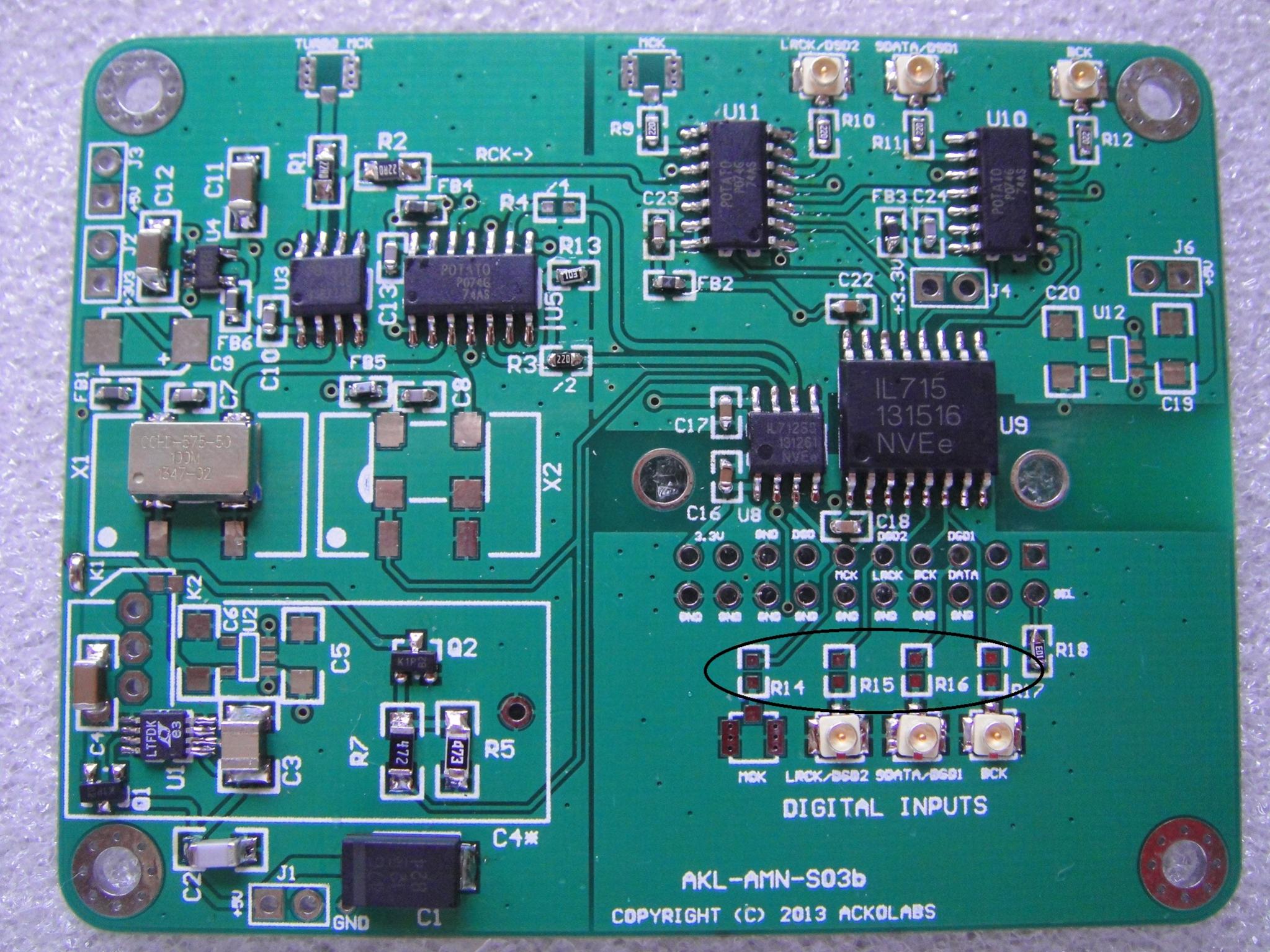

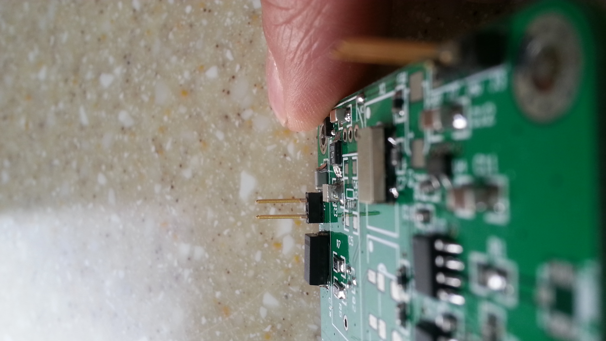

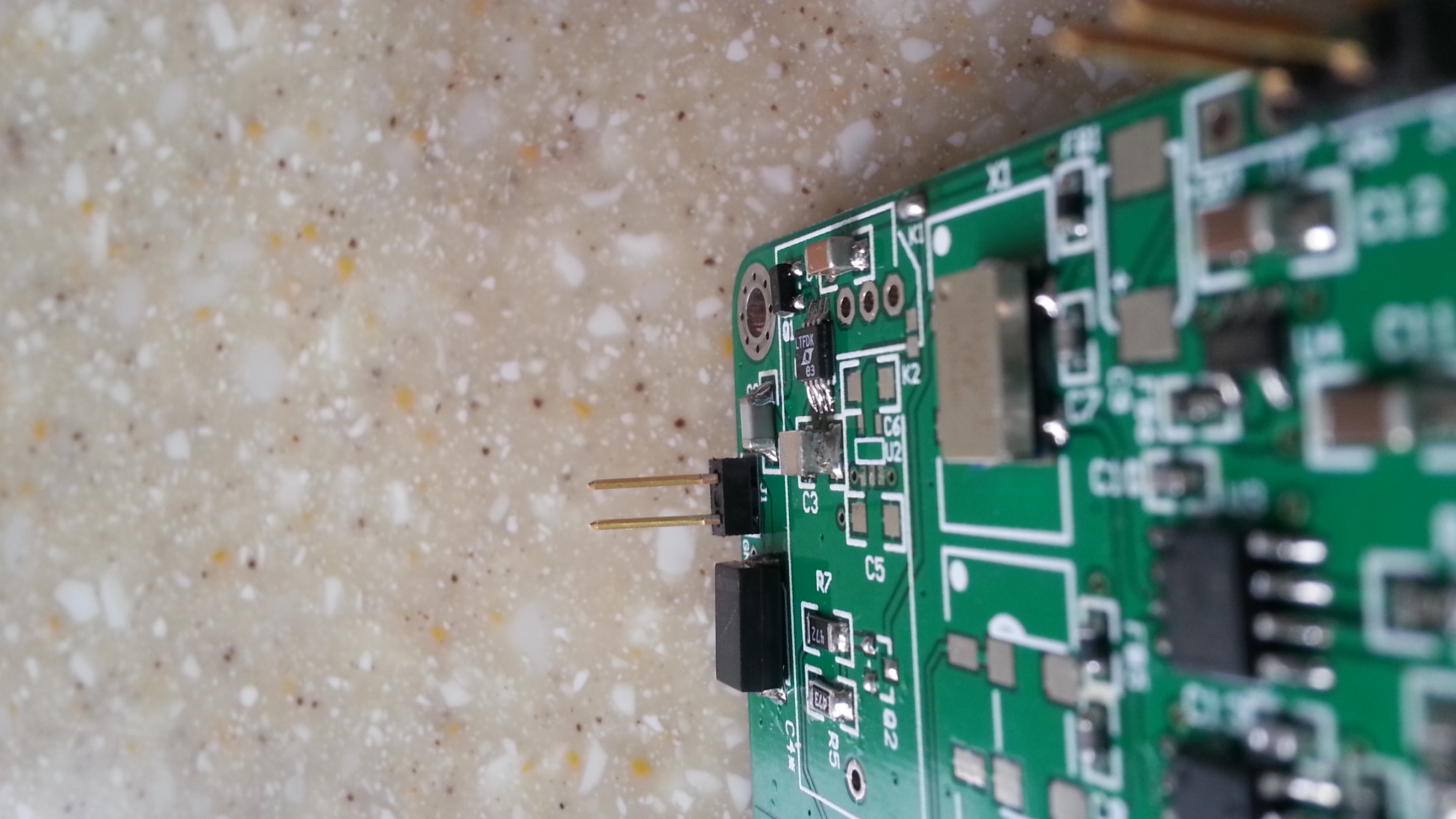

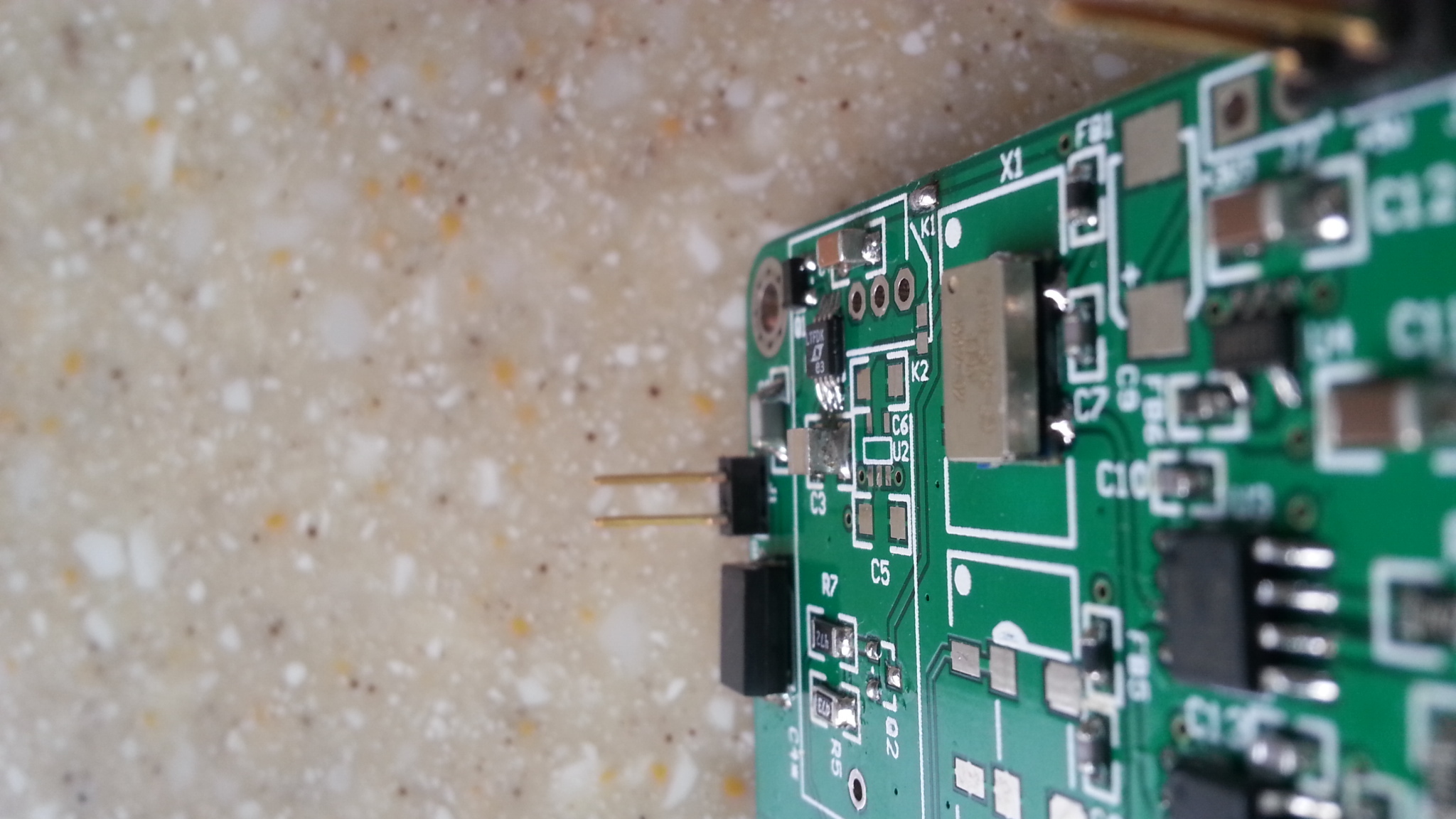

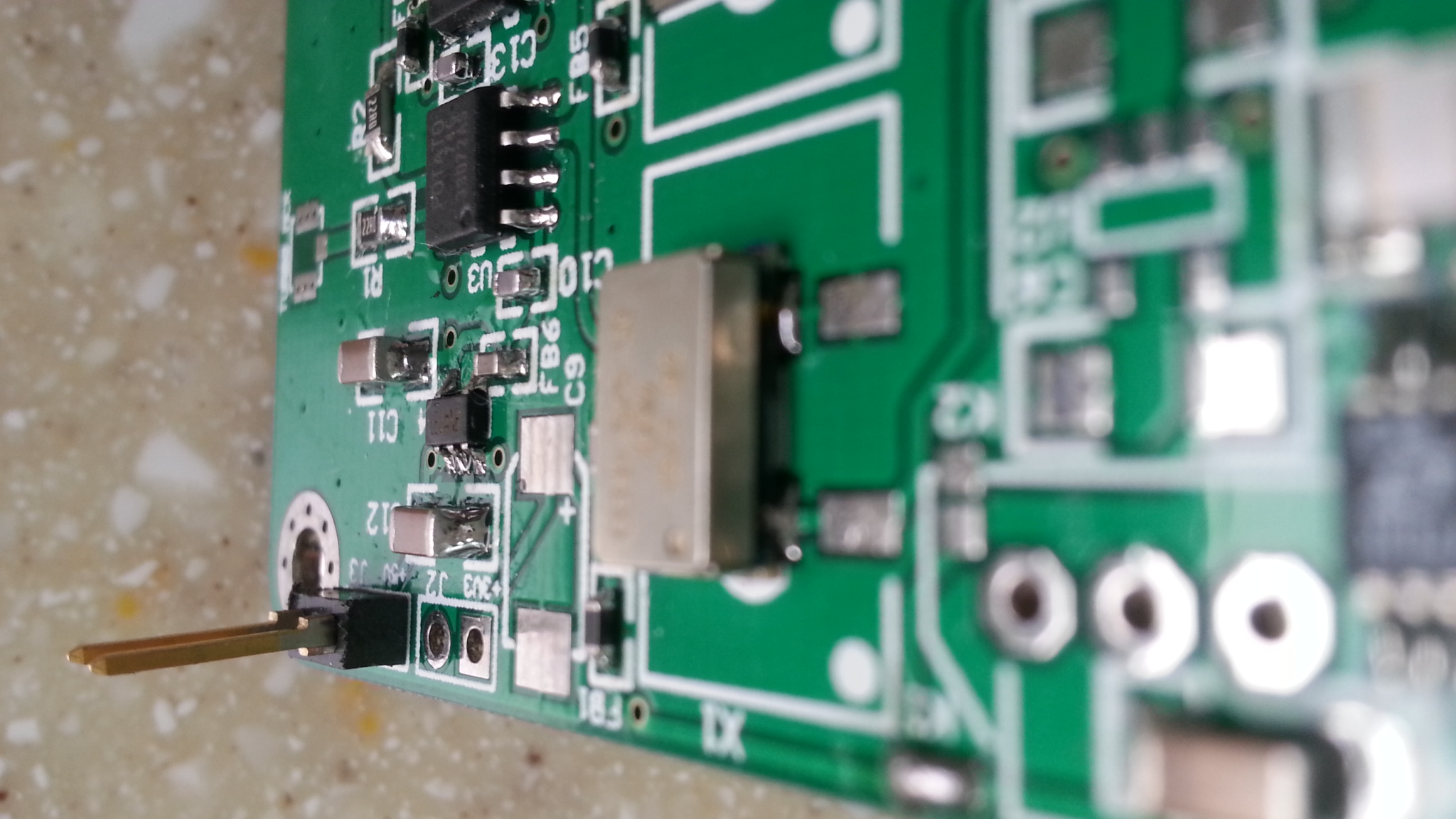

I need some help with the reclocker board
Hi Acko,
I quote the post of palmito because I want use this configuration with my Doede's dac but I can't make it play music.
Today I complete the board with the following setup:
J1 - dedicate +5V
J2 - not used
J3 - dedicate +5V
J4 - +3.3V from the dac
J6 - not used
R3 - 0R
R4 - not used
I check all the voltage as per schematic and are all there.
You have any particular advice fot help me with the troubleshooting?

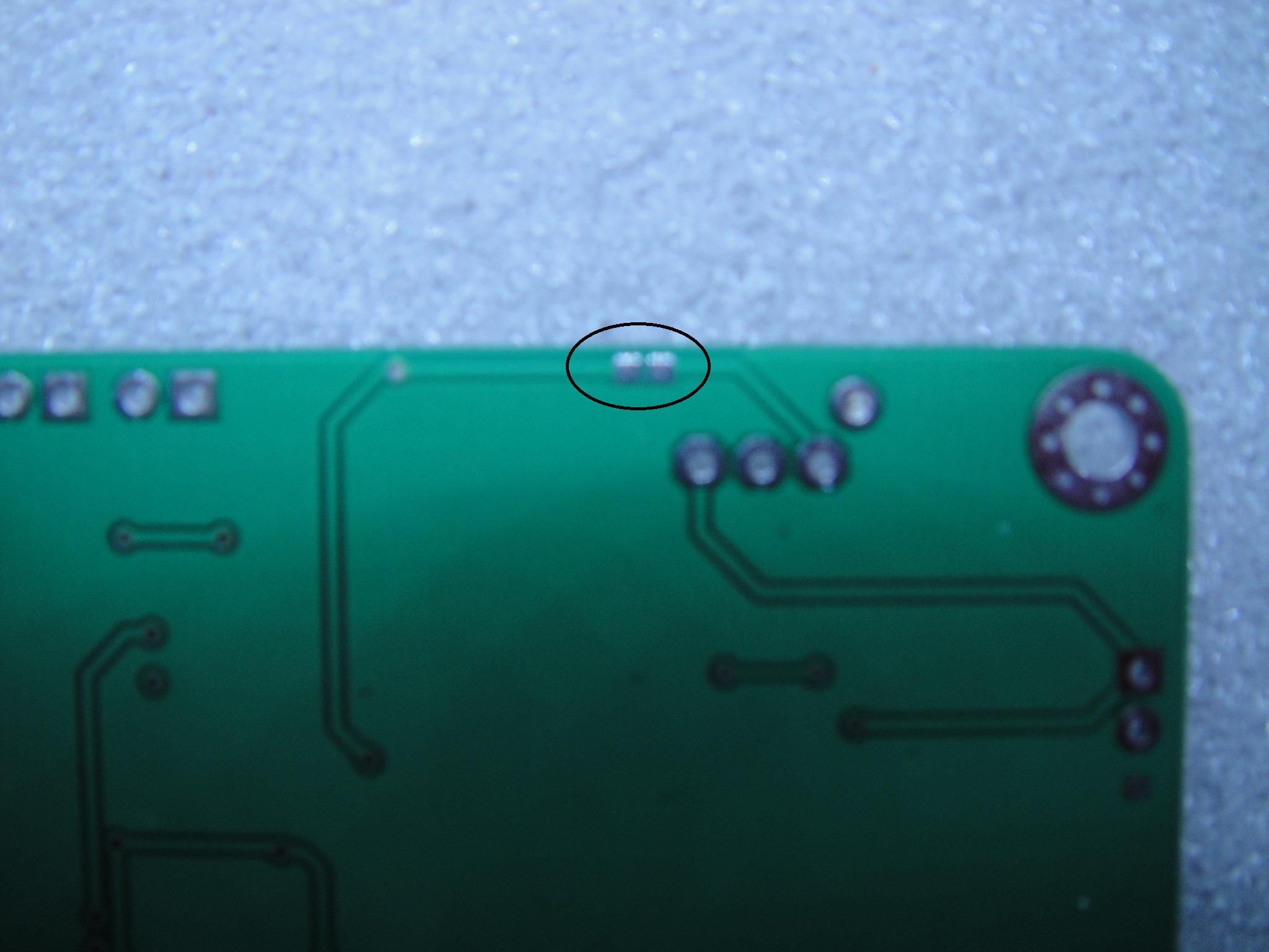

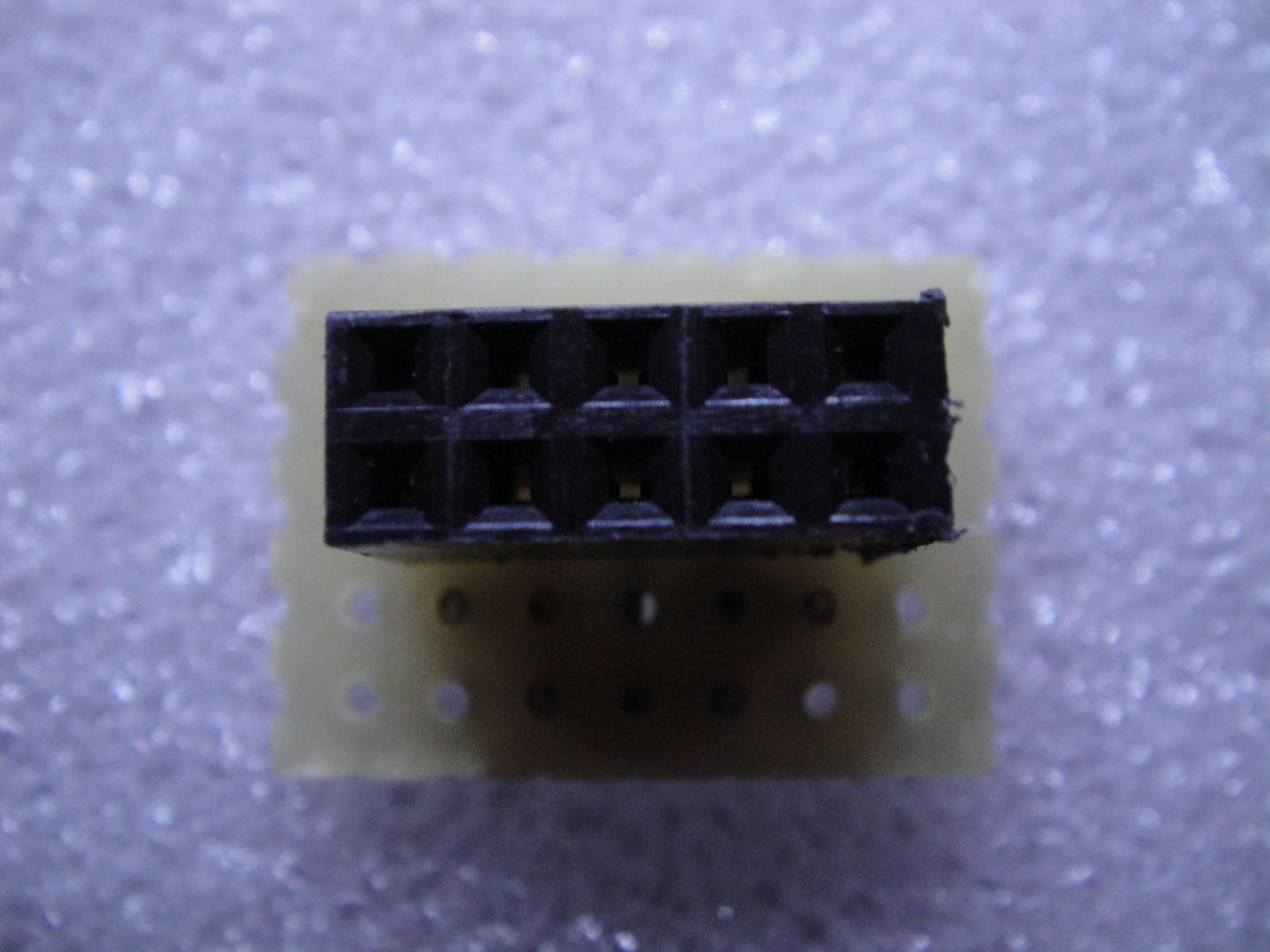

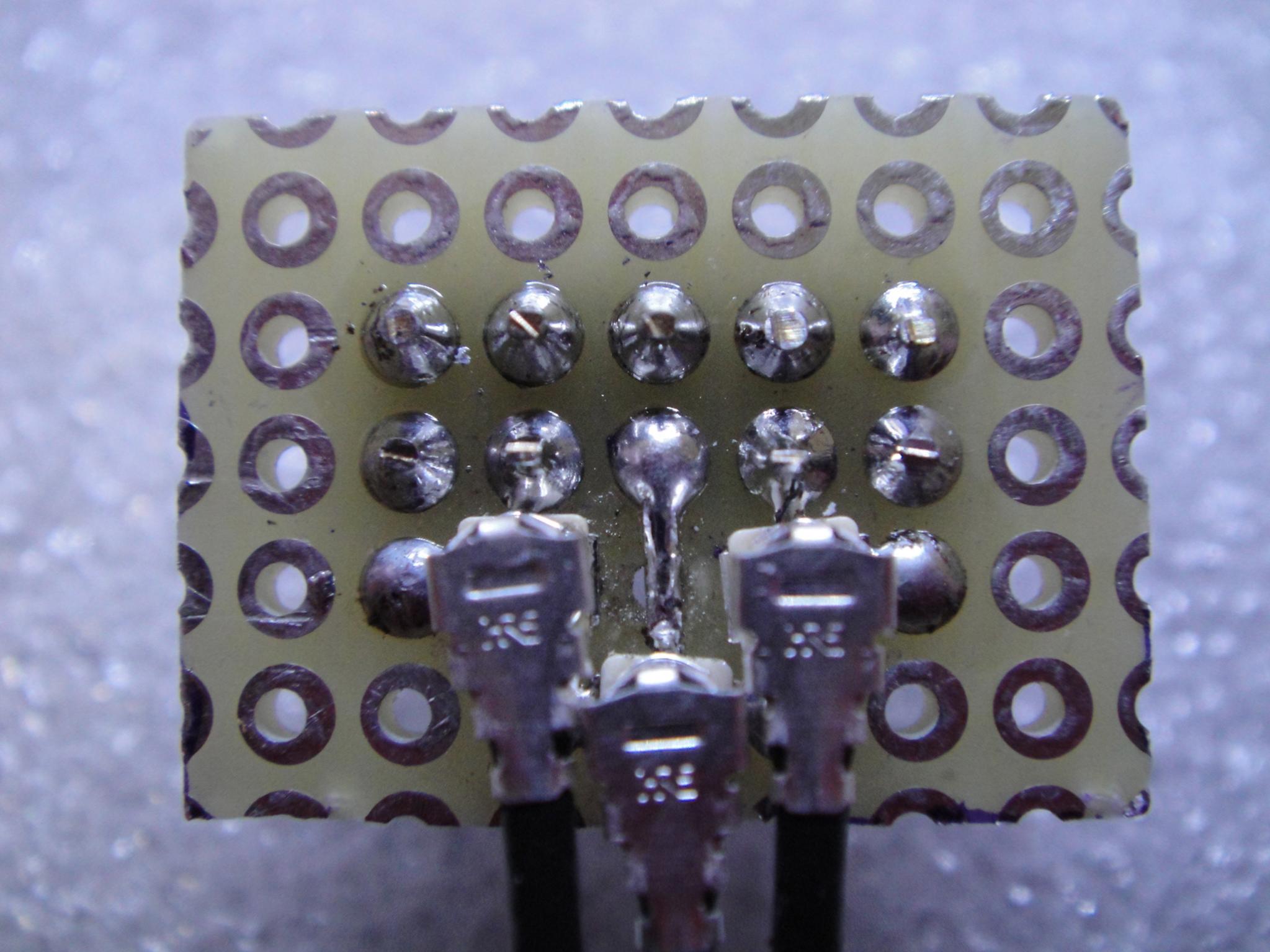

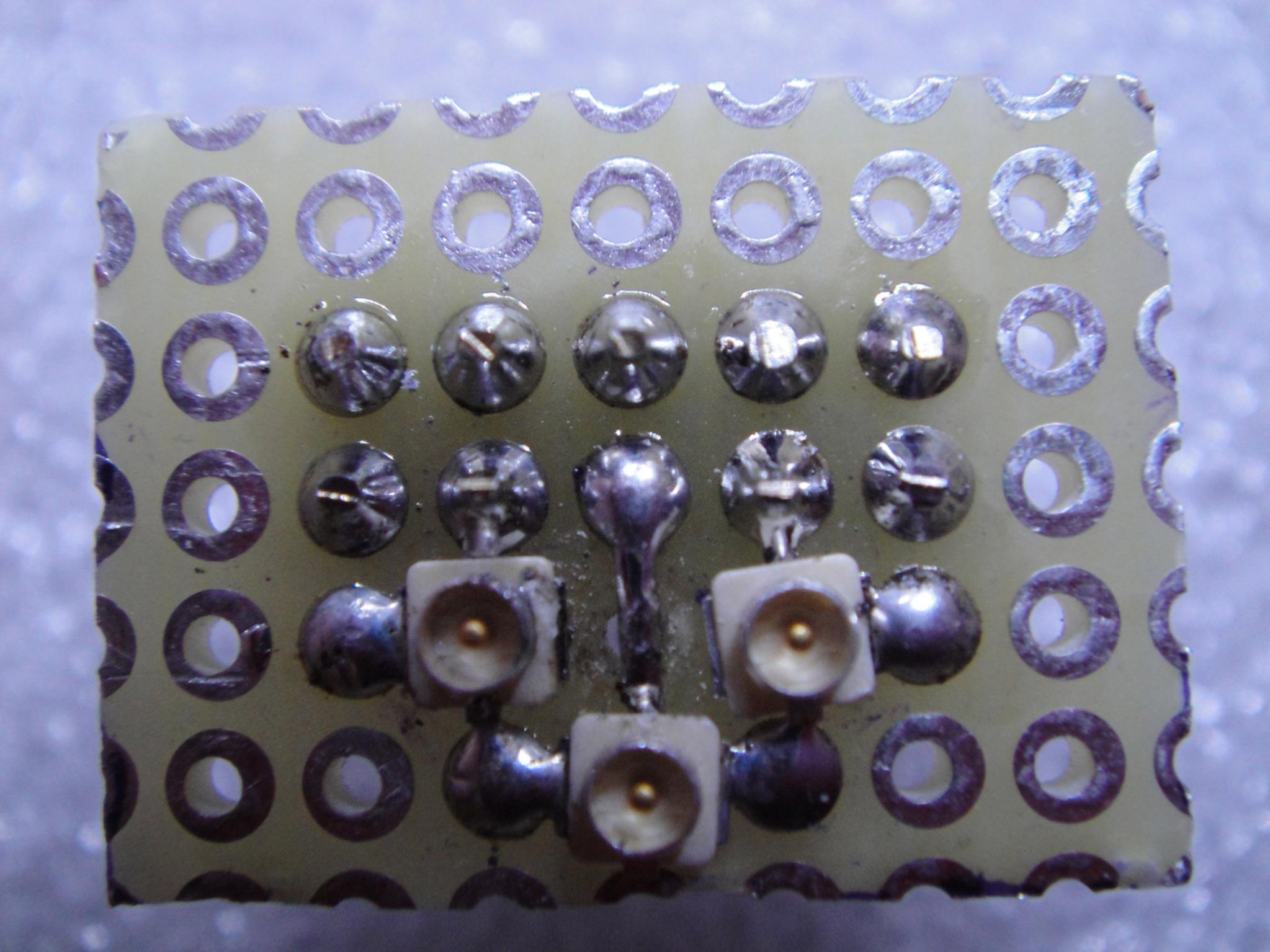

I attach few pictures of the board and a small adapter for the dac input. I tested the adapter with the ohmmeter and look fine.
In one picture I highlight a small bridge behind the board. I don't think this should shorted ?
Thanks and Regards,
Enrico
PS: I reconnect the i2s directly from the rpi the DAC is working fine.

HI Acko,
Q2 removed but still 4.65Vdc.
I check the soldered pads and looks fine. If can help I can try to take some macro pictures and send you
Is the first time I use the XO and I solded it like the others smd components with the smd station... any particular advice to install it?
Thanks for your time
Enrico
ehmm... unfortunately I don't have any XO spare.
When I ordered the material to mouser I added some spare as usual but not the XO... 30 usd seems too much 🙁
Well I will buy a new one... any advise for soldering the new one?
I will try now to desolder and re-solder the old one... 250 degree are ok for the air gun to desolder it without destroying it?
Thanks again Acko for the time you dedicate to my problem.
