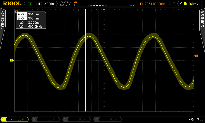

I have a Rigol 4024DSO available, which has 4 GSamples / s with an upgrade to 500MHz bandwidth (probes are rated as 500MHz bandwidth, too).
I also thought about measurement failures but if you compare the graphs below it seems strange to me:
1) The 100MHz signal at the FF (pin 3)
Best Wishes,
Hermann
Thanks Hermann,
Your equipment is top-end and 500MHz BW should render 100MHz square wave nicely.
We are seeing distorted waveform even coming from the oscillators
![scratch :scratch: :scratch:](https://files.diyaudio.com/forums/images/smilies/scratch1.gif)
Have you checked your probe tuning?
Are you able to connect scope to another source of 100MHz square wave, say, from a signal generator?
Unfortunately my scope is only 50MHz but I have done indirect tests on the clock signals using a dc meter and the avg shows ~1.6V which means close to a perfect square wave for 3.3V switching @50% duty cycle
