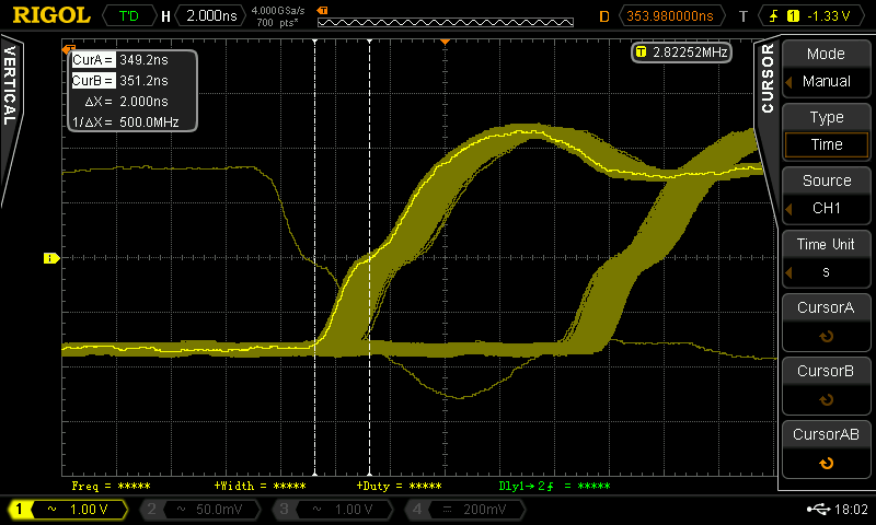

Thanks for the idea, I just tried it, but the results did not change. Here you see the waveform / jitter of the I2S signal before the FF where there's a 2ns jitter but with no jitter "in-between":

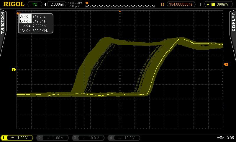

And here's the waveform after the FF, whereas the 10ns jitter can be easily seen but also with a jitter of approx. 2ns whereas I bridged + disabled the buffer as you recommended:

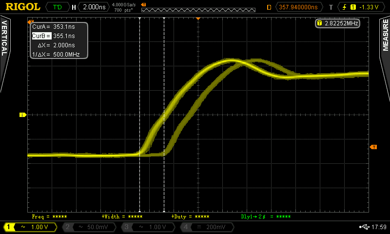

And here's the same with the buffer:
I personally can't see any real difference between the two waveforms (except that one is triggered on the rising edge, the other on the falling, but that makes no difference).
What may be interesing is that it seems that it is a "minority" of signals that build up this 2ns jitter, so it seems (have no idea how to measure it, unfortunately), that statistically, maybe 80-90% of the signal has a far lower jitter than 2ns.

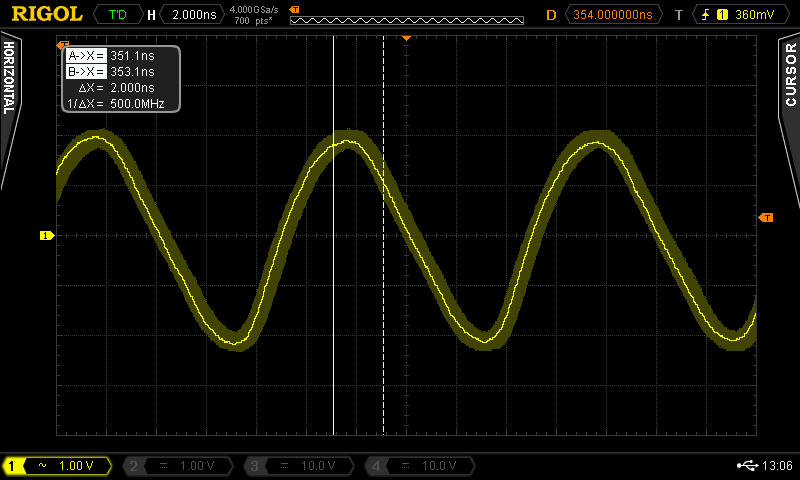

A look at the 100MHz input of the D-FF shows that the signal is clean but not rectangular, which maybe could be an explanation to the jitter?
It's interesting that the signal before the buffer right at the quartz looks quite similar, maybe even cleaner:

What is the bandwidth of your scope?
I have a Rigol 4024DSO available, which has 4 GSamples / s with an upgrade to 500MHz bandwidth (probes are rated as 500MHz bandwidth, too).

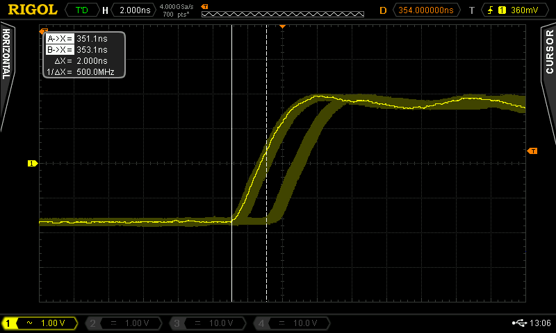

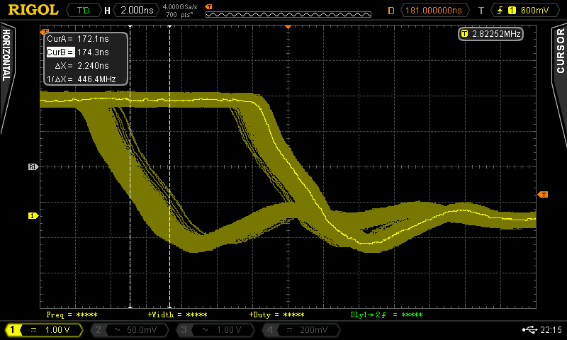

I also thought about measurement failures but if you compare the graphs below it seems strange to me:
1) The 100MHz signal at the FF (pin 3)
2) The BCK signal before the FF (pin 2)
3) The reclocked BCK signal at the FF (pin 5)
On the reclocked signal it seems that most of the signal is below a jitter of 2ns, but as I enabled the display persistence to maximum, the scope records all signals, so the jitter picture is "building up" as can be seen at the edges of the signal..
I used the same setting for the display persistence for the other two signals above, but these signals look very clean to me, the remaining jitter there may very well come from the limitations of my scope, however, for the last picture I doubt that this has something to do with it.
So, for me there are two possibilities:
a) There's really something weird going on in the FF (btw., the FF seems not to be broken as the second FF, used for the LRCK signal, shows the same results, unlikely that they both broke).
b) There is some side-effect which leads to measurement errors and lead to such a picture which I don't understand.
