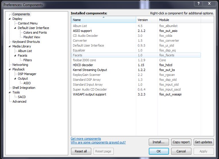

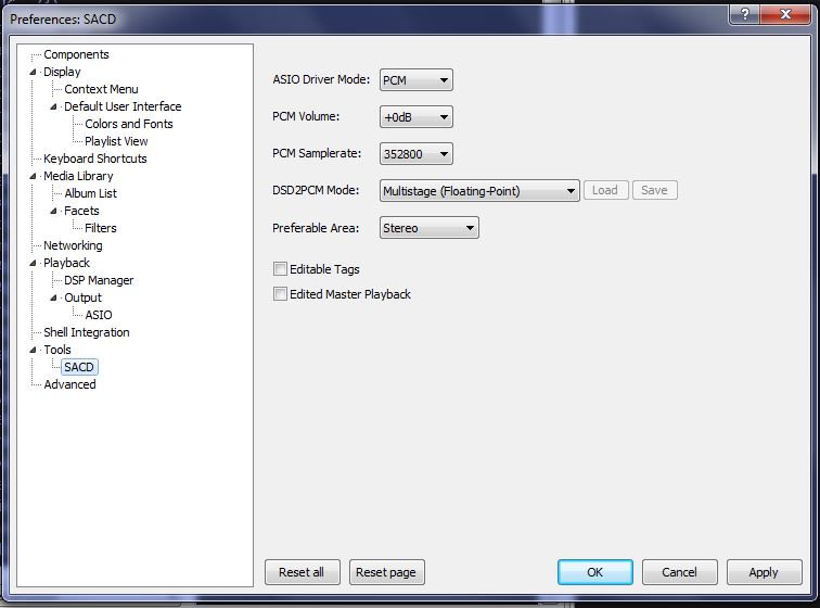

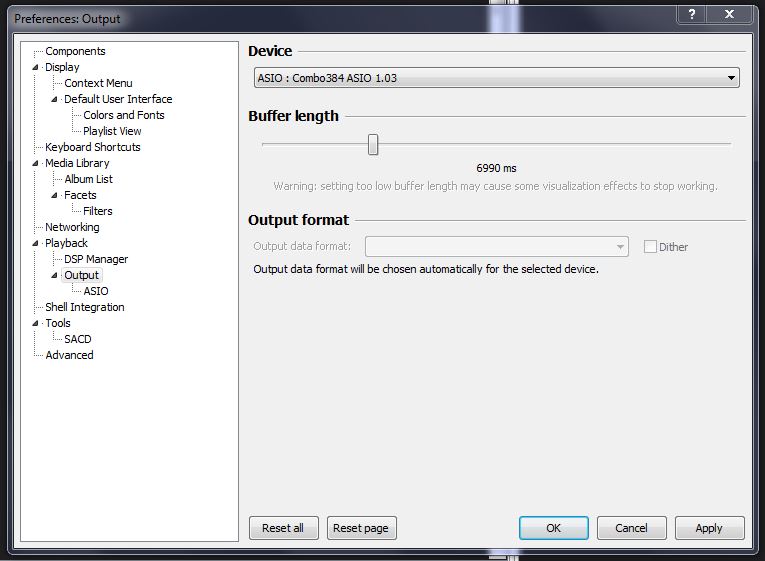

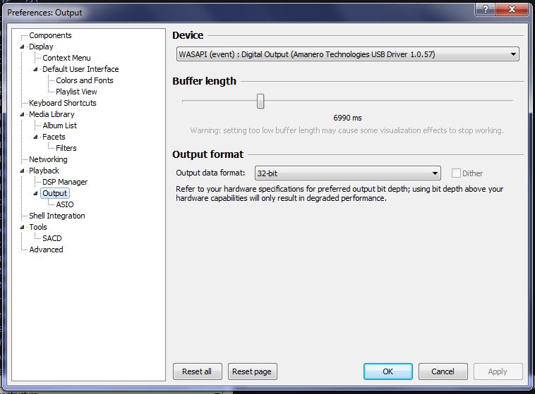

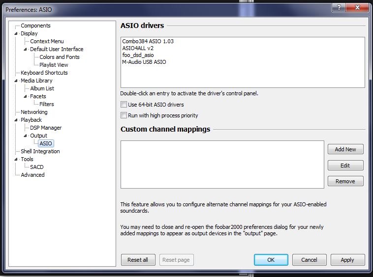

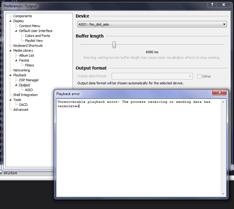

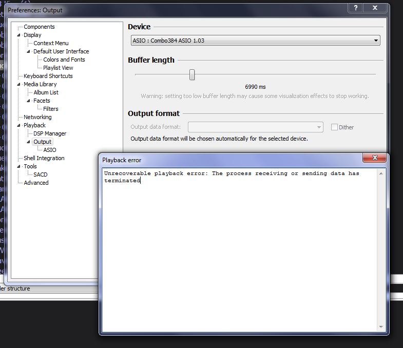

I have just rebuilt my BIIISE DAC & added the Acko Isolator to the Amanero output & update the Amanero firmware and driver, but for the life of me I cannot get Foobar to play music using any of the ASIO Output Devices.
I can play music using the WASAPI Output Devices.
I have attached some screen shots in the hope somebody can spot a problem with what I'm doing.
PS: The Amanero work in the past using ASIO Output Devices before I did the updating.

I can't see what error have you in your setup.
Normally, you have fine playback for all files untill 192KHz.
What amanero fw setup used for S03 matching?
I used the factory standard install 1080 it's the top of the list in the firmware install program, I'm not re clocking, not yet anyway, just using the board as an isolator
