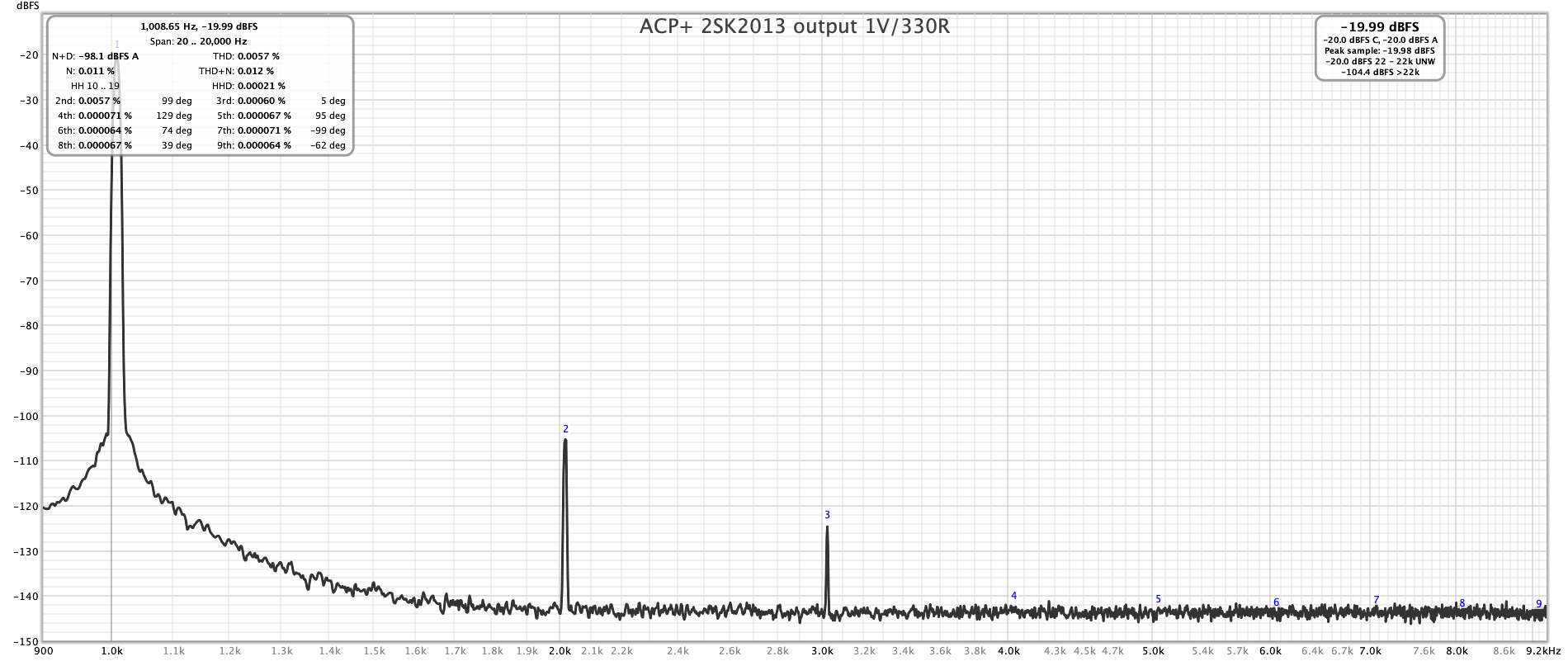

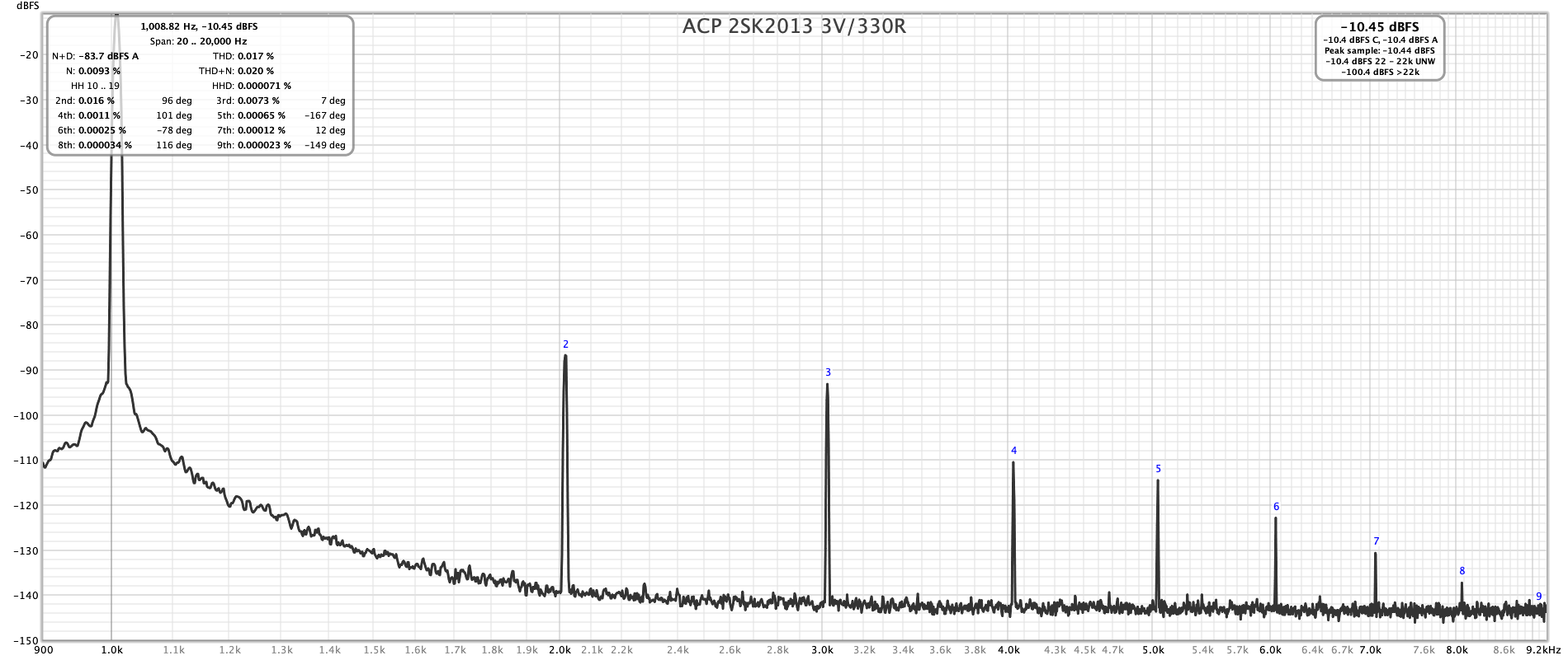

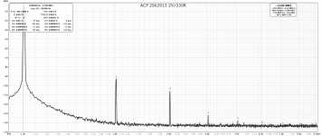

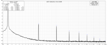

I finally got around to trying the Toshiba 2SK2013 in the Q6 position of my ACP. Sounds and measures really nice. The only adjustment I made was to lower R15 to around 700R. I haven't done any tweaking to R12/13, as it sounds really nice with 2R2/6R8.

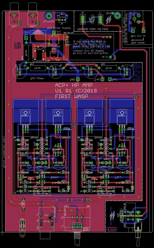

Hi. Did my own version of the ACP+ with integrated 24V PSU. It was designed to fit an existing chassis I have in stock. Unlike the original it has only one set of input, and no output. There is the option to use an external wallmart AC adapter, just don't mount the 24V supply parts. It also supports two models of volume pot, the larger ALPS Blue Velvet and the smaller (and much cheaper) RK097. I'll probably end up with a few extra pcb to sell. SB

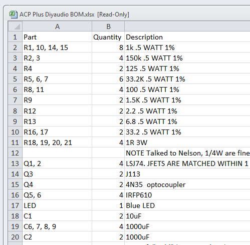

Hi folks,
I've been working with 6L6 over the past month to put together a BOM for the ACP+ project with an eye on assembling a kit in the future from the BOM. Before we go ahead with that, we wanted to seek feedback from the community, so I am attaching an XLS version. Please look it over and let us know what you think.
Note that the file below had to be put on dropbox/share as the forum will not accept .xls files.
--Tom

The forum will let you attach a file whose type is ".zip" and that is what I often do when I wish to upload an .xls or .xlsx spreadsheet. Create an empty .zip archive, store a copy of the .xls inside the archive, and upload the .zip.
hope this helps
