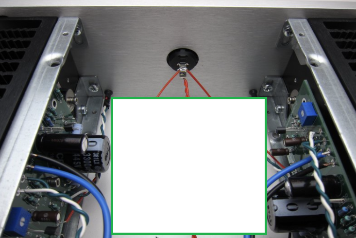

From what I can tell - withmatt's PCB is 120 x 160mm, but I am looking for confirmation from someone who got this PCB.
Also, the "useful" internal width of the ACA case is 150mm, so the 120mm wide PCB should fit, but I have no idea whether or not the ACA components (attached to the side heatsinks) reduce this useful 150mm (and by how much)?
That is the reason I was asking the great people here for more inputs before placing orders for the case ;-)

There's not a lot of room because of what encroaches the center space from the sides...
Thanks Jim.
Can you please measure the clearance between the 2 black & white caps? (width of green rectangle in my attachment)
I am considering going 1 size wider, which adds 100mm (probably big overkill), or 1 size deeper, which adds 50mm and that would allow to use Nisbeth's 3-PCB design (placing them one-behind-the-other style).

Due to space limitation - I might prefer going deep over wide.
That is the reason I would really appreciate a measurement of the clearance between those 2 protruding black & white caps.
Going deep would allow for the Nisbeth 3-PCB solution.
Jim, I am trying hard to avoid throwing away a $200 case because it won't fit the project I am desperately trying to stuff in it... 😉
