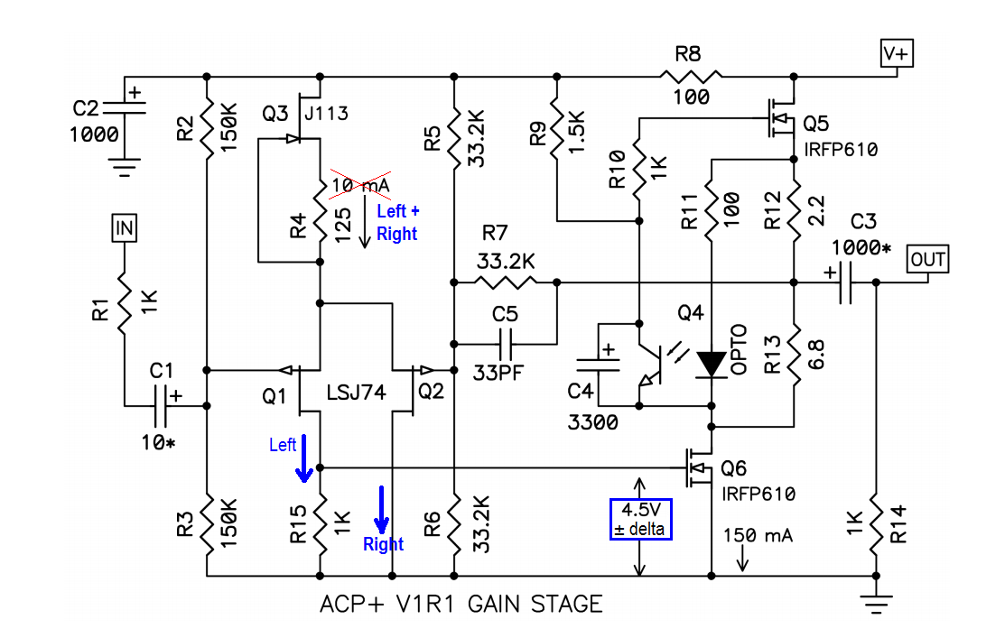

Perhaps there's a different way to think about the "optimum" value of DC current flowing in the Long Tail Pair bias transistor, Q3.
  • Each and every IRFP610 that rolls off the manufacturing line, is slightly different. In particular, each one has a slightly different gate turn-on voltage ("Vthreshold").
  • The ACP+ circuit uses Nelson Pass's patented optoisolator bias control system , to set the gate voltage of Q6 to whatever voltage is necessary in order to make its drain current become Nelson's desired value: 150 milliamps.
  • The opto bias compensates for variations among the millions of individual IRFP610's that could be plugged into position Q6
  • The expected gate voltage of Q6, for most of the units shipped by the MOSFET factory, at most operating temperatures, is about 4.5 volts. Plus or minus some unit-to-unit variability that I will call "delta".
  • So the current flowing in resistor I1 is (4.5V ± delta) / 1K
  • If the Long Tailed Pair Q1+Q2 is operating in perfect balance, then the current in Q1 ("Left") is perfectly balanced with the current in Q2 ("Right")
  • So the tail current which gives perfect balance, is 2 * (4.5V ± delta) / 1K
  • And perhaps we can call that the "optimum" current in Q3.
It might be a little tidbit for the OCD perfectionists to get lathered up about. (relevant link)
You could measure VGS(Q6) of your unit and figure out the exact value of "delta" of YOUR ACP+. Plug it into the equations above and Bob's Your Uncle, you know the optimum IdsQ3. Repeat for the other channel since it's a stereophonic device.

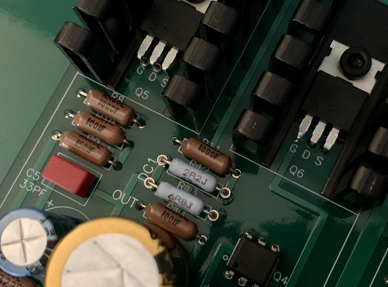

Joined 2019
There was something missing from my ACP, but I just couldn’t place it. Then it hit me - no powder blue Panasonic ERX R’s! So I put some at the obligatory output positions. Definitely hearing ‘passing’ shades of blue now :D

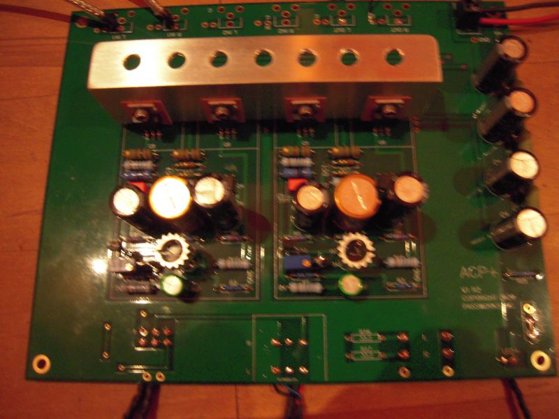

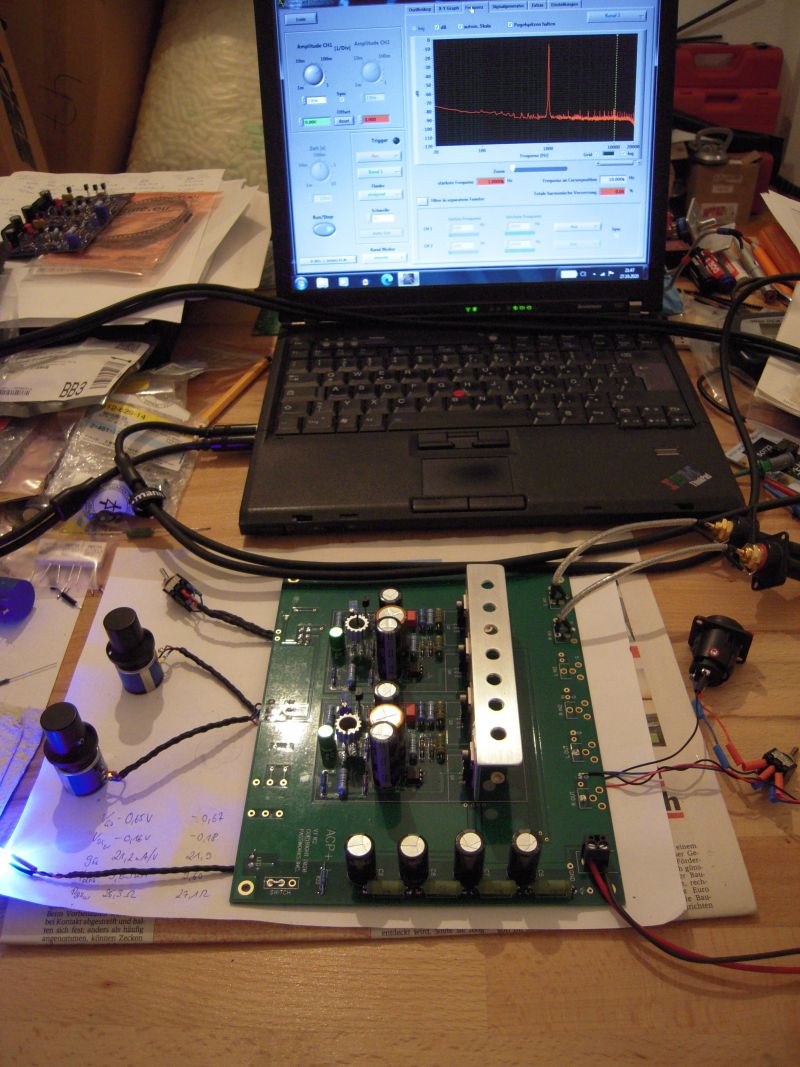

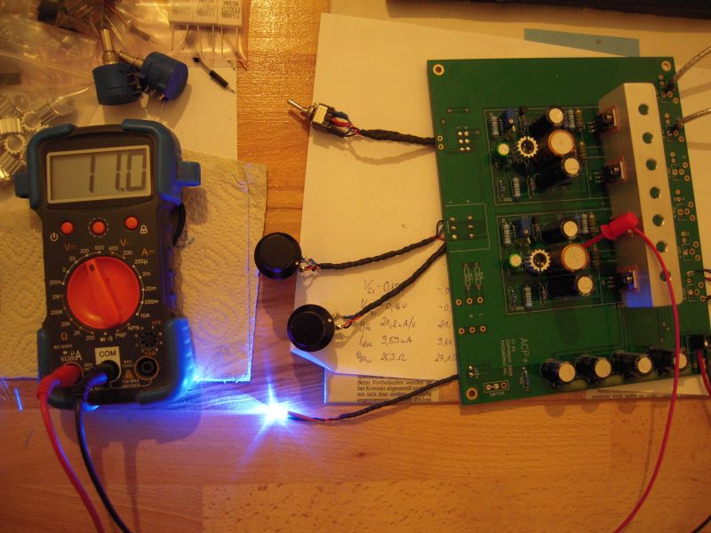

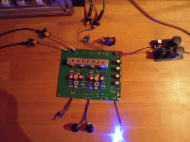

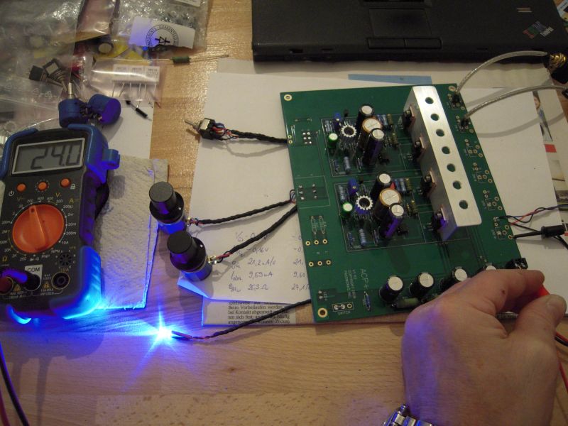

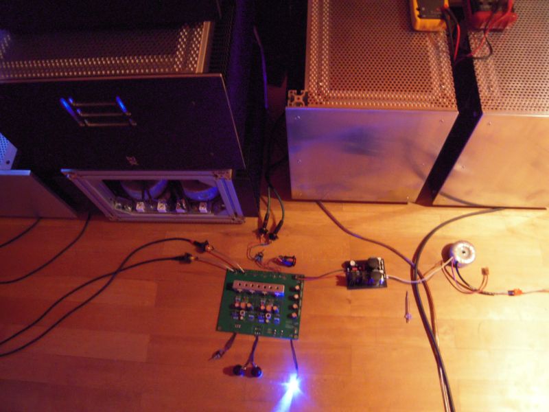

Hello amplifionados,
I started my ACP+ this evening first time. This babe sounds really good.
I need more listening. Also listened with my headphones (250Ohm cans) -
adjusted resistor at output from 33.2 ohm to 37 ohm (switchable) for the headphone
I made a little linear regulated power supply with LT1085 and RCRC-filter.
Voltage adjustable and exactly 24 V.

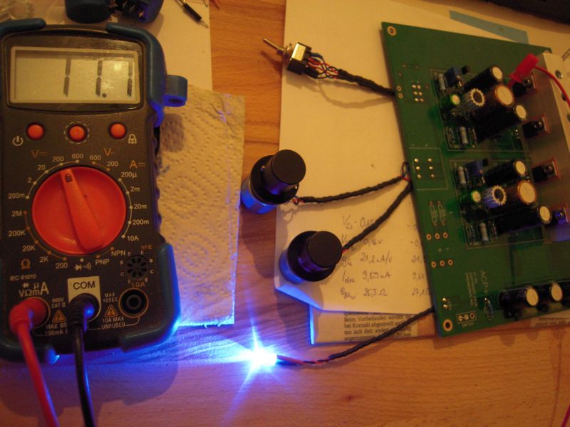

Voltage at DC1 is at 11 v and 11.1V.
Over R15 I measure 4.44V.
My R4 value is at around 40 Ohm (33 Ohm resistor + 100 Ohm- trimpot dialed down close to zero)
JFets are at around 30C temerature. Mosfets run hot at around 60 - 65C.:redhot:
Mosfet - heatsink is at around 35C.
Greets
Dirk
