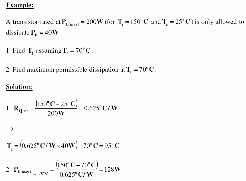

Pingrs said:........ discussed derating Vce, since that was the more vulnerable parameter (at least, that’s the way I read it). On that basis I chose to do it that way.........
I think you'll find this more useful.
mikeks said:
Mike, this is a great document! Thanks,
Jan Didden

Pingrs said:Mike,
Just read your post. Thanks for that.
I already have that doc., but I'm too dumb to see its relevance as to what to derate, V or I (or a combination?)
What's your opinion?
Best regards,
Brian.
You derate power (V*I)
Refer to attachment:
- Amp power calculations into different phase angles
