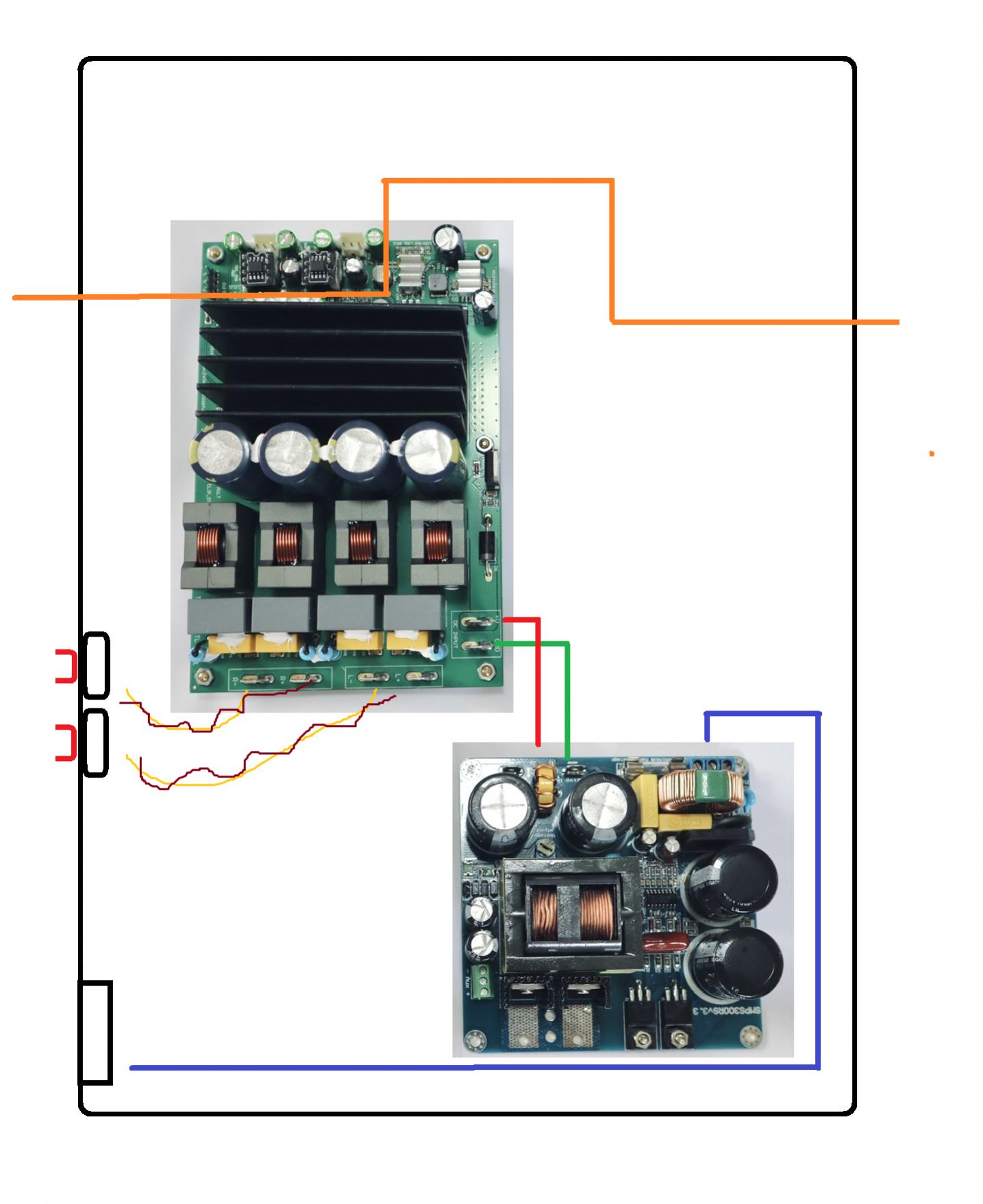

Using external caps for the opamps is ok I think, just avoid the switching regulator part of our TPA3255 board by 1 to 2 inches.
Attached my plan layout for my module. The orange divider is what I think it is safe to put the preamp / low level signal components (rca jack, large caps, volume ctrl etc).

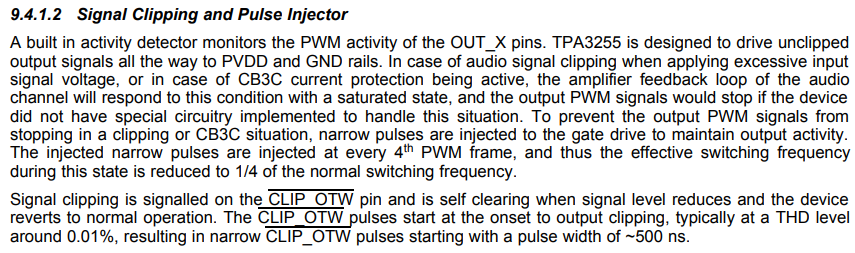

I will add in the startup manual that clipping without load should be avoided with our TPA3255 PFFB module. In clipping scenarios, tpa3255 chip adjusts the oscillating frequency to 1/4th the normal switching frequency. If there's no load, this will make the 220nF+1ohm output zobel dissipate large heat.
If other TPA3255 PFFB modules encounters this scenario without oversized zobel (or other circuitry to prevent it), zobel will be instantly fried. In our module, zobel can handle it for a couple of seconds.
