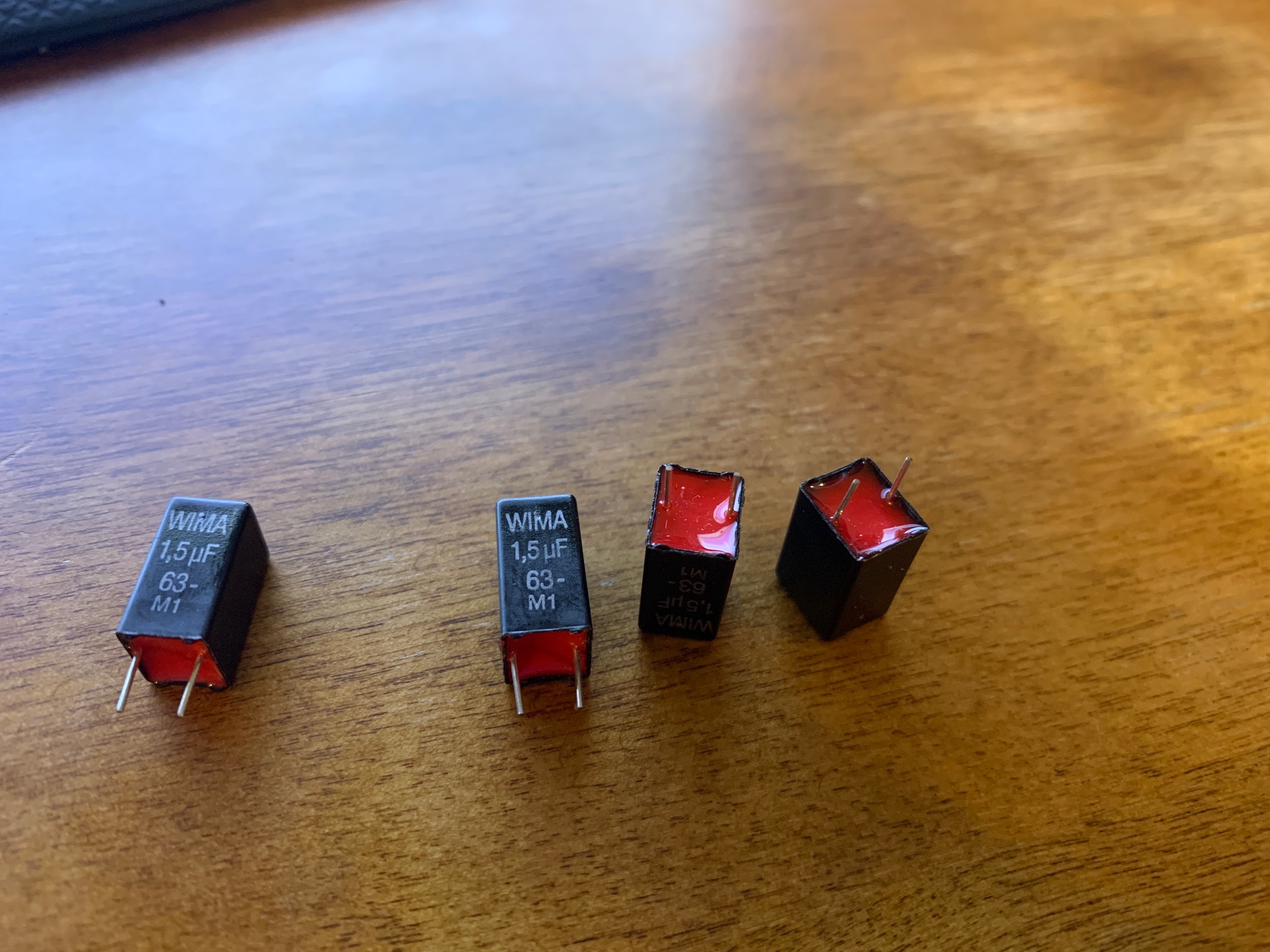

This guy sells Wima pps 1.5uf/63v https://www.ebay.com/sch/kip1607/m.html?item=113921311155&rt=nc&_trksid=p2047675.l2562
He is legit,

Asuslover: I thank you for this. I’m always a bit leery of buying any components off of EBay even though the seller has an excellent rating. Looking at the data sheet posted with the item it clearly says the casing color is supposed to be red while the caps in the picture are black. I ordered the 1uF Kemet SMR caps from Digikey to try them first (only 5mm pin spacing which means I’ll still have to bend the pins to get them to fit the board’s holes).
Regards, Pete
I do understand your concern, these pps wima 1.5uf are not even on the datasheet, I believe they were part of a special order, it was discussed here:
Fake WIMA's?
But I'm 99.9% sure they are legit. I could spare a few if anyone in US would be interested.

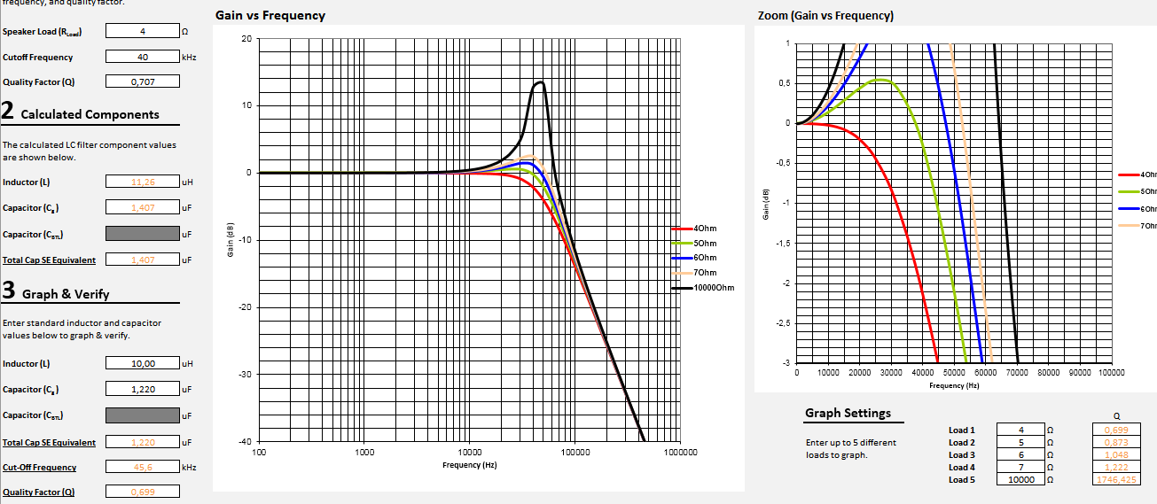

Omg we have 65kHz switching SMPS?So, in the end, isn't it better to use 10uH? I see farnell has 103KL in stock. I know, it is less linear etc. But...
10uH + 1uF has 50kHz freq.
10uH + 1,5uF has 41kHz freq.
Both with usable Q.
Please use 10uH + 1uF. Using 6.8uH requires modifications on post filter feedback and zobel for stability. (or disable PFFB to use 6.8uH without parts modification)
For others: VER2923-103KL is already out of stock on Mouser. We can use AGP2923-103KL (automotive type) as an alternative, its mounting pins can be removed by using pliers.
We can also use 7G23A-100M which is very linear (although discontinued already). ICE Components 1D23A-100M is also compatible but there's no inductance vs current graph in their datasheet.
Lester

Your advises and care are much appreciated Lester, thank you! Is 10uH + 1,22uF ok with my PFFB parts? 1,22uF gives me the best looking graphs and damping factor for my 4Ohm speakers. Changing zobel is not problem, if needed.JLesterP said:Please use 10uH + 1uF.
Farnell/Newark has lots of them stocked.JLesterP said:VER2923-103KL is already out of stock on Mouser.
That is exactly what I was thinking about. The original idea comes from this longtime project Humble Homemade Hifi - Cap Test where it is stated somewhere, that the good ratio is 80-90% of main cap and 10-20% of better/altering cap. So if Silmic is too veiled and Muse too harsh, it will be interesting to taste the sound of the combination of (say) 10uF Silmic/Muse in parallel with 1uF Wima/Kemet/other foil cap under the PCB. Will try it after holidays.JLesterP said:Yes I think if we parallel 1uF caps to Elna Silmic II, it will open up a bit while retaining the smooth sound.
Lester : would it be safe to use 10uH + 0.68uF with the current PFFB in place?
