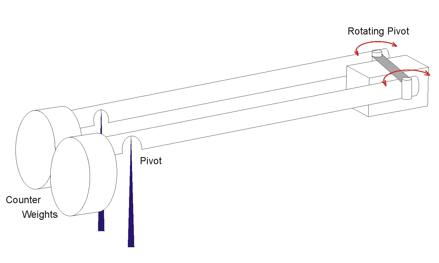

Pardon me for quick drawing, but in following concept if rotating pivots are very precisely made we can make good linear tracking tonearm. Two Counterweight are separate and tone arm rests on two fixed pivots. We can calibrate two counterweight (being separate) by test record.
Regards

......are you going with anti-skate not required or not important?
FM
If the design manage to obtain exact tangential tracking, no skate compensation would be necessary (in theory).

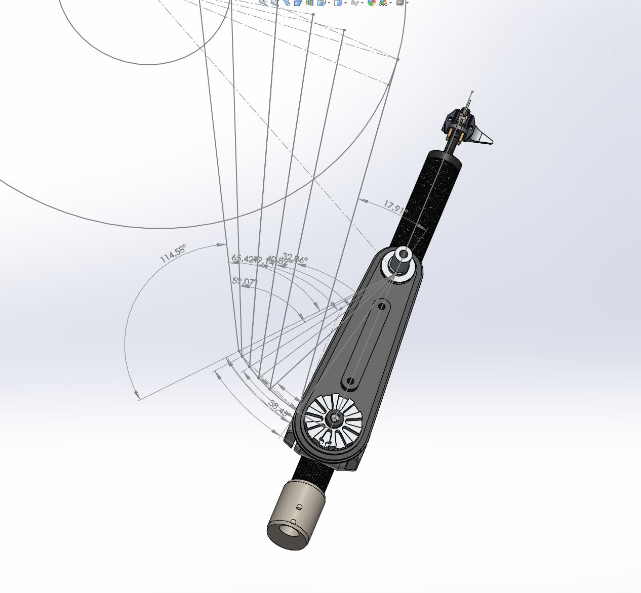

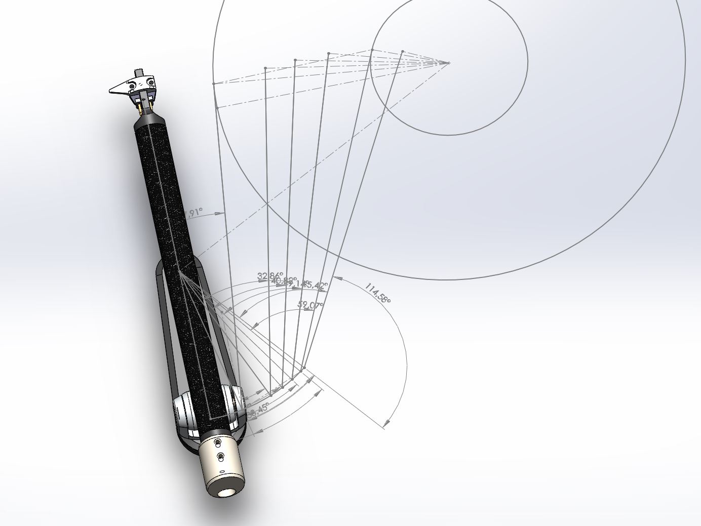

Some of the stuff I need to actually build this arm is now ordered, but delivery will be four weeks ore more:(. I have opted for axial/thrust bearings for all pivots, and will be using a Technics arm and base with only vertical movement.
Steen
I've built the main pivot mechanism and will add the vertical pivot box tomorrow.
I still feel that I want to put a counterweight onto pivot 1 as all the weight is hanging off one side of that. In theory, the bearing is strong enough but it just feels like good insurance to equalise the weight. Once the arm is hanging off the other side as well, it adds up to a bit. I do appreciate that the other three bearings are also adding some support.
Does anyone think it necessary or is it a bit over the top??
It certainly helped smooth up the action on my previous (er...wrong) effort.
If the design manage to obtain exact tangential tracking, no skate compensation would be necessary (in theory). ...
Steen
Not so, not even in theory. Skating force arises when the stylus drag force vector (which is tangent to the groove) is not in line with the horizontal pivot. The drag force then acts upon a lever arm whose geometry is determined by the arm length, offset, and overhang. This sets up a twisting moment about the horizontal pivot, which manifests itself as what we know as skating. This condition occurs whenever an arm’s geometry includes an offset angle and overhang, which is the standard accepted design prescription for reducing angular tracking error in conventional pivoted arms. Stylus drag in a true linear tracking arm doesn’t resolve into any skating force because it doesn’t act on any lever arm to cause a twisting moment about a horizontal pivot.
If you analyze arms that employ ‘multiple linkage’ design methods aimed at eliminating angular tracking error, you invariably find that the stylus drag force vector does not pass through the horizontal pivot (at least not everywhere), and thus inevitably does end up creating some torque artifact that resolves into skating force, much the same way as conventional pivoted arms. Multiple linkage systems are also likely to have higher amounts of friction/sticktion which can mask the effects of skating that do exist and lead one to an erroneous conclusion that the reduction or elimination of angular tracking error alone eliminates skating force. So yes, even if the arm maintains perfect tangency across the record surface, you would still need some form of antiskate.

...if rotating pivots are very precisely made we can make good linear tracking tonearm. Two Counterweight are separate and tone arm rests on two fixed pivots. We can calibrate two counterweight (being separate) by test record.
Your concept is similar to the Thales Simplicity tonearm (or the Van Eps arm) except yours uses two unipivot bearings. I think it's a good idea due to its simple bearing and low friction. But I would use one main arm and the other one being a skinnier secondary arm without counterweight, just acting like a guide and stabilizing azimuth. The majority of the mass falls on the main bearing. The headshell pivot would be right above the stylus tip. Thales Simplicity claims the use of two equal arms for tuning resonance and the two counterweights have embedded magnets for antiskating purpose.

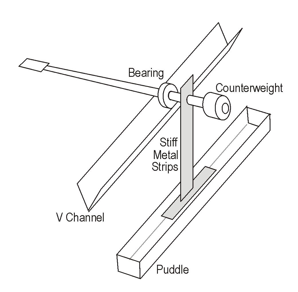

Here is another concept. Don't know how stable the arm would be. This uses 'Single' bearing and metal strips in liquid to balance the arm so azimuth doesn't change and also dampens the vibrations. Bottom strip is flat horizontal so it resist the rotational movement and Vertical strip runs parallel to the liquid so has least resistance. Again don't know how much stable it would be.
Best regards.

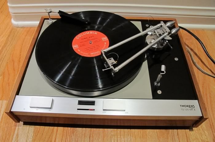

9" tonearm with no tracking error, but what to do with the friction pulling the arm joint open..??
One thing that is really bad with this thinking is that all records are off centered, and if you look at the needle it sways much more than what 1-degree tracking error from a 10" radial arm would even deliver. personally I don't see the benefit in no/low tracking error at the expense of added complexity or the non solid nature of the bearing in linear trackers.
Best regards.
I have almost same idea as yours and I don’t think yours works because you don’t have a linear guide. In fact, I already got some parts for this kind of arm, but I like air bearing so much that I am building 2nd one with different construction. If you are interested, I can post my idea later on.
