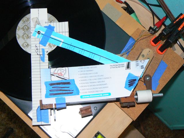

I've got some catching up to do. The photo shows three mounting guides I used that made my life a lot easier. The blue strip goes from the spindle to the main pivot. The large strip shows the arm and pivot alignment with the stylus in the outer position and was taken directly from the drawing. Its long edge goes along the arm center line and the angled edge goes to the two main pivot centers. The strip with perpendicular lines checks tangency.

I moved the arm to a Lenco B-52 yesterday and set it up pretty carefully using the guides in the photo. It has an AT120E at 1.8 gr. now and tracks very well. But more important, I think, is that I haven't truly enjoyed music this much for a long time.

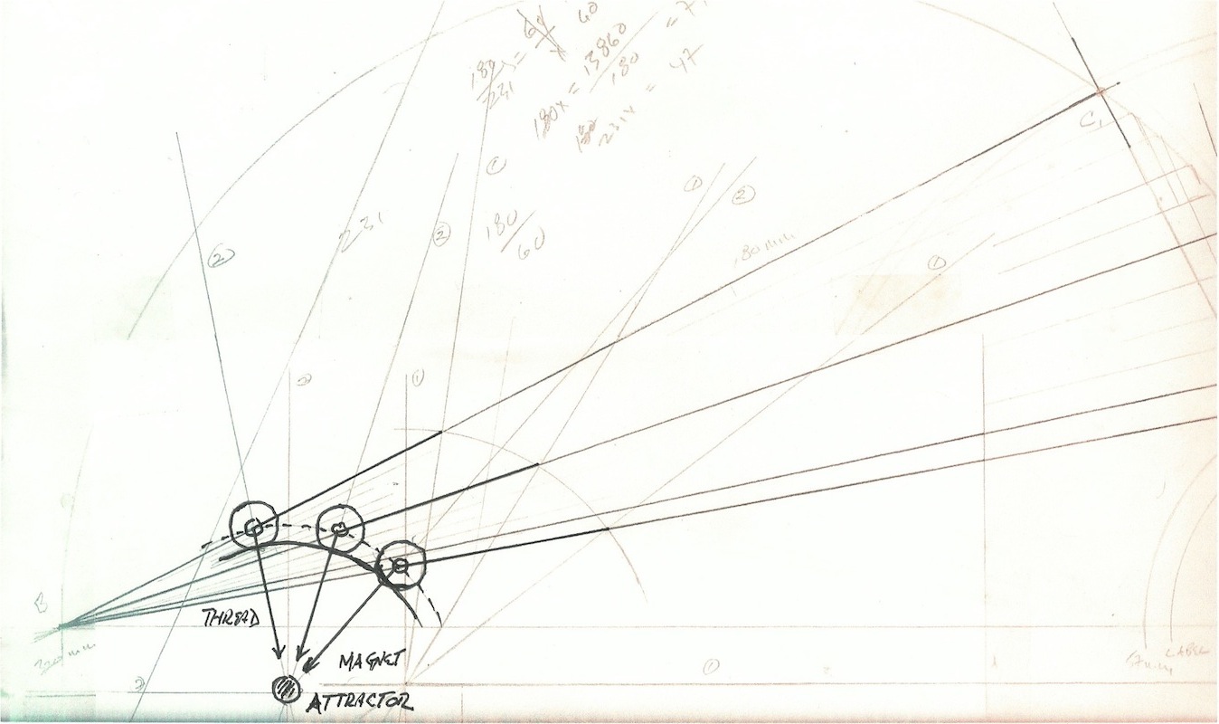

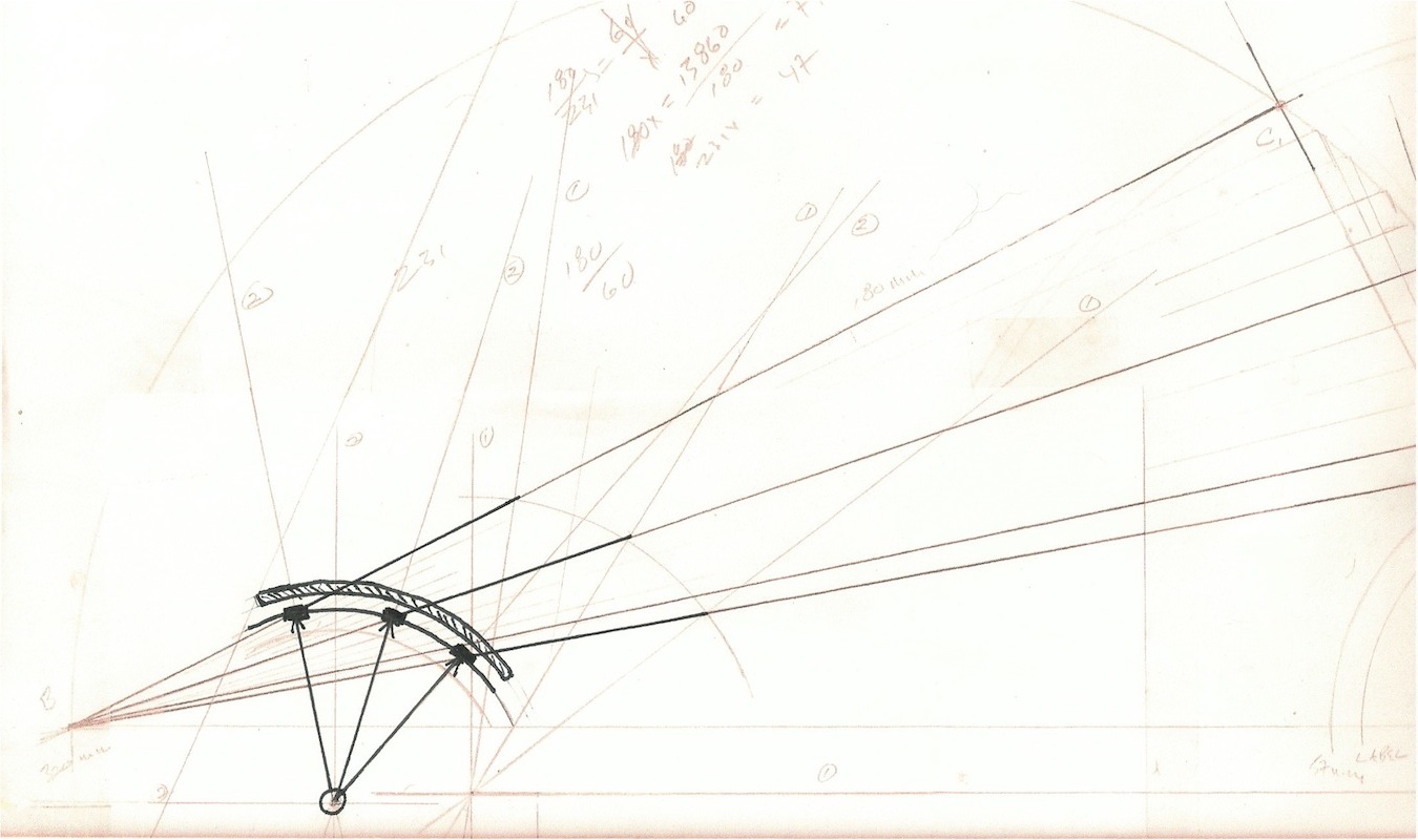

Hi guys,
I should stay out of this, but I have to add some food for thought.
dtut's arm is geometrically the same as an LT arm. Think of the second "guide" link as the magnetically coupled extension below(or nearly below the armwand axis. The radius of the guide rail circle/ellipse segment is equal to the secondary mechanical linkage.
Easier to implement(perfect for diy efforts), but far more friction prone...
And no decoupling/damping in the lateral plane....just added eff. mass.
I said it here before: A circle is an ellipse with both centers being congruent. Birch is a case where everything is centered around circle segments, - when an ellipse segment offers far greater freedom of placing all elements involved.
Skating will be present on all passive radial tracking arms, --- unless there is sufficient and properly directed displacement of the arm that is moving around the main axis:
Check out the LT arm. The base has a provision for tilting it in any direction. Not only would that allow to compensate for any discrepancy between the platter bearing orientation and the tonearm's vertical bearing orientation, the major benefit of such an arrangement is that a (small) tilt will create a restoring force that acts on the entire pivoted arm assembly. Like a pendulum, it will "find" the lowest position.
That alone brings an hitherto neglected force vector into play.
And that vector can be adjusted(length and orientation) such that it compensates completely for the drag exerted by the stylus which, (in conjunction with the resulting force vector not going through the main bearing) is what causes skating.
If one was to use a "conventional skating compensation mechanism, compensation being fairly constant over the usable radius of the record, the result would be unsatisfactory. The skating on dtut's arm decreases considerably with decreasing radius. A "vertical displacent compensation" will, by definition be non-constant and can be chosen to diminish with radius, hence compensate very closely to ideal.
The length of the main pivot arm together with the total displaced mass dictates the required vertical displacement.
If dtut was to replace the second "guide" arm with a thread, then, depending upon the attachment point of said thread, spring load that thread, friction could be greatly reduced. Having the thread wind or unwind onto a cam, any positional determination based on an ellipse, cycloid or whatever segment can be realized.
All the best,
Frank (Schröder)

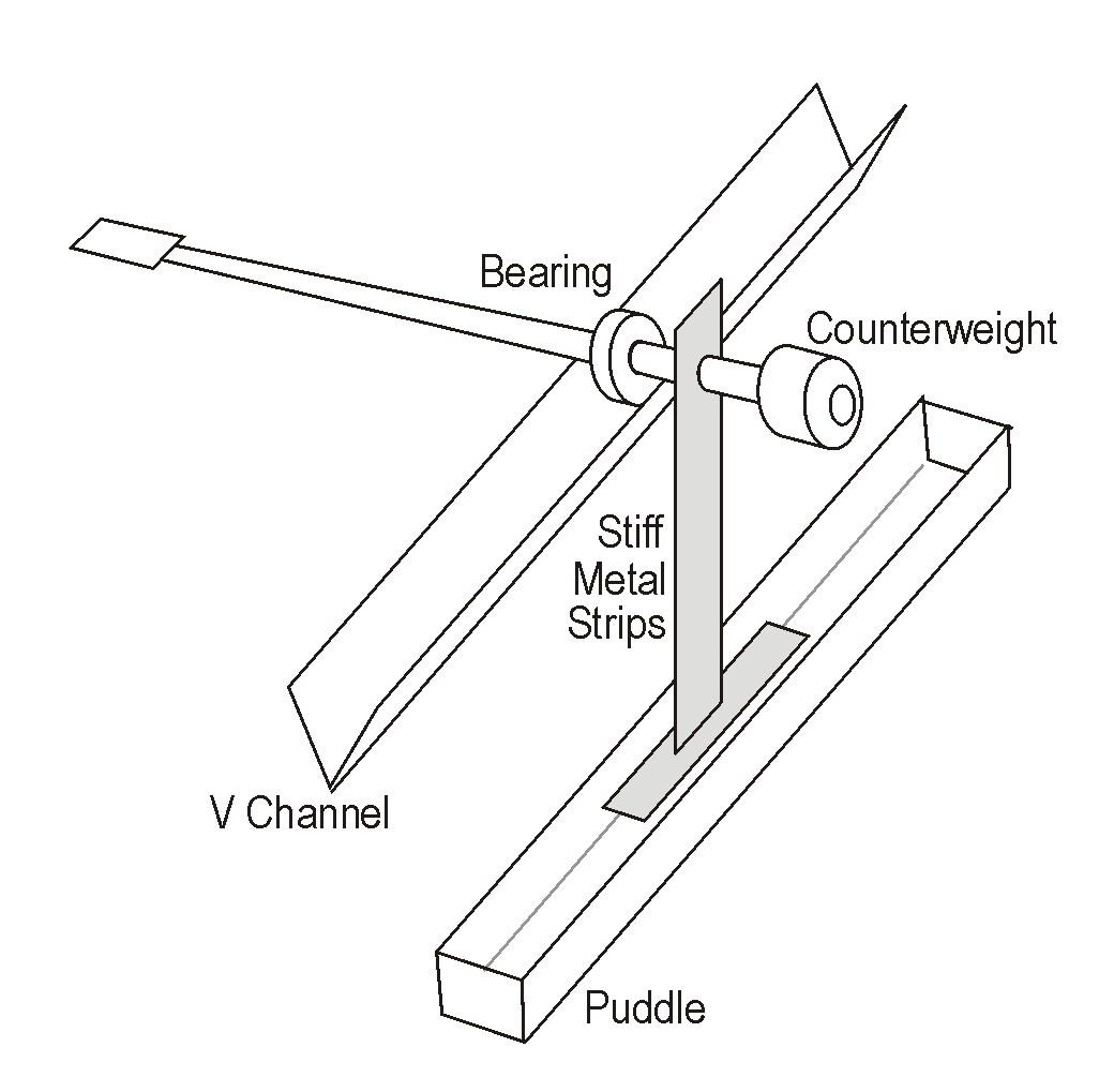

Here is another concept. Don't know how stable the arm would be. This uses 'Single' bearing and metal strips in liquid to balance the arm so azimuth doesn't change and also dampens the vibrations. Bottom strip is flat horizontal so it resist the rotational movement and Vertical strip runs parallel to the liquid so has least resistance. Again don't know how much stable it would be.
While I like your single-mindedness (pun intended) in achieving low bearing count, your approach is almost like making a linear unipivot arm that's always trying to stabilize azimuth. But a unipivot arm has a stationary bearing and yours is always moving and constantly trying to re-stabilizing itself and it seems rather belabored. I think a simple two bearing a la Cantus style probably works better. I admit a single bearing is attractive in concept. Perhaps you can try a magnet pointing down to avoid azimuth rocking. Or the magnet pointing up to lessen the mass. Another issue with a single ball bearing is that there's very little contact surface so it is prone to horizontal pivoting or twisting motion that should be avoided because once that starts to wriggle you loose tangency! Great drawing!
Can the string be mass loaded like your early Thales experiment?
Yes, that string could also be tensioned by, say, a dropping weight. But, just like in the Thales/Schröder hybrid pictured, such a dropping weight will excert a force on the arm assembly. The thread's "dropping"(pivot) point would be stationary and such a dropping weight could even substitute the vertical displacement skating compensation, - but not as close to ideally.
The very first conceptual LT model featured a string instead of a magnet/rail positioning system. Worked well, but the magnetic coupling has additional advantages... like lateral damping of the fundamental arm cartridge resonance frequency through induction of Eddy currents.

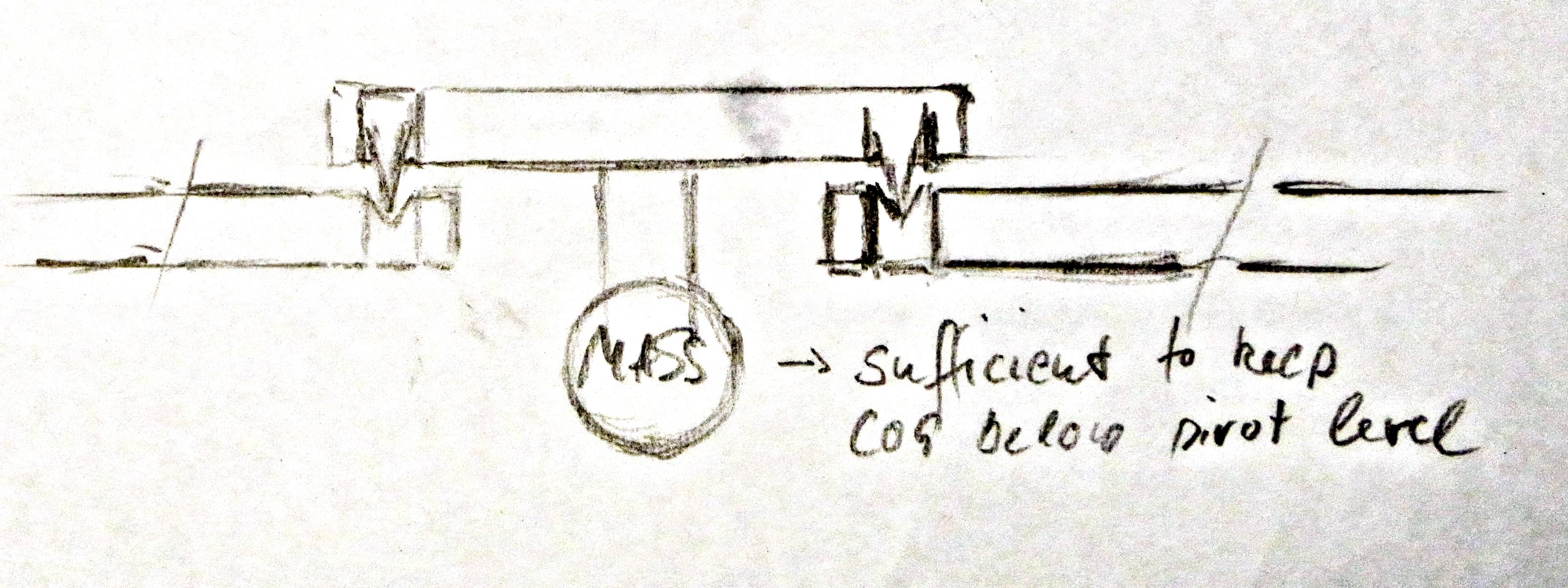

@dtut: To reduce total friction, you could retain the ball bearings for the main arm/pivot bar and try two cup and spike bearings for the guide arm... placing the cog of the guide arm below the bearing cup level required for stability. Mount the spikes eccentrically and you have a means to adjust the eff. length of the guide bar within the boundaries of the chosen eccentricity. Allows for finetuning the geometry...

Direct, if you look at The picture from beneath you see the two pullies, they are belt or thread connected and thus locked in rotation together, this leaves us with an arm with low vertical mass, but more horizontal mass, the arm opens in a scissor like manner as the cartridge moves over the record surface.

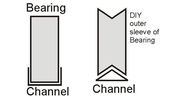

Yes tangency would be an issue. Sorry didn't mentioned earlier. The V Channel will hold the bearing in place and would be lateral guide. The puddle will be filled with liquid so as horizontal metal strip would resist rotational movement and with appropriate weight of metal strips serve as a stabilizing pendulum. I wonder instead of V channel if we put square channel holding the bearing would it be a good idea ? OR If one can DIY custom outer sleeve of bearing as shown in the cross section Picture ? Hope I am not boring you all with abstract ideas. :)

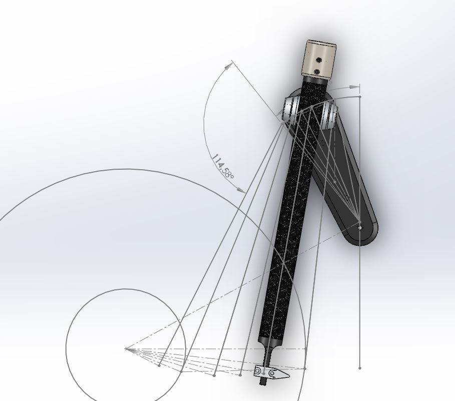

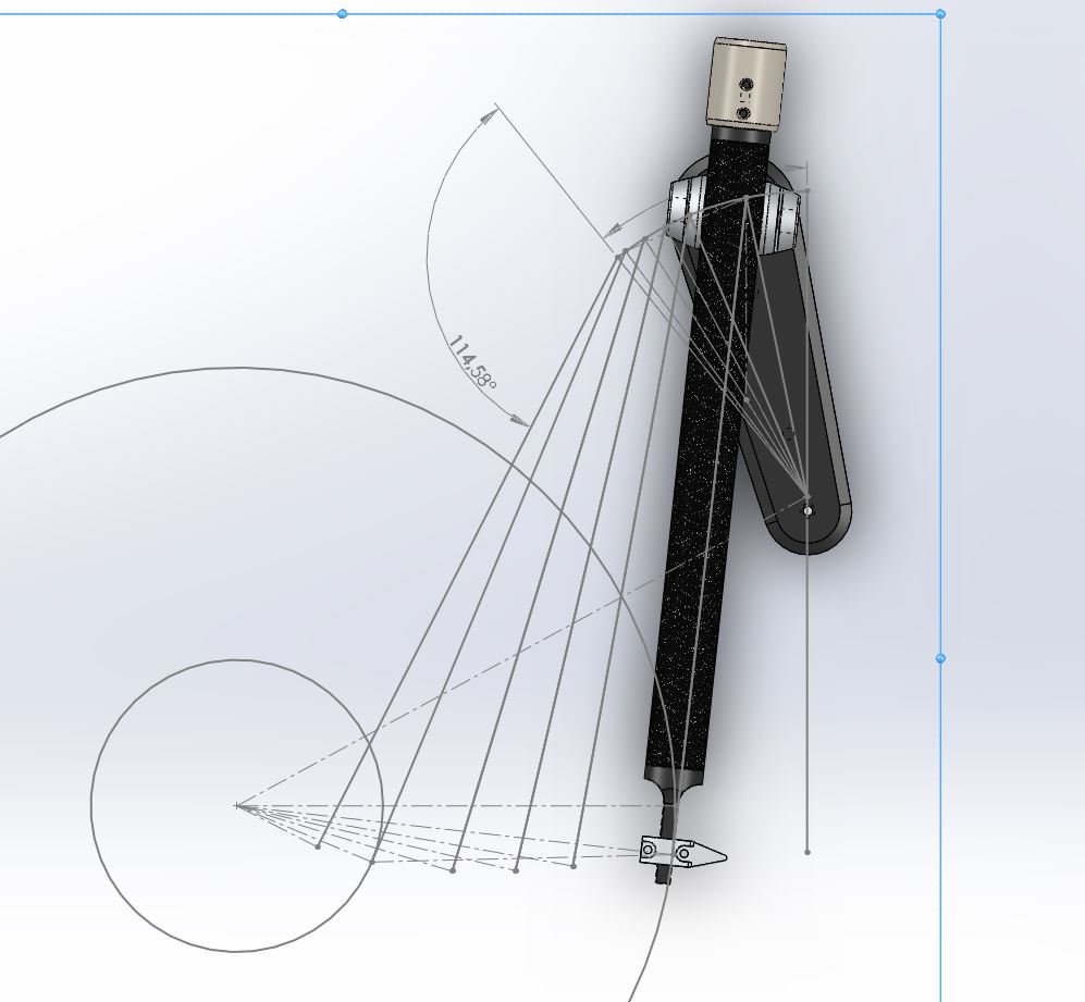

2wice - I hope you're still working on your project. I noticed in the drawing you posted at #903 that the centers of the two circles align horizontally. In my design and Steen's drawings the centers are offset. Am I seeing your drawing correctly?

two quick drawings
The first drawing shows my original intention which was a cam with the guide arm bearing as a cam follower. There was a lot of friction and noise so I ditched it and went with the two bearing pivot.
The second drawing shows a possible implementation of what Frank has described - I think. If it's anywhere close to possible, it could evolve into an ellipse - I think.
Hi Frank and welcome back. Thanks for your suggestions. I heard a political science theory professor say that every time he thought he had a real good idea he found Plato coming back the other way. I know how he felt.
