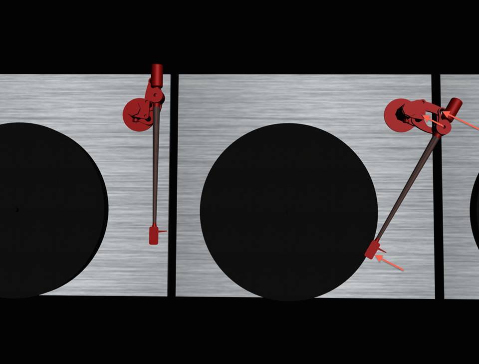

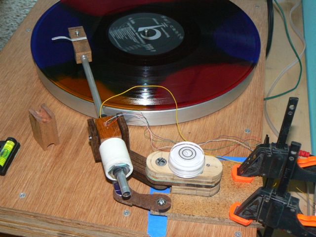

Just when we thought this thread is about to run its course, here comes a new design. It appears to be a variation of the Birch concept and similar to the Schroeder LT minus the magnets. It reminds me of some of the designs we discussed in this thread in the past. I am waiting for more detail on the pivot designs and geometry. Have fun digesting the pictures!
Well, now, that double arm geometry looks familiar somehow.
The concept and the drawings are beautiful. I just keep going back to them with serious envy.
There are aspects, the way the whole thing jack knifes into a tidy package when the arm is on its rest for instance, that I really like. And I hope the ruby bearings work out in this design. I appreciate this approach to using them and I'd like to try them to see if they are an improvement over ceramic hybrids.
I hope this design will be built. Fully realized it will be TA art, a pleasure to view and use.
However, after saying all that, one possible negative did catch my attention: In the drawing of the arm at the lead in position, a line drawn through the pivot arm bearings appears to be less than 90 degrees to a line drawn through at the center line of the wand. My experience is that those two lines have to be at more than 90 degrees. The wand is effectively locked between the trailing arm and the stylus and resulting force has to pass in front of the rear bearing of the pivot arm in order for the entire arm to move forward and across the record. If I haven't made myself clear and if it will help I'll try to do a drawing - (2D, planform, pencil and paper, that sort of thing)
I hope Zoran Mihajlovic knows about this thread and can contribute. I don't Facebook, but maybe someone else could let him know.

Those drawings are nice but they are just drawings.
We must give dtut (Doug Tuthill) credit for actually materializing an arm and showing us that it works.
The Supreme-Analog tonearm is similar to Doug's creation in a more refined package.
Don't forget to revisit post#888 and post#917 and all the comments regarding the design.
Hi directdriver, hello Doug!
" It appears to be a variation of the Birch concept and similar to the Schroeder LT minus the magnets..."
Exactly. Nothing that I see in those drawings represents originality...
As directdriver wrote, even Doug's version is no different in principle to my LT arm. The main difference and resulting advantages in the LT arm are the reduction in friction/slack-prone connections, the mechanical de-coupling in the lateral plane and the freedom of deviating from a circle-segment shaped guide curve.
The arm, as shown by Doug (and Mr. Michajlovic) has a considerably higher eff. mass in the lateral plane(vs. the vertical plane) and both will display (higher than neccessary)low frequency speed variations as a result of record eccentricity.
Properly decoupling the main arm in the lateral plane will result in a near elimination of the arm cartridge resonance frequency in that plane. Low frequency modulation(below 100Hz) is all lateral, so the bass will improve markedly due a reduction in intermodulation distorsion.
If Doug was to substitute the secondary(smaller, dark brown) guide bar for a thread and keep that tensioned, friction levels far lower can be achieved AND the mechanical coupling(arm - base) would be easier to properly define. It also allows for using a cam on which the thread acts, just in case one would like to change the dimensions dictated by the Birch equations.
There's more, but I'll wait until I see an actual arm by Mr. Michajlovic... at least Doug built one, - and in a true DIY spirit!
A relaxed Sunday to all,
Frank

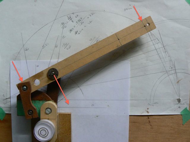

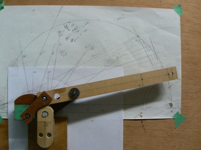

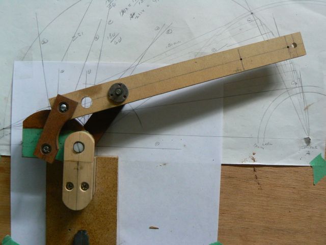

I've e-mailed Zoran Mihajlovic with a link to this thread inviting him to post.

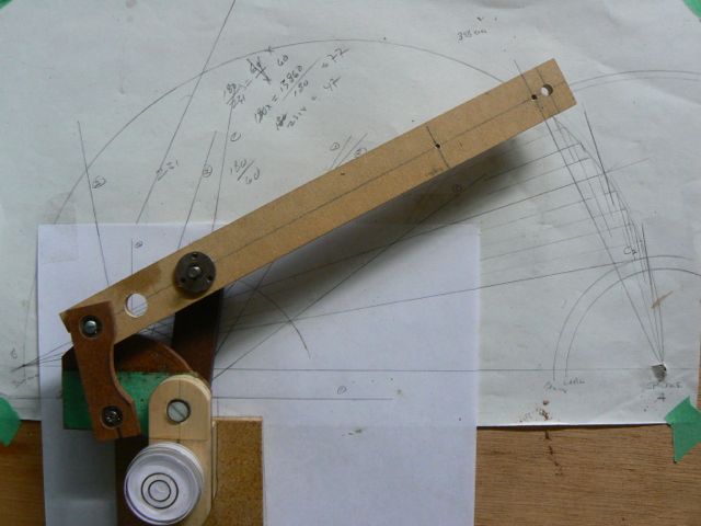

The two photos I've attached show the relative forces on his arm and on mine. The Birch geometry seems to inherently put the pivot arms in the right positions so if may be Mihajlovic is working with something new and different.
I've been using and enjoying the LT for about a year now. It does have different lateral and vertical Eff Masses and has a couple of other glitches, but it still works and sounds good. I've got a new one in mind - it's still a thought experiment - that will probably include Frank's tensioned thread suggestion or maybe something else if I get clever and lucky.

I am new to this forum, I do the drawings of Supreme-Analog Linear Tonearm (zoran mihajlovic is my partner..)
First I want to thank Doug for beautiful words ,I really appreciate this. Doug , you are absolutely right about forces (but in the wands are opposite directions). Zoran publish this a bit early, need some corrections. This geometry is well know probably from old greek, and have infinity solutions, problem is to find one (or group of solutions) who potentiate all criteria ( lead in position, rest position..).I prefer solution with wands opposite to groove guide because is more accurate. this particular solution have a nice "hug" around VTA tower, simple as that. projections of forces is a bit complicate , so I made software for this in autocad program (I am mathematics gay, Phd of mathematics). for a real thing I will vary different geometry, thickness of materials ,bearing, etc....as a cnc gay (my "main" job is project and build cnc machines, robots..) I have many opportunities . if any is interested I will gladly post news .
thanks for comments about Birch concept, Doug Tuthill tonearm, Schroeder LT , I found last two, but nothing about birch concept. if anyone need some help about drawings, solutions, preparations for cnc...I will gladly help if I can.
Andy, if yours question is about my drawings, I use autocad for drawings, but 3ds max for render.

Sacha,
Welcome to the thread and thank you for posting.
On pg 21, post #209, there's a drawing that shows the Birch geometry. That is the drawing I used for the arms I built. On the same page, post #210, Mark Kelly describes how to draw the pivot points.
On pg 22, #219, Mark describes the math he uses instead of doing the drawings.
On pg 80, #794, 2wice approaches the problem a bit differently and posts calculations and plots.
On pg 83, #822, Jonathon Carr (jcarr) talks about an Excel program he used to determine the error for different pivot arm/swing arm combinations. Farther down he posts some of his results.
I hope this information about the Birch geometry will be helpful.
One of the things I really like about your design is the way the mechanism "hugs" the tower in the resting position, as you say. That's very clever.
I hope you and Mr. Mihajlovic are able to sort the details and build a working model of your arm. Please post your progress.
