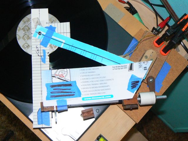

If you have not found a mounting template for your BJ arm, here are two ways that might help you find the mounting position.
1. Attach a long straight stick or rod over the stylus and perpendicular to it at the head shell and move the tonearm base until the stick always points as close as possible to the center of the spindle as you move the head shell across the record.
2. Use a strip cut from a calendar or anything else with perpendicular lines. Put one end over the spindle and move the tonearm base until the stylus is perpendicular to the long line at any point along it as you move the head shell across the record. In the photo, the important part is the strip between the spindle and head shell. You have to rotate the strip a bit for each head shell position.
I think you can get pretty close with these tricks.

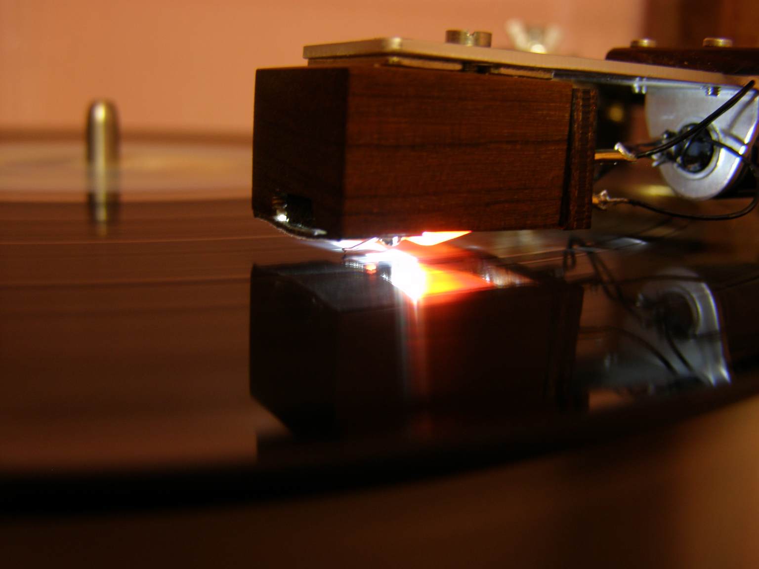

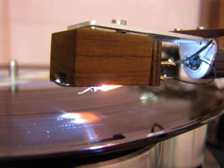

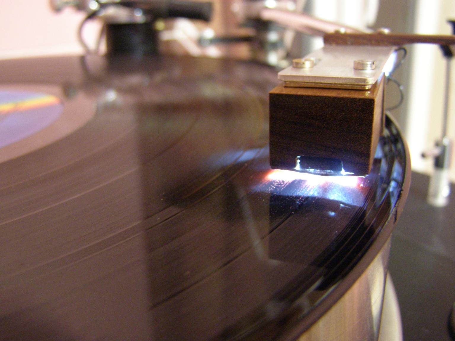

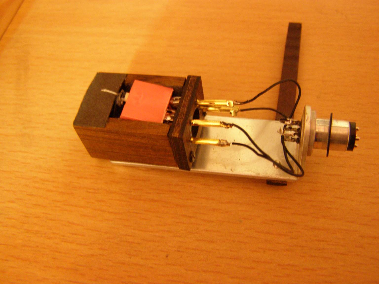

I'm sorry for going off-topic, however if we have already discussed optical cartridge here, I would like to put my DIY project results here. I've just completed a working first prototype and tested it. It sounds encouraging . It is basically of Toshiba design, somewhat changed and optimized, with modern LED and photo-transistors on board. The same apply to proper preamp; it is based on Toshiba. With some further improvements both should go true hi-end.

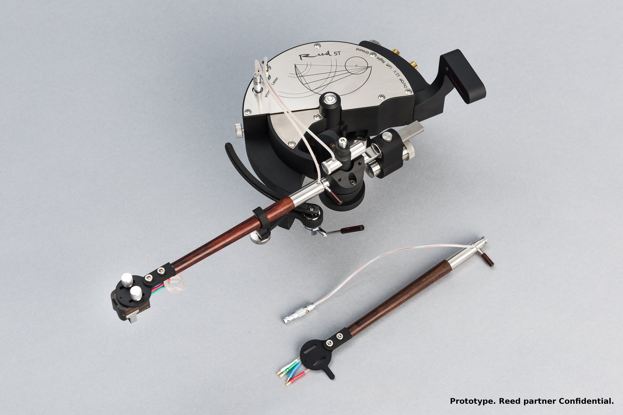

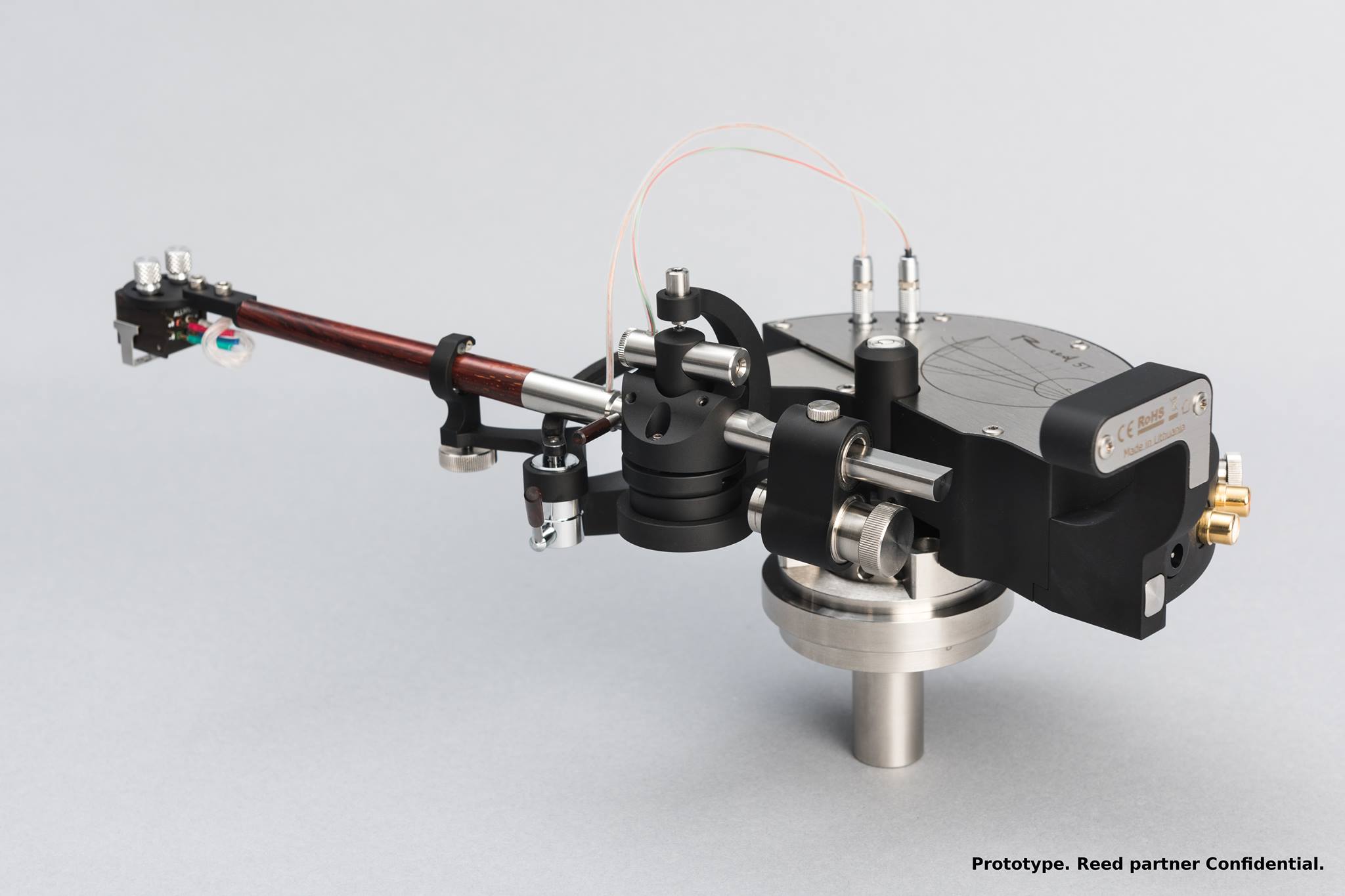

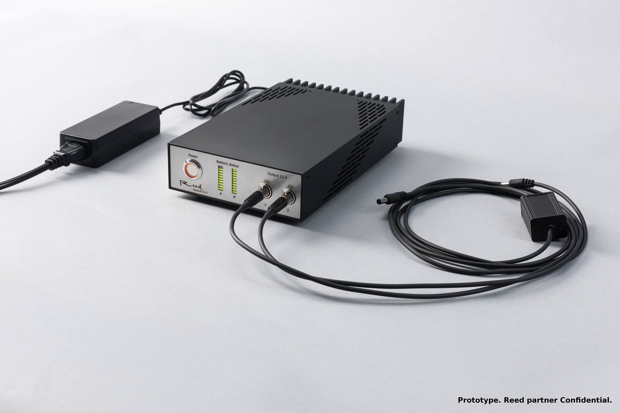

I saw someone posted these photos on Facebook. The latest arm 5T from Reed Audio.
Thanks Jim for alerting me to this creation!
It appears to me this is a motorized servo version of the Birch geometry. The original Birch was a passive tonearm, similar to the Schroeder LT but the Reed 5T is active using the laser above the pivot arm pointing back to the sensor and locus of the Thales geometry. Instead of the assembly travelling the record playing surface in a straight line of 4", the motorized part rotates only couple inches. Very clever. As the arm travels closer to the spindle the motorized part rotates towards the spindle as well which is virtually extending the length of the arm from the locus to the stylus tip.
A forum member, Esperado, from before had designed something like this decades ago but the sensor was placed at the spindle area. While this thread is mostly about the passive genre, I am glad someone is taking on a non-parallel tracking approach!
Ergonomically, it appears to be easy to use too, as the pivot arm is detachable for easy cartridge swap. I would prefer the base to be more compact so it's more compatible with turntables with smaller footprint. But for servo tonearm, I would happily take this over the over-engineered Derenville tonearm.
This type of project was suggested theoretically by me and others by making a motorized armpod or island for traditional pivot tonearms. Here, the Reed design team materialized it. Bravo!
