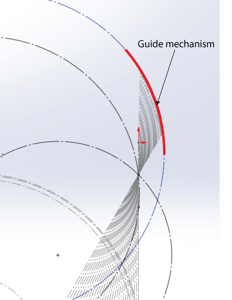

I send you what i was doing. If you enlarge the rear zone you may see that the circle seem to performe not better than the line.

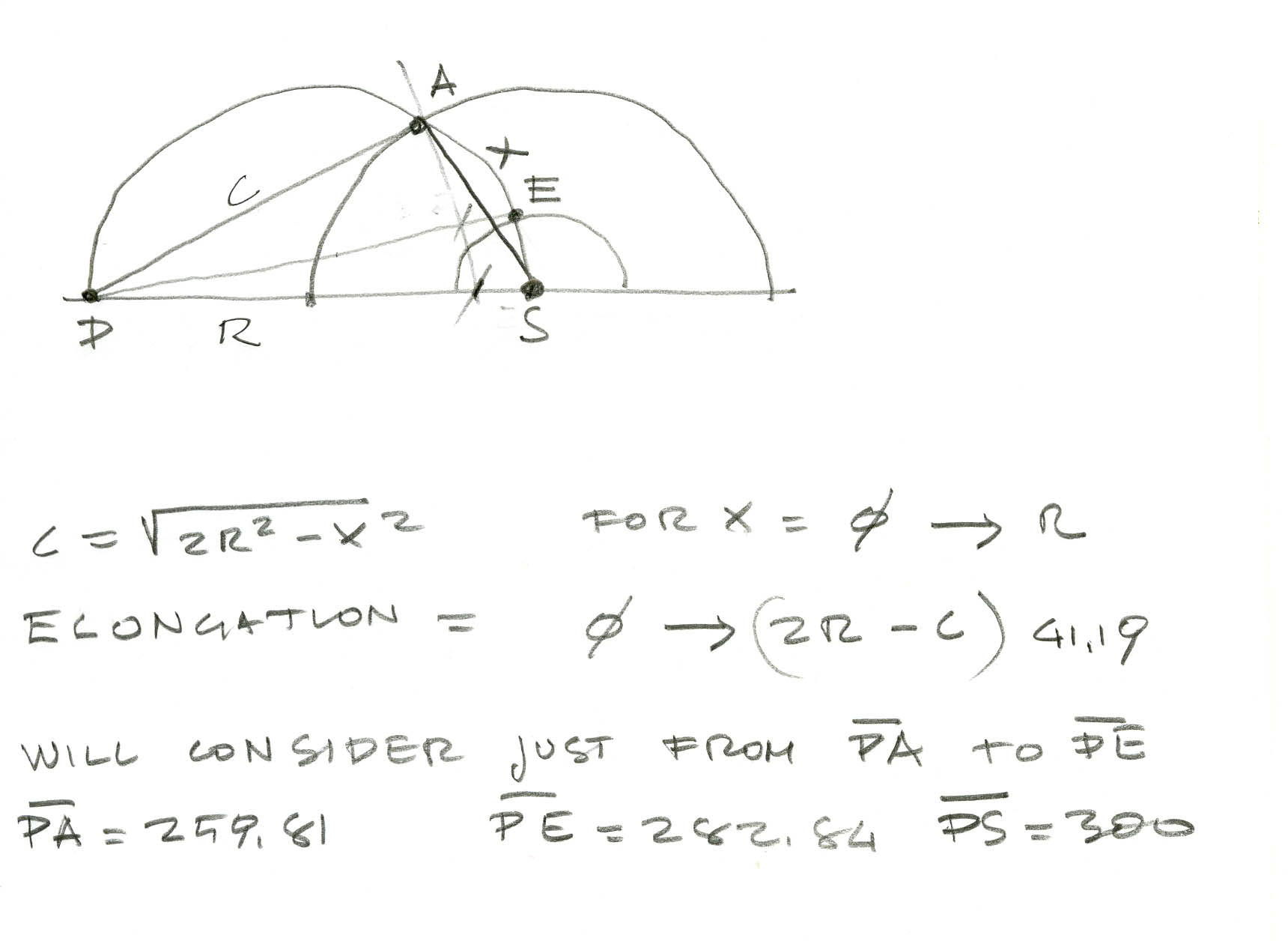

The red elongation segments are cut and pasted geometrically from the two circles by the program, so i think they are exact (unlike dimensions, that are rounded - you say so?). so the errors seen are real.
do you think that the string gadget can be simulated? maybe is better than i thought, a sort of pantograph reproducing the curve at the headshell level-

Yes I can simulate for you.
I would need maximum extended length and the minimum as well as the precise locations on your curve where that will happen. Assuming lead in & lead out. What are your thoughts on the easy of use of such a long mechanism on current plinths? Would this be a pod mounted solution?
Do not worry 2wice, thanks. I was just asking if it's feasible. For the build, my good old Kern compass (far more precise than me) and the slide rule may be enough.

In case anyone would like to draw this for themselves.
I’ve calculated the overhung/underhung and tangency errors of following the arc of the top circle compared to the calculated points on tangency curve.
In the top 2/3 of the curve the biggest error is -170µm underhung for 80µ° tangency error.
In the bottom 1/3 the biggest error is +180µm overhung for 130µ° tangency error. Any mechanical device will exceed these tolerances so I think following the arc is probably safe.

Hi 2wice,
Can I just check your figures. When you say a -130u° error do you mean -0.13° or -0.00013°. My quick check would indicate the former. The u=micro which would indicate the latter. 0.00013° is so close to zero as to be not worth mentioning and is definitely not audible. Even if it is 0.13° it is still very small and probably inaudible in itself.
Very nice work.
Niffy
Ignore me I've just spotted the angle in the bottom box. 89.87° = -0.13°. Still small enough to ignore. A slightly eccentric record will give as much lateral tracking error. And I can't hear it on those.

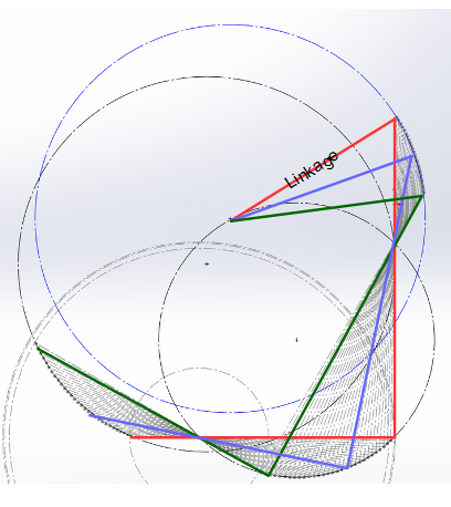

Hi all. Everyone seems to understand everything about 2wice smart analysis and sees many feasible solutions at hand. i'm instead rather confused.
Dd clarified that:
"Stylus to arm end is fixed length but stylus to pivot is NOT fixed length obviously. It's still going through the "elongation" process."
So it would seem like an extensible Thales, but how? I can imagine just two possible solutions
1 - the arm stretches, but the pivot does not move
2 - the arm does not stretch, but the pivot moves
(attachment)
1 - of this I can talk (still not in practice) because this is what my Syrinx tries to do.
Here the control point is the center of the blue circle. Geometrically it is perfect, but the direction is unfavorable (almost orthogonal) either to push (like in mine) or to pull (stylus drag control) without creating moments that hinder the linear extension of the arm. Not to mention alignments (skating).
2 - of this i can't, too little knowledge: i can only say that for me it's no more a Thales, maybe nearer to LT or tricycle
ciao carlo
You're making it more complicated than you think. They are the same thing. The stylus to the pivot point (P) distance is ALWAYS changing, hence the elongation. The stylus to the tail is a fixed distance. It's all about the relationship with the almighty P. How you make this sliding around is up to you. As long as the arm lines converge into a single point, you are always using the Thales geometry as a reference. 2wice's drawing is just a variation of the Birch method, except he's found an arc BEHIND the pivot point (P). Birch geometry is not 100% tangent at all times, only 3 points are perfectly tangent, with underhang and underhang just like a pivot arm, but the error is in microns! By having guiding geometry in arcs makes building easier because you can use pivot linkages or curved rails with less dramatic bend.
Your two drawings below are already full of arcs and possibilities. How you make the guiding mechanism is up to your inventiveness, which is tremendous.
