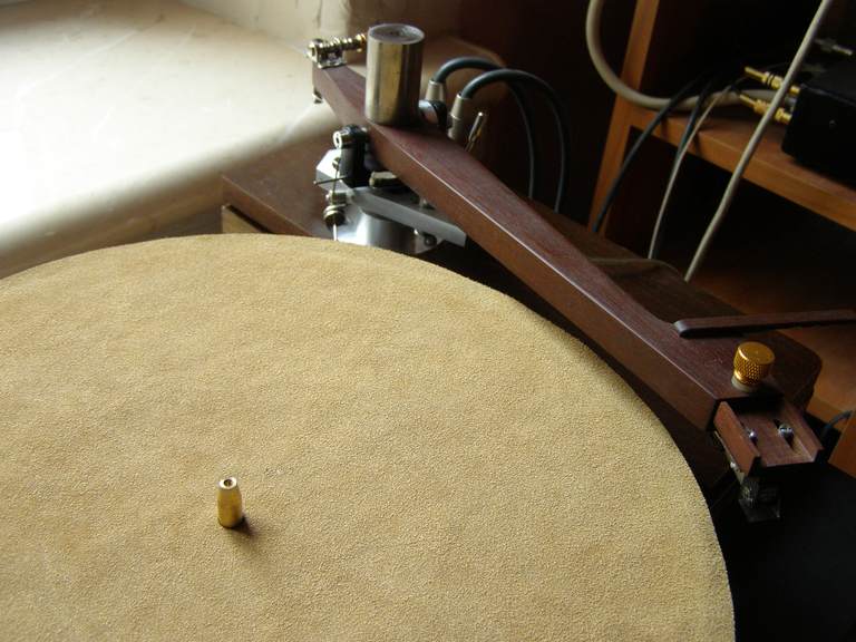

Very well, I'm going to try different weights placed the way so not to affect effective mass, and listen to it...🙂

Finally I understand (hoping to) that the horizontal pivot is fixed on plinth, while the arm (and its vertical pivot) travels on the linear guide: this reassures me a lot for my Syrinx, because it is just what it does too (but with a linear old timer bearing).
What I still do not understand is if it is moved only by the stylus drag, and how is guided: from rear (tangent circle center) or in front (Thales circle center)

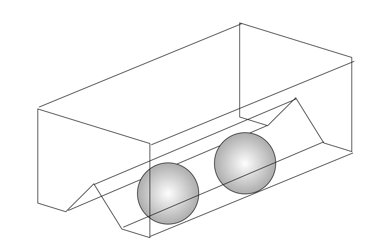

If magnets are to be avoided. I think this will work.
It would require two channels, with matching channels beneath, for stability. Three round rods all touching side by side would create two channels. Use two balls in one and one in the other. From my experiments I found that the hardness of all parts is paramount. For the lowest possible friction tungsten carbide rods and sapphire balls. You might find that you have to reposition the balls every now and again but this would be no real hardship. This setup would give excellent mechanical grounding so may well sound better than the magnetic levitation design.
Niffy

This is just mental exercise. 🙂 I am working around a design if two ball bearings, one linear and one on the arch groove can work or not. Will be more simple/stable and less linkages would be better I suppose.

I do like the rod and ball mechanism also, and it will enable a cheap check on the geometry.
633750d1504587783t-angling-90-tangential-pivot-tonearms-linear-bearing-jpg
It reminds me of this tonearm in another thread. I think this approach can be used in the carriage. Similar to Niffy's idea but using 4 rods side by side to make 3 channels and use 3 balls, 2 in front 1 in back (vice versa), and you have a low friction steady rolling platform for the vertical arm to sit in the middle of the triangle, preferably with 2 spikes on 2 dimples. One spike is cone shaped set screw to adjust azimuth. Low friction and mechanically grounded with no chatter. The optimum placement of the 3 balls takes some experimenting though.
