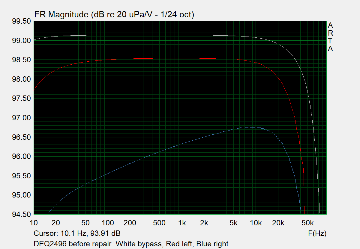

Now that I have a scope again I spent some time troubleshooting the I/O board and found the channel imbalance problem does indeed seem to be electrolytic coupling caps - specifically two of them in the right channel.
First I did some accurate gain comparisons between left and right channels and the relay bypass. As expected the relay bypass is a perfect gain match, so the figures below are relative to the relay bypass:
+12dBu mode
40hz
Left: -0.46dB
Right: -3.07dB
1Khz
Left: -0.36dB
Right: -2.06dB
10Khz
Left: -0.43dB
Right: -1.70dB
So yeah, 2.6dB down on the right channel at 40hz vs left, not good... 🙁
While there was a fraction of a dB difference in overall level in +22dBu mode the trends were all the same.
Next I wanted to find out how much of that loss was input stage vs output stage, so I used the width processor set to minimum width which effectively turns the signal path into mono mode.
I was then able to feed the test signal into only the left input and compare left and right outputs. (I also tried it feeding only into the right input - same result)
In this mode the channels matched each other within 0.05dB so that confirmed all the channel imbalance is on the input side and the output is perfectly OK. This tallies with the VU meters to be honest because the VU meters show an imbalance on the input signal as well.

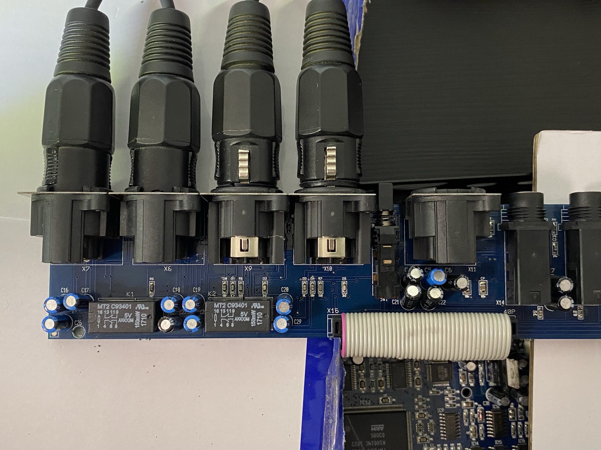

I started tracing the circuit from the input connectors referring to the DCX2496 schematic posted earlier in the thread unfortunately there are large differences in the input stage between my DEQ2496 and the circuit given earlier, for example it turns out both signal + and - from the XLR connector go directly to two 47uF coupling capacitors while none are shown in the circuit above...
And funnily enough the coupling capacitor on the positive input of the right channel is the main fault, with a loss of about 2dB across it at 40hz - when I bypass this with a 10uF polypropylene cap I have lying around the level goes up by about 1.8dB, so given this is 1/4 of the correct value of the original cap and it still makes this much difference the electrolytic must either be down to less than 1/10th of its correct value or have a really high ESR... either way it's stuffed.
There is a second 47uF next to it that is also faulty although the loss here is less - around 0.5dB, and bridging it with the 10uF cap still makes a significant difference. So also faulty.
On the picture below C19 is the one that is really bad and C18 is the not so bad but still faulty cap:
Bridging the 10uF across the same caps in the left channel (or indeed any other caps) makes zero difference, so it seems I only have two faulty caps. I will of course replace all of these 47uF caps, even the ones on the phone jack outputs I don't use...
The next question is what to replace them with - I've been swayed away from tantalum but I'm thinking that if I can find some that will physically fit I really ought to replace them with non-polar electrolytics ?
Of the 15 or so 47uF caps more than half of them, including both faulty ones, are operating with zero DC bias. This is obviously not ideal for a polarised electrolytic, especially one going to the input socket.
A few have 2.8v across them and a couple 14.88 across them. Are there any drawbacks to simply replacing all of the 47uF 25v (and the one 10uF) with non-polar electrolytics ?
These ones are 12mm tall by 5mm diameter but there is plenty more height available and they could probably fit 6mm diameter without too much trouble. I haven't yet looked to see what's available.
I'm also considering bypassing the ones being used for coupling with 0.1uF, but what would be good to use but is still small enough to fit under the board and be good for audio ? Polypropylene ?

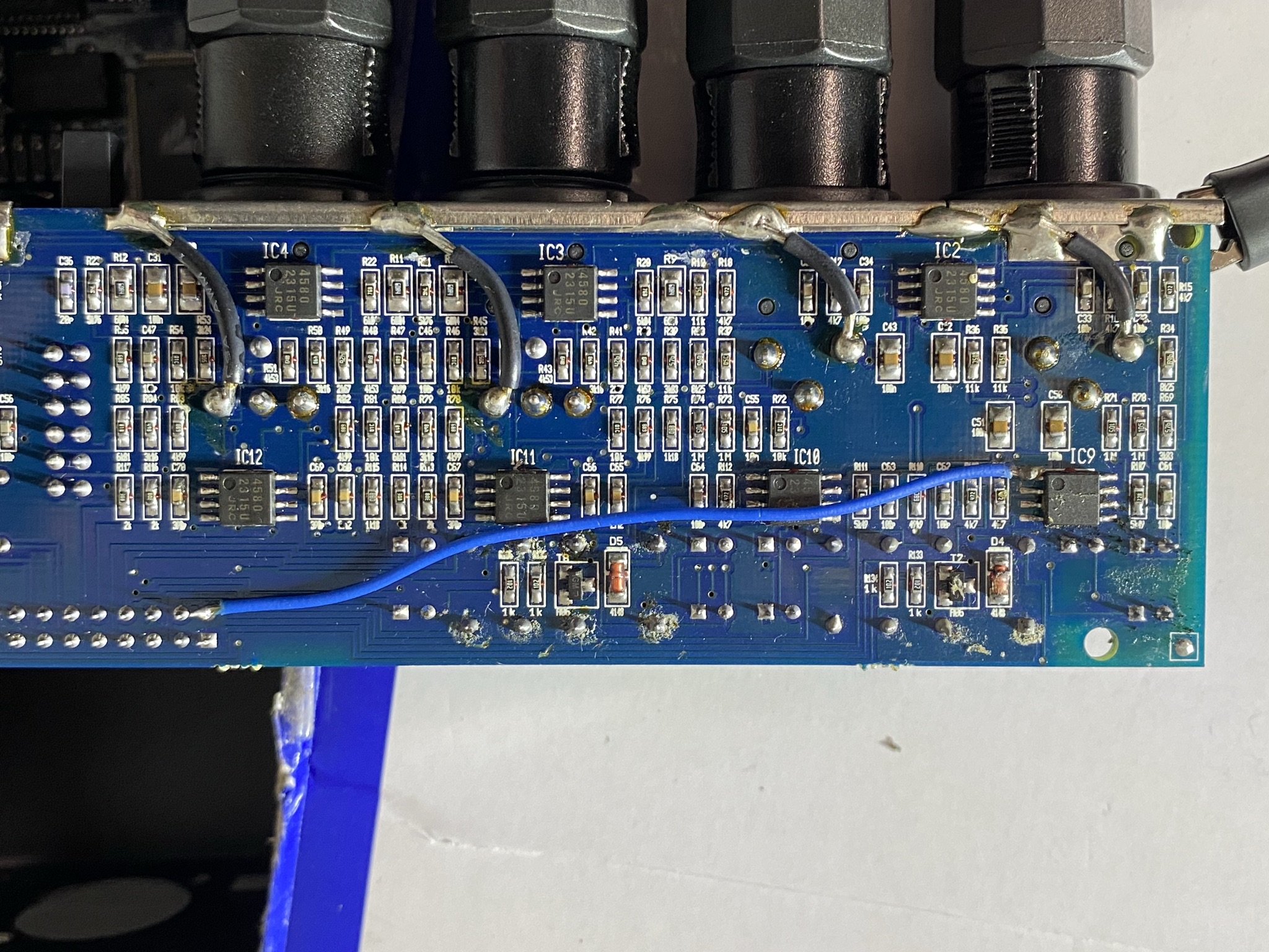

I've also noticed a bodge wire on my board - while I did replace the relays on mine and had some difficulty with the PCB I have no recollection of having to bypass a faulty trace - does anyone else's board have this blue wire ??
The foam pads on the bottom have completely rotted and gone hard and crumbly, so I've got a bit of board clean up to do and new foam spacers to fit before it goes back together...

While I identified two caps that were specifically relating to the right channel fault during my initial testing it turns out after measuring them all during removal that of the 16 47uF caps on that board 4 were completely open circuit 😱 so I'm not sure how it was even working, although some were in other functions like the RTA input which I haven't used in over a decade...
C19 which made the most difference to the right channel level was down from 47uF to just 0.2uF 😱 C18 was down to 10uF.
The values were all over the place at random - some just a few uF or completely dead, some nearly at their full value. I suspect the ones that were still relatively good were ones that have bias voltage although I didn't actually check that to confirm it. There were two different batches of capacitors fitted from the factory - one lot blue, one lot black.
I replaced them with good quality Panasonic types so hopefully they will last longer, and will probably see out the rest of the useful life of the device considering it's now 17 years old.

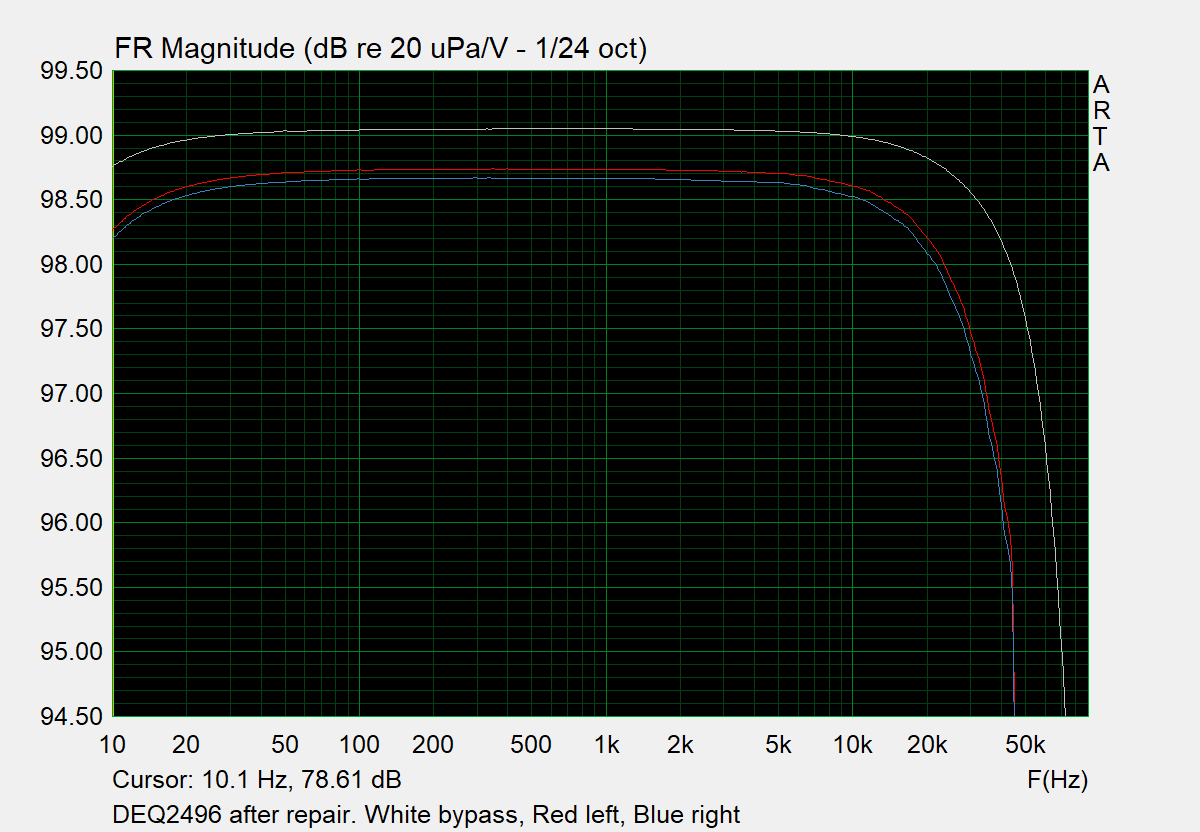

Here are the before and after measurements. Note that the vertical scale is blown up a lot to measure the differences accurately making the high frequency roll off appear worse than it really is.
Before:
The upwards slope on the right channel is really obvious, at 30Hz the difference is 3.3dB, at 10Khz it is about 1.8dB.
After:
Channel matching is near on perfect now with the two channels within 0.06dB up to a few Khz and about 0.1dB at 20Khz.
Also of note is that even the "good" left channel has increased in level about 0.3dB and has significantly less bass roll off, so lower capacitance values were still affecting the left channel somewhat.
Although I did order a bag of 0.1uF polyester film caps to bypass the electrolytics, in the end after looking at the measurements and doing some reactance calculations I opted not to install them.
So I'm very happy with this fix - at the age these are getting to I suggest people measure theirs as well because it's likely some of the zero bias coupling caps in the input/output circuits have dried out and are compromising the performance. I was shocked at how many had outright failed let alone dropped to extremely low values.
Before:
After:

So actually, viewed in three bands, the failure is more like plus and minus .2 dB within each of three bands. That would be astonishingly wonderful by the standards of many other audiophiles* before the cap replacement.
B.

Not sure where you're getting +/- 0.7dB from, the loss at low frequencies in the bad channel was well over 3dB as shown in my graphs.

Given that one of the main input coupling capacitors was found to be nearly dead and progressively failing over the last year or so, arguing against repairing it is kind of silly, it was a fault that needed repairing before it died completely, and the degree of attenuation/shift in frequency response has been getting worse over time. (I've noticed it getting worse which is why I've finally got around to doing something about it)But on the other hand, why go to all that bother when you can merely raise the low frequencies by less than a dB (which most of us couldn't possibly hear) and lower the upper frequencies by less than a dB (which most of us couldn't possibly hear).
It's not possible to compensate that slope correctly anyway even if it remained stable as the minimum step size for the graphic EQ and parametric EQ settings is 0.5dB, and there is no continuous slope function like a linear equaliser. The nearest is a 6dB/oct shelf function and it does a poor job trying to compensate a continuous slope - that is what I was previously using as a work around.
From reading a lot of your other responses to posts over time its clear that you're happy to accept a lot worse response errors that many other people are, and frequently wave it away with "well you won't hear it anyway", with no basis for that.
If you're happy with frequency response and gain imbalance between channels of that magnitude that's fine but I'm certainly not, and the error in both frequency response and channel balance that was there prior to the repair is plain as day, it was not subtle at all.
The DEQ2496 is back in service and all is well. There is a small channel imbalance on my amplifier itself of about 0.3dB so the total imbalance now is around 0.36dB down on the right with the two combined, so about 10x less than before and given all the other variables in an asymmetric room layout I can't hear any left/right imbalance subjectively anymore, where it was very obvious before with the fault.
I also notice there is subjectively a bit too much bass overall now - the right speaker was previously down quite a lot on bass due to this fault and had a rising frequency response that was making it sound thinner than it should have. Now that the right channel is working correctly the overall EQ settings for bass will need a slight tweak to compensate.
