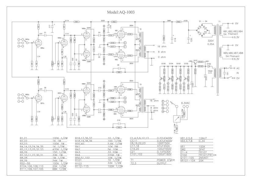

Are all the parts shown on that print the same for your unit except no on-board meter?
I'll have to check that. Yes the meter and it's associated parts are not there.
What is the grid#1 voltage on your unit? The print shows that is should be -37v.
I'll measure all voltages and post that.

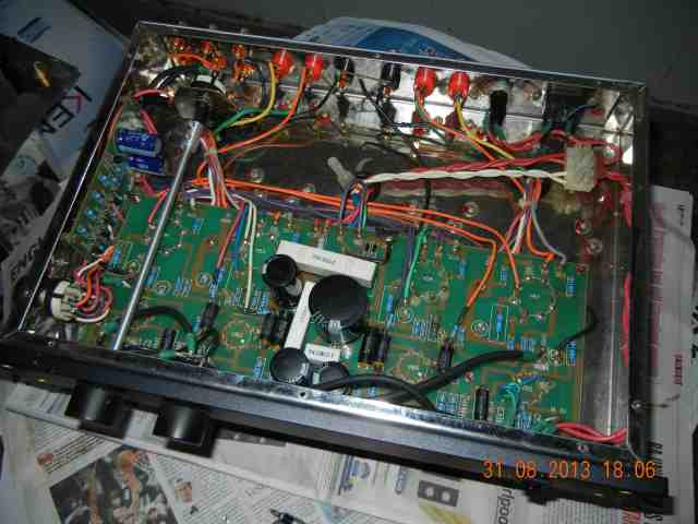

They appear to be inter-stage coupling caps (?). Maybe you can see that in the photograph. I'll try to trace the location . Maybe I should trace the full circuit and see if it matches the diagram given earlier in this thread. Not today but by the weekend.
As far as the WW-resistors being close to E-caps, I don't think it's a problem unless they get really hot.
That's right. I haven't checked how hot they get. Maybe I should. However it's been there a long time and so it may not be an issue.

There are 4 presets R104,106,108, 110 for bias adj, and also label A, B, C, D at transistors emitter. A -VB3, B-VB4, C-VB1, D-VB2. Measure the voltage at pin 5 and ground which is -37V then measure voltage on the 10 ohms cathode resistor R16, 17, 37, 39. label E, F, G, H until these reading are all the same while keeps the bias as close to -37V as possible. You can preset the bias voltage without the power tubes, to measure the cathode current you need the tube in. Use this clip is safer:

Maybe you send us some pictures of back side?
