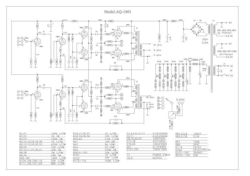

Are all the parts shown on that print the same for your unit except no on-board meter?
I'll have to check that. Yes the meter and it's associated parts are not there.
What is the grid#1 voltage on your unit? The print shows that is should be -37v.
I'll measure all voltages and post that.

What is the normal method of biasing measurement? I have a digital multimeter
And alligator clips/adapters. My amp came with Shuguang EL-34B tubes and I was hoping (if feasible) to use JJ KT-77’s.
Please advise how I should proceed.
Thanks,
baje55
https://www.diyaudio.com/forums/att...6171-antique-sound-lab-aq1003-asl-aq-1003-jpg
There are 4 presets R104,106,108, 110 for bias adj, and also label A, B, C, D at transistors emitter. A -VB3, B-VB4, C-VB1, D-VB2. Measure the voltage at pin 5 and ground which is -37V then measure voltage on the 10 ohms cathode resistor R16, 17, 37, 39. label E, F, G, H until these reading are all the same while keeps the bias as close to -37V as possible. You can preset the bias voltage without the power tubes, to measure the cathode current you need the tube in. Use this clip is safer:
https://shopee.com.my/SHNGki-Profes...Flexible-Testing-Probe-i.163592123.4617929590
Maybe you send us some pictures of back side?
AQ1003 biasing
I’m not an electronics expert. I am not competent enough to go inside the amp. Do I measure using MA or MV
