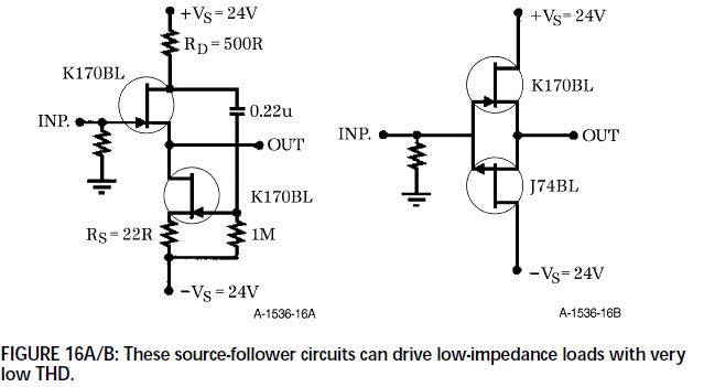

Good, as you do not use the output stage from the AD844. I suggest a simple JFet Buffer as an output though.
Borbely style, the one with only N-Channel Fet's is similar to Pass B1.
attachment.php
