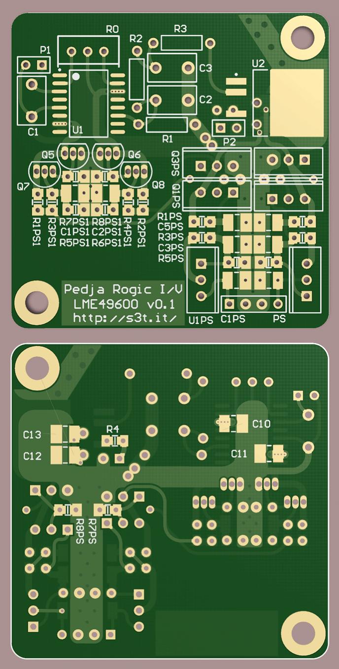

My take on Pedja's I/V + Nazar's regs.
I'm not that experienced of PCB layouts - could somebody check if my layout is OK?
It passes DRC, no analog/PSU traces overlapping...
The board is for single channel, 5x5cm (2x2") in size.

Thanks for trying to help but I don't see this has any bearing on this discussion to the discussion at all, Do you know what an opamp I/V input impedance vs rf curve is or its revalance to pre sigma-delta switcher "DAC's?
It's lower than the resistors that are needed in order to raise the voltage level enough to get some decent SNR.
