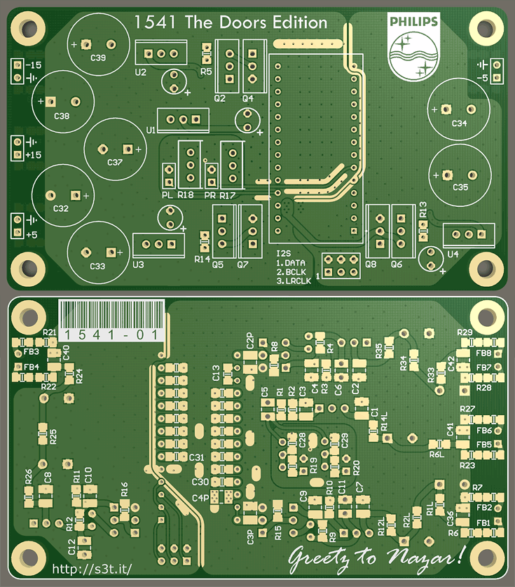

What about my grounds layout?
I didn't liked the capacitive/inductive coupling of DGND and AGND when they are on top of each other (2-layers), so i decided to move the DGND aside.
By doing this i halved the AGND impedance, got solid AGND layer
But i've got a half-circle loop between -5V and DGND pins with -5V PSU in between. The DAC chip is in center of EMI field produced by currents flowing from -5 to DGND and back given the "right hand rule" is true :).
My latest layout (not yet built) also has the ground plane for the digital section next to the analog ground plane on the same layer. The tda is on the edge of the Agnd plane (though completely on that plane), and the dgnd plane connects on the entire left side of the tda to the agnd plane. Both planes are almost not interrupted.
One of my previous layouts had dgnd and agnd connect at the agnd pin of the tda only... Worked quite well.

Damn i've gone thru 5 layouts, and still think i should scrap the current layout and redo it from EMC point of view /since i discovered EMC Information Centre - The EMC Journal (Free in the UK) .
"Balanced" PSU is BS, you need every cap stuck into low impedance ground to work, otherwise it will just pass the spike from V+ to "GND" without any filtering.
I2S wires should be done without DIP sockets to prevent EMC emissions due to impedance mismatch.
"I2S attenuator" should be done in 2 parts, with loading resistors near DAC and series resistors near DF.
Rethink the GND cutouts from "slot antenna" perspective.
And overall layout of connections/wires when the board goes into real-world application.
Ferrite beads and common mode chokes should be placed everywhere, at least on the points of I/O connections on the board, to prevent EMI emissions/fishing.
Every current should be returned to it's source, otherwise it will find it's way back thru air/other circuit paths affecting the performance of DAC surrounding.
Common ground for D and A sides of DAC is reasonable in many ways. Less EMC due to solid ground, the D and A parts of 1541 are probably capacitively coupled much better than our GND impedance. Therefore, the more impedance we add to GND pins, the less current the GND will catch, and more A to D interference will be there.
GND layers should expand to PCB edges, much futher than other wires, so GND could catch and return emitted EM fields.
Every EM transmitter is a receiver too, in same frequencies and same power, therefore, fighting EM emissions reward us with lower EM fishing too.
I know i'll end-up with solid single GND, and PSU layed-out on one side of the board :)

This one goes to production tomorrow, unless i'll find something to fix at mornin' coffee.
- Added some ferrite beads on power rails
- A bit of cutouts around PS ferrites to lower parasitic capacitance around 'em.
- Changed reg bypass caps to electrolytics, as LM317/337 have no love for low impedance on their outputs, but they want some caps to stay stable.
- Some graphics added.
- AGND/DGND could be stitched together with a bit of solder around plane edges.
- Pad for foil-screen grounding. You can glue a ribbon of foil around 1541, and solder it to the pad. Aaargh, DGND or AGND?! Okay, ive added the same "pad" on DGND side too. /not in pic/
- A tiny pad for I2S att resistors, pretty optional, as i had no place to mount them in a good way, and i didn't want to pass traces under resistor's belly due to parasitic capacitance. The resistors could be mounted on their side, between I2S pins and a spot on DGND.
Have fun.
However you realise that you have more suboptimal design features than I can cover in one post?
Have you actually read the the thread and those referenced within?
What you have will work about as well as what Philips and Marantz did in their 1980's CD-Players.
Ciao T

Thorsten,
Do you refer to lack of:
- DEM clocking,
- I2S attenuation
- I2S reclocking
- Shunt regs
I'm well aware of these. I2S things will be on digital board, shunt regs is a matter of choice, and DEM clocking - i'll try without it.
Or there are more suboptimal design features?

Thorsten,
- DEM clocking,
- I2S attenuation
- I2S reclocking
- Shunt regs
Non of the above.
If you do not use any proper re-clocking and no DEM re-clocking and no I2S attenuators or shunt regulators, this is a choice, though it is severely suboptimal in itself.
I am referring to the power supply arrangements (as there is little else on the board) where you reserve the worst regulator for the moist sensitive voltage and your valiant attempt to maximise jitter resulting from the interconnection between source (Digital Filter) and DAC Chip.
Really. And you REALLY think this is a good idea? Especially with a ribbon cable connection to the TDA1541 and the impedances involved?
Of course there many ways skinning digital cat's. I just see in your design about all the various ways in which to get thing wrong faithfully implemented and what may seem a deliberate rejection of all the good information available about how the TDA1541 works, about how digital connections with known impedance connections can be optimised, etc., et al.
Anyway, you have fun your way.
However, do me one favour. If you find the results of your efforts to be less than good at delivering the sound quality you expect, do not blame the TDA1541, but the designer.
Ciao T

Thorsten, thanks for constructive critics! That's what i'm looking for when i post some PCBs/etc.
I hate "i won't comment 'coz i don't want to be mean on poor silly DIYer for his work".
Rough, plain comments are welcome! :) As long as they are constructive...
I wrote severeal different posts but decided to delete em. They weren't constructive, and were theorized too much :) Hands-on is the best.
I'll make veroboard rig with current-sense resistors everywhere to investigate 1541 behaviour.
I know i won't get nice THD plots, but at least i'll know where the current flows, it's shape, and what affects it.
I'll make veroboard rig with current-sense resistors everywhere to investigate 1541 behaviour. I know i won't get nice THD plots, but at least i'll know where the current flows, it's shape, and what affects it.
