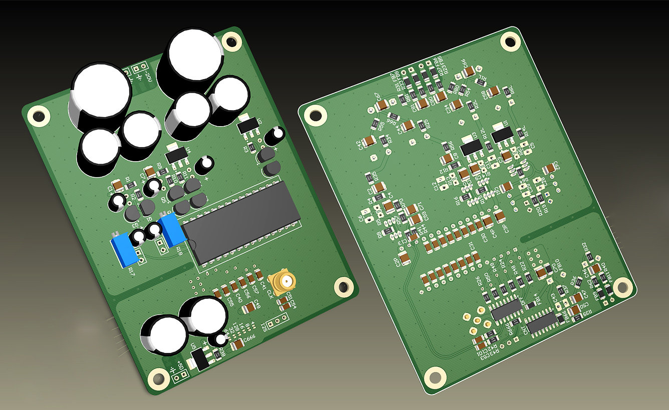

Rargh, not yet investigated anything.
But kinda preview of what i have...
And again, i decided to go with CPLD on digital end to get more control on clocking, I2S etc.
What i want to do is feed the TDA in simultaneous mode. I'll halve the clock rates - therefore less disturbances, and ability to go 8x oversampling.
In addition, going CPLD brings possibility to use dufferent DF ICs which aren't compatible with 1541 by default. There are many nice DFs around which were no-no for 1541 due to their high BCLK rates.
I want to implement advanced clocking scheme, which will give ability to
- Slave/Master operation of SPDIF receiver
- OS/NOS operation
- Support of Hi-Rez 88.2, 96, 172.4, 192kHz formats falling back to NOS with DF bypass.
Moreover, dual-differential mode with two TDAs becomes possible as CPLD could split/invert the i2s to L+,L-, R+,R- signals, and pack each channel pair to single I2S line (or even simultaneous way).
That will require 2's compliment to binary offset conversions etc. The VHDL thing is pretty neat and new for me, and i like it. Tiny power, tiny footprint, flexibility and "hardcoded" design. I've already coded i2s inverter with two 32-bit arrays (shiftregs in hardware).
In addition, to futher reduce digital noise on DAC board, the reclocker should work with 3.3v levels - we don't need the 5v swing anyways, and working with 3.3v both reduces voltage swing, and slows down slew rate.
And best of all, the clock driver could be 5v, but with series-paralel termination dividing the signal in half, and bringing down the logic levels to 3.3v CMOS-compatible, with no reflections on either ends of transmission line.
The problem is... I have one quad DFF on the DAC for reclocking, but need to reclock 5 signals (data_L, data_R, BCLK, LRCLK, DEM_CLK). Argh, a bit on the FAIL side. Is there any TinyLogic (or comparable) DFFs which both have slow slew rates and differential outputs? I hate going the octal DFF ICs without differential outputs just to have an possibility to go simultaneous mode...

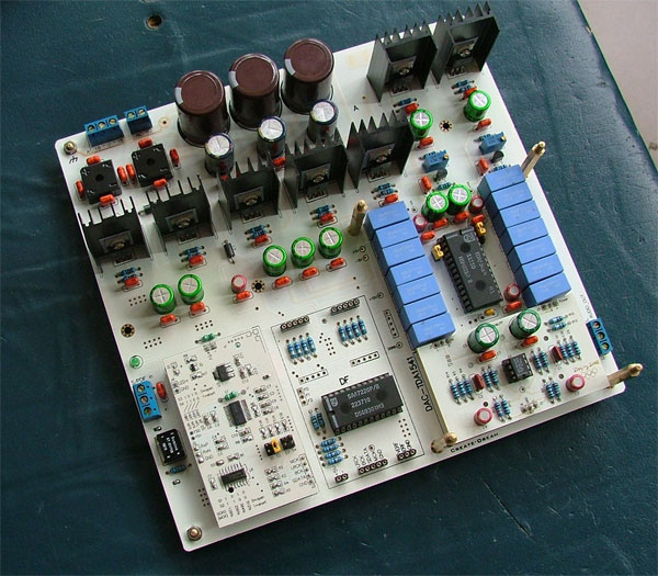

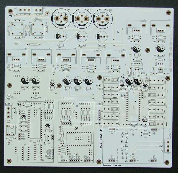

any experience/comment for this pcb? it looks very nice finishing
I used to own their TDA1540 board. The quality is good. They are finished boards. No assembly required. It worked straight away. I thought the sound was only good, but not great. I never bothered to modify or try to improve it.
I think the power supply is only a basic design, and the op amp output is not my cup of tea.
Nicely aligned components/blocks usually mean compromised performance. If the designer decided to go for a cool alingment instead of best performance... Then the board can't be good. Good electrical layout should look messy. It gets better with designer's experience, but never comes close to silly aligned components just like these seven yin yang caps aligned in a row - these could be placed closer to ICs. Much closer to supply pins. But then it wouldn't look so sweet and cool.
Some miss the meaning of "electronic design" thinking of word "design" as of visual art. It's not visual, it's electrical.
Fully agree there, looks like someone has been playing too much Tetris to me , haha.
But at least it has all of the stages seperate from each other on the PSU end, and relative physical seperation from each IC which lends itself to creative shielding using copper tape and walls made out of cardboard, I've seen other DAC Kits on ebay where the IC's were much closer to each other...
