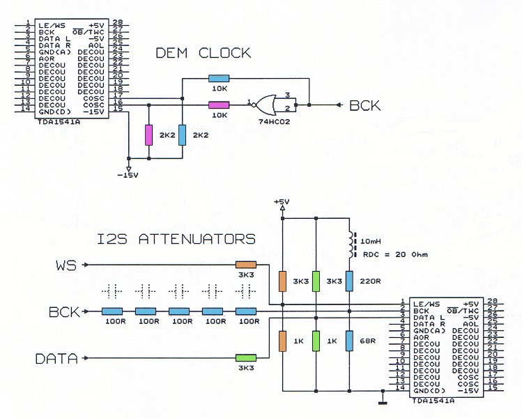

BCK divide by 8 for DEM reclock and also feed direct to 1541A??
I've here a nice PCB from Mr Rogic with just the TDA1541A section populated, and also one of the OEM M2Tech asynch USB boards. I've been using the two together with good results, and recently removed the isolator (I2S) which improved things further. So why stop now, I'd
like to try Thorstens recommendations listed below from the same thread, and I'm needing some clarification. Any advice is welcome
With 64Fs from the USB device - divide by 8 to have DEM reclocked at 8Fs, which is 352.8kHz at 44.1kHz, 705.6kHz at 88.2kHz.
Ok so far.
The four lines that get re-clocked are WS, DATA, BCK and inverted BCK. The two BCK lines goto DEM at 8Fs, ok.
And the sources Fs64 BCK divided /8 non-inverted signal now feeds the TDA1541A - which is just 352.8kHz at 44.1kHz sampling rate. Is that too low?
Is there any chance that 64Fs wasnt supposed to be divided, only inverted and then fed to the reclocker?. DEM reclock would then be 2.82MHz at 44.1kHz (supposed to work fine) but more to my attention is that BCK to 1541A would also 2.82Mhz - which seems quite normal.

One of the areas where we can really gain over generica is with DEM reclocking and I2S Attenuators. For this my recommendation would be to use the classic, simple passive I2S attenuators and direct resistive DEM reclocking John Brown (ecdesigns) kindly shared with the diya community.
For simplicity, use a 74HC4040 to divide BCK (which will be between 32 and 64Fs depending on your precise source) down for the DEM reclocker so you get between 4 and 8 Fs for the reclock, other frequencies do work, but can be tricky to get to work reliably, let's walk before we run.
Ok so far.
In front of the I2S attenuator place a reclocker.
So I would use a multi-flipflop reclocker instead, a 74HC175 is a quad, allowing us also to reclock the divided down BCK for the DEM reclocking. So the 74HC4040 is connected from the BCK in front of the re-clocker.
With the 74HC175 we have both inverted and non-inverted outputs, so we can drive the DEM reclocker directly, no extra inverters needed. As the I2S attenuator circuit will pose a load onto the reclocker IC (and through it on the supply) it is best to add the same components to the unused output, where they balance the load, so we do not see any PSU load change if the outputs change state.

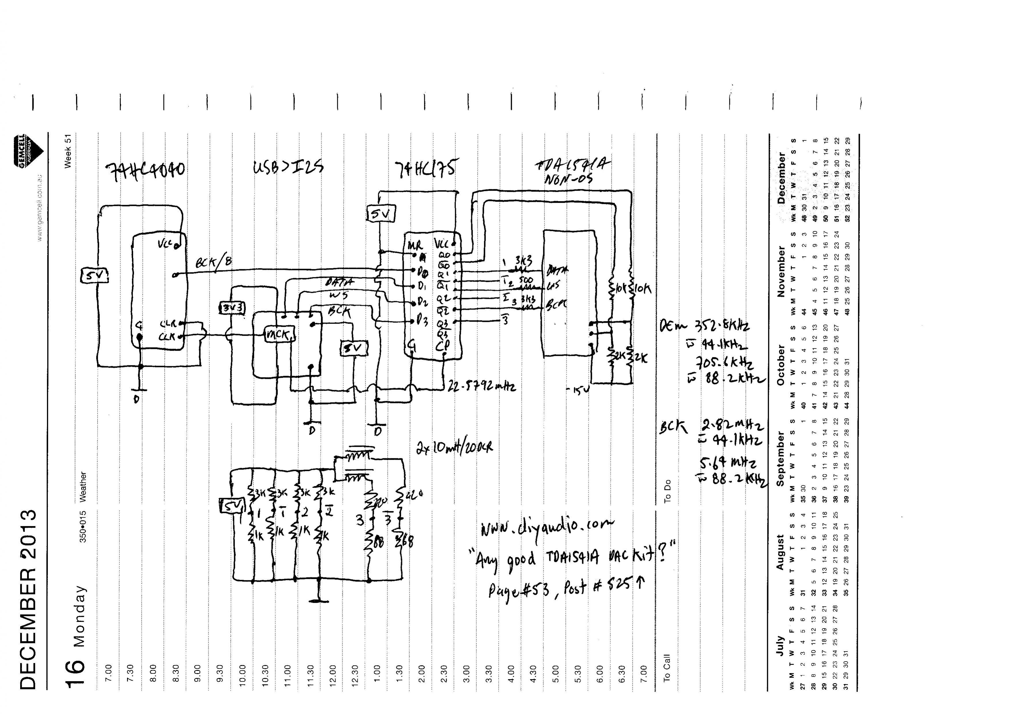

All of that makes good sense, and if a lower frequency for DEM is a better place to start, then 64Fs BCK divide by 8 is what I'll try first.
The only question I have, how to set 74HC4040 to divide by 8?.
Here is what I plan to try once I know how to set the divider up. Hopefully it resembles accurately everything that has been suggested.
As always, any comments are welcome.
**edit - 74HC4040 CLK is supposed to be BCK and not MCK from the USB > I2S device as drawn.
Shane

For the 74HC4040, Q1 is /2, Q2 is /4, Q3 is /8, etc.
Looking at your schematic, I treated the unused inverted outputs of the 74HC175 differently. Instead of sending the outputs to the voltage divider circuit as you have shown, I connected the outputs to inline resistors of the same value as the non-inverted outputs and then to digital ground. As I mentioned previously, this does not take into consideration for the TDA1541a circuitry impedances. I suppose measurements of the current in the inline resistors of the I2S lines could be done by measuring the voltage drop across a resistor in each line to determine the current and then adjust the resistors in the inverted outputs to match the corresponding non-inverted currents. It's a fine tuning thing I think, and I have not done that to my dac (I'm not even sure if what I suggested will work). So the current demand on the inverted outputs may be different than on the non-inverted outputs of the 74HC175 in my dac, but it's probably no worse than not loading the unused outputs at all, and hopefully better.

Using your idea to measure volt drop across the series R to get a value for load currents, if we then bias the unused outputs to the same voltage level (so 1.2V for 1/DATA, 1/WS and 1.2V for 1/BCK), a value of resistance to ground can be selected, which would have the unused outputs at the same voltage potential and with the same load currents as the used outputs.
Do you think there is any switching noise associated with these unused outputs that we dont want going to digital ground?. I note he has the inductor in the BCK voltage divider to stop something along these lines getting back into the 5V supply. It might be worth doing the same with the series resistor from 1/BCK to ground?
**(edit) 1.1V for 1/BCK
shane
Thanks again.
I really don't know if switching noise would be an issue or not. What is definitely important is paying attention to the return paths. What I have done on my dac is keep the paths from inverted outputs to ground of the chip as short and as direct as possible.
Thorsten and others have emphasized the importance of paying attention to supply loops and signal loops, to keep them small and to keep them from crossing or overlapping. His and other people's advice on locations of power supplies relative to signal paths, and placement of chips etc. to minimise sizes of supply loops and signal loops should be followed.
