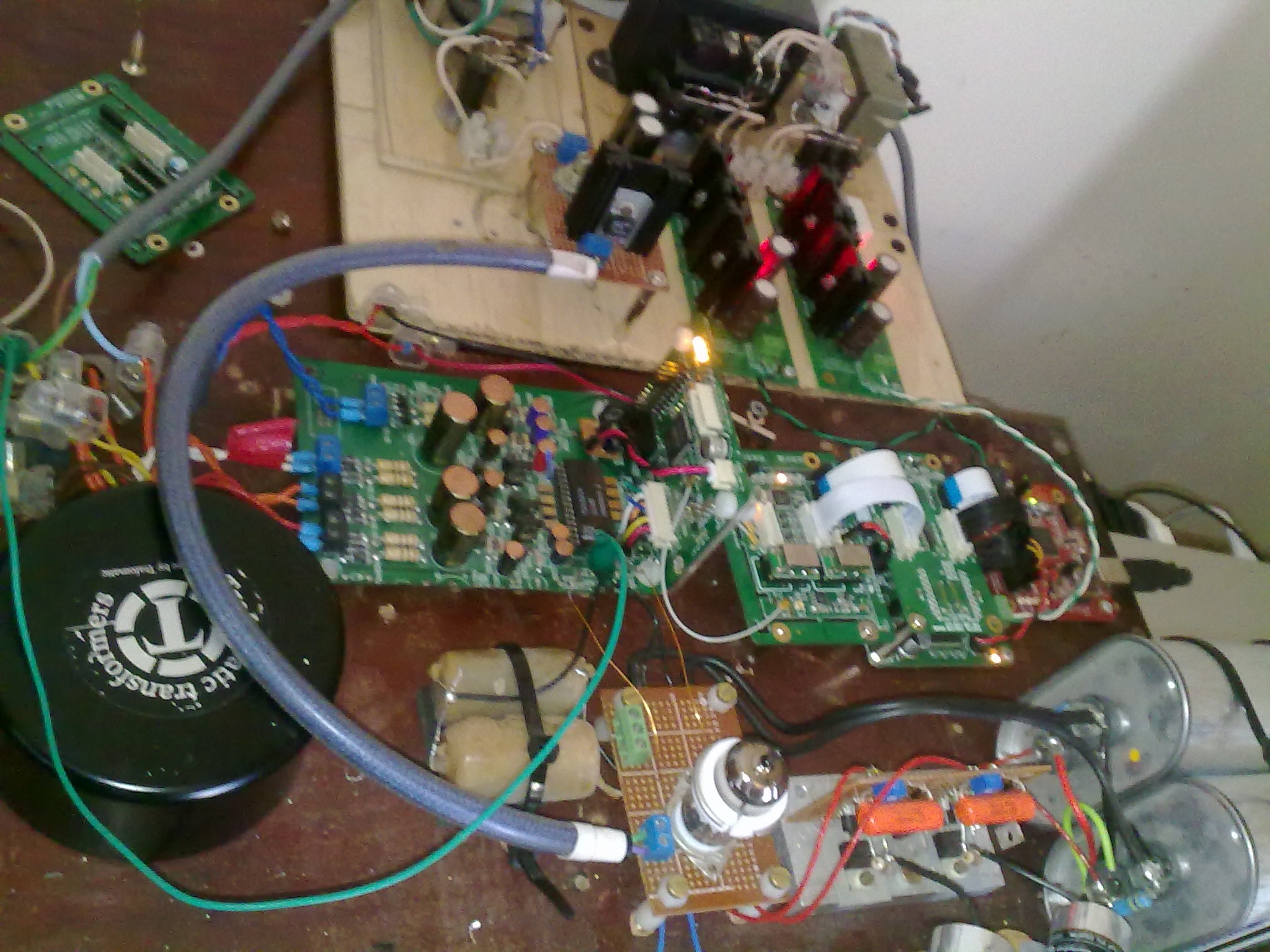

Hi Shane:
I know the diyhifisupply.com tube output kit; it is beautiful and is designed by Thorsten. I don't know about any offering by partsconnexion.com. Can you please write some details or post link?
Regards
Sure, no problem.
connex-76155.html
I can't comment on this design as I don't have one, and really don't know anything about it other than whats stated.
The minimal bias cct using the 1541A DC offset relies pretty much on the 1541A, and therefore not universal at all. It is for this reason that I suspect it will be different. Similar enough perhaps, but different. .. And the core board is about the simplest cct you could make.
Shane
Sure, no problem.
connex-76155.html

Hi Andrea:
I believe Thorsten's stage is simple and there might not a need for PCB. Please correct me if I am missing something.
If you are going forward then,
--one E88CC/6DJ8/6922, just because there are plenty of them
--No anode chokes on PCB. DIYer might want to experiment with different chokes.
--Regulated B+ on PCB
--Regulated DC heater supply
--No output capacitors on PCB. DIYer might want to experiment with different capacitors and they can be big.

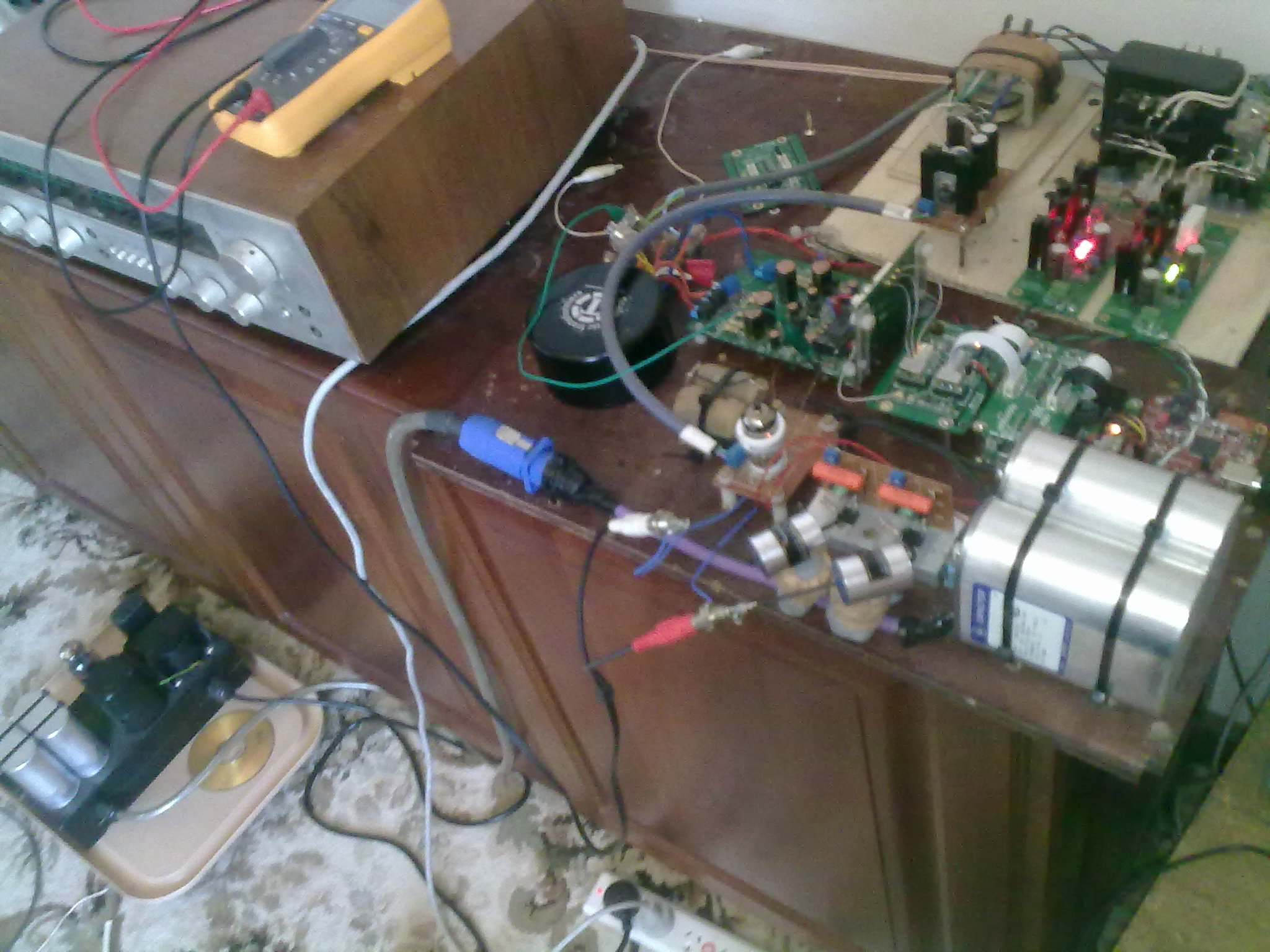

Hi Zsolt,
Its very satisfying at anything up to 192kHz. Might have something to do with my implementation, but 352/384 distorts.
Shane
