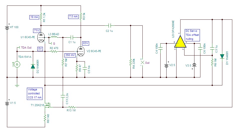

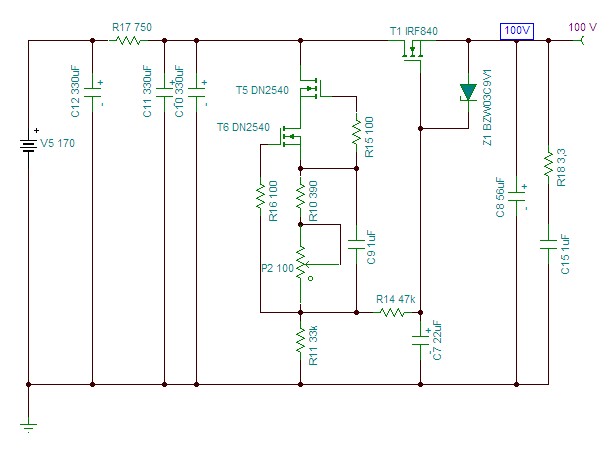

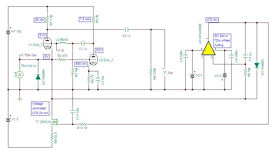

About the modified Broskie with the D3A, if someone had the time to experiment, this is a starting point (with a simple capacitor multiplier as the HT).

Shane,
keep in mind this circuit is a little different from the original Broskie's, that uses a classic DC servo and V1 is set with negative grid.
In this case there is a voltage controlled CCS to set the bias point of V1 and to null the offset at the output of the DAC (DC servo).
So the grid of the first tube is set to 0V, and swings from -100 mV to +100 mV when the signal is applied (the grid goes positive).
NFB is the basic of the Broskie I to V, but I'm not much worry about that, because there is almost no phase shift in the feedback loop.
As I said, I have no time at now to experiment, so I simulated the circuit:
- input and output signals are in the plot I posted
- simulated THD is less than 0.01%
One can use almost any kind of triode, with this simple rule:
the higher the gain of the tube, the lower the input impedance,
with obvious benefits for the DAC
Keep in mind the grid of V1 will go positive, so the chosen tube has to be linear in this region (the Queen is a good choice)

Andrea, could you explain to a layman the I/V process in your schema? Current variations turns to voltage variations over the voltage controlled CSS?

Sometimes the current flowing through the grid cause nonlinearity, that's the reason there are some tubes designed specifically to do the job keeping the linearity when the grid go positive.
You can find a good explanation about the I to V circuit in the Broskie's article.
The only difference in the schematic I posted is that I use different DC servo, an operational amplifier drives a voltage controlled CCS, to set the DAC output at 0V.
The DAC loves to see 0V at its output (keep in mind the 1541A swings current from 0 to -4 mA), so we need to null the current flowing through the anodic circuit subtracting 2 mA (half the current swing of the DAC).
In the last schematic I posted, the bias current of V1 is around 19 mA, so to do this job we can use a CCS that provides 17 mA (19-2 mA).
The operational amplifier compares the voltage at the DAC output with the reference (0V), and drives the CCS causing a proportional current variation to keep the TDA output anchored to 0V. When the tubes are cold the bias current is low, so the DC servo reduces the current provided from the CCS.
The two diodes (D1 and D2) prevents high variations to avoid overvoltage at the DAC output.
