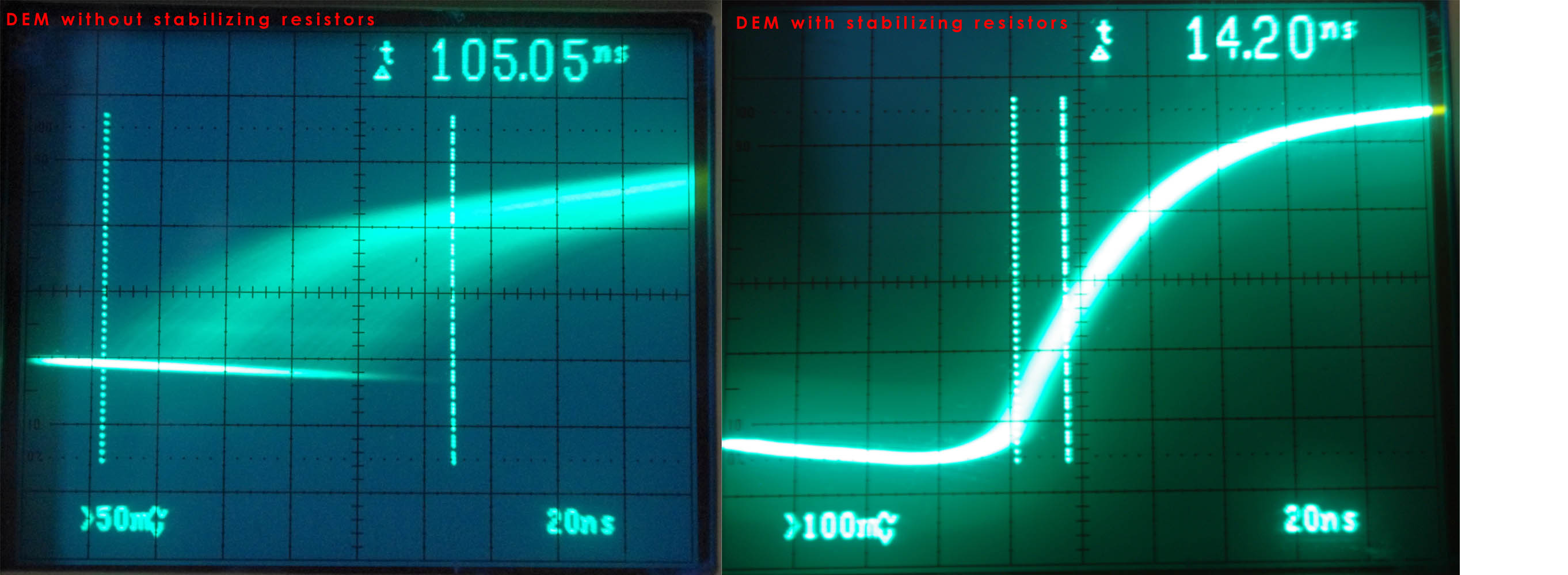

Nowadays avoided by ECDESIGN himself for jitters issues...
Just use the two 6k8 resistor allowed on the Disctinction-1541 pcb... on s'est pris la nénéte pour ça ! (we choose the best trade offs to avoid those bad temptations...).
For checking by yourself it's better to beginn without the two résistors and try after to choose what you prefer !
